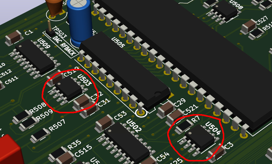

                        I'm having issues figuring out what the SO8 IC is in line with the DAC and nearest pin 20 of the MCU. I think it's U504. Seems to be a balanced opamp but nothing I can find looks right in the circuit.
                        Also the SO8 near pins 3 & 4, I think that one's U503. I suspect it's a TLC277C but I'm unsure: Click image for larger version

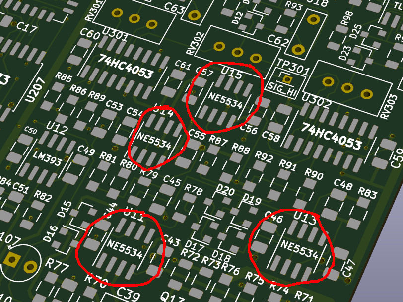

                        And on the power/clock/pulse board, I'm unsure what the RX preamps/amps (4 SO8's after the LM394) are exactly - I've assumed NE5534's for the time being as they pin out correctly: Click image for larger version

                        I've got pretty much every other major component figured out (I think/hope!), leaving a handful of passive components to double check. I've now also cloned the external PSU controller and whipped up a PCB front panel design to accommodate the L3 mods. Looking forward to all my mistakes being manifested in magic smoke....
                          I'm not Zed, but I'll give you a few clues..
                          U504 is an LT1011, used as part of it's adc setup.
                          U503 I have as 277, however 272 could be more likely. I'll keep an eye out and confirm that one. Worst case, it can always be decapped!
                          And from the pulse board, yes they are 5534.
                            Hi Mick!
                            Yes, This is what I've currently got for that part - though it just doesn't seem right as according to the datasheet, pin 7 is the output and pin1 is GND - however on the board, pin 7(output) is connected to the +5v rail (via pin 8 ), and pin 1(gnd) is connected to MCU[16].
                            ...Does this seem right to you? I've never come across an comparator or opamp output directly connected to +5v before...?
                              Ahhh, try lt1011 instead.
                              Bit of a dyslexic typo! I need to fix that up in the source.... Thanks for finding that one!
                                Hrm, maybe I'm missing something...?
                                Here's the datasheet for the lt1011 - https://www.analog.com/media/en/tech...ets/lt1011.pdf
                                On the board, Pins 7 & 8 are connected - according to the datasheet, this is the output (pin 7) and V+ (pin 8 ), both connected to +5v. It just doesn't seem to fit in the circuit...
                                On the datasheet however, it states "Pin compatible with the LM111" - So I checked out the LM111/LM211/LM311 datasheet - https://www.ti.com/lit/ds/symlink/lm311.pdf.
                                The LM111/211/311 seem to fit much better in this circuit, with pin 1 being "EMIT OUT" connected to MCU[16], Pin 7 being "COL OUT" connected to +5v, and pin 8 being VCC+, also connected to +5v.
                                I'm not sure how they could be "pin compatible" with such different designations. Again, maybe I'm missing something...?
                                Anyway, I'm now starting to think it's a LMx11... What are your thoughts, Mick?
