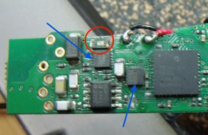

    It looks like there's a fuse on the board, which you definetly should check (the green component which I marked with a red circle in the attached picture).
    May I ask whether you can do some good close up shots from the top and bottom, I'm really interested in the markings on the chips, especially those I marked with blue arrows Maybe you could tell me what's written on them if you can read it.

      i will do closup of all the chips and i was also interesed in listing all the chips. Is the firmware is stored on the PIC24F ? I will check if there is an eeprom

        Yes the firmware is stored on the PIC24FJ64. The PCB in the coil does all the low level processing and sends minimal data to the remote control, almost all the magic happens in the coil.
        There's one very interesting thing that could be done if you get the PCB working again, the firmware is uploaded to the coil via the remote control i.e PC --[USB]--> Remote Control --[RF link]--> Coil
        The RF chip on the coil is the one marked "nRF24L01", if you attach a logic analyzer to the serial output which goes to the PIC24FJ64' you could intercept the coil's firmware which then could be used to flash a new chip, i.e we could create our own coils for DEUS.

                I would say the green 'fuse' is actually a polyfuse, so self-resetting, and unlikely to be a problem.

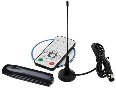

                  Another method would be to use a DVB-T dongle as SDR with a downconverter, then you get everything: http://blog.cyberexplorer.me/2014/01...24l01-and.html
                  In case of Deus, I'd just attach a logic analyzer to the NRF serial in/output and see what's transmitted

                      You can listen also to radio from 50 MHz to 2,4 GHz with the free SDRSharp software by some USB DVB-T dongle
                      (also when it just supports the old DVB-T 1 standard) but it should have a chipset with broad range - like the E4000.
                      And you might need some external antenna on the roof plus amp because those chips are not the most sensitive.

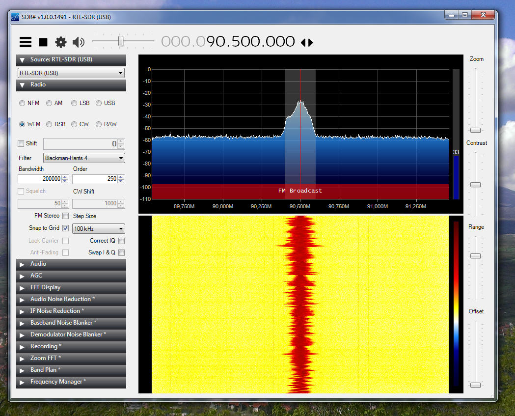

                        Coincidently a friend already had old dongle; Astrometa DVB-T2. Left and forgotten in a drawer somewhere.
                        So i took it today to give it a try.
                        Original driver&software which came with it; turns it in a completely useless piece of crap, believe me on this!
                        Software is awful and awfully slow! Scanning is impossible slow too!
                        You can't do anything about that, because it totally lacks on settings and adjustments. Total crap.
                        Also pretty deaf! Can't catch not even a local FM station.
                        So at first i was pretty disappointed.
                        But than i stumbled randomly on this: http://www.rtl-sdr.com/rtl-sdr-quick-start-guide/
                        So i gave it a try too.
                        Wow! SDR_Sharp with custom driver is turning it in a complete different pieces of hardware! Almost not to believe it!
                        Now is working like a hell! Scanning is ultra fast! Sensitivity excellent!
                        Adjustable RF gain!
                        It is catching much signals now, acting just nice!
                        It turns out that this is a very nice and useful piece of hardware if used with proper software.
                        Now it makes a lot of sense to me to obtain downconverter.
