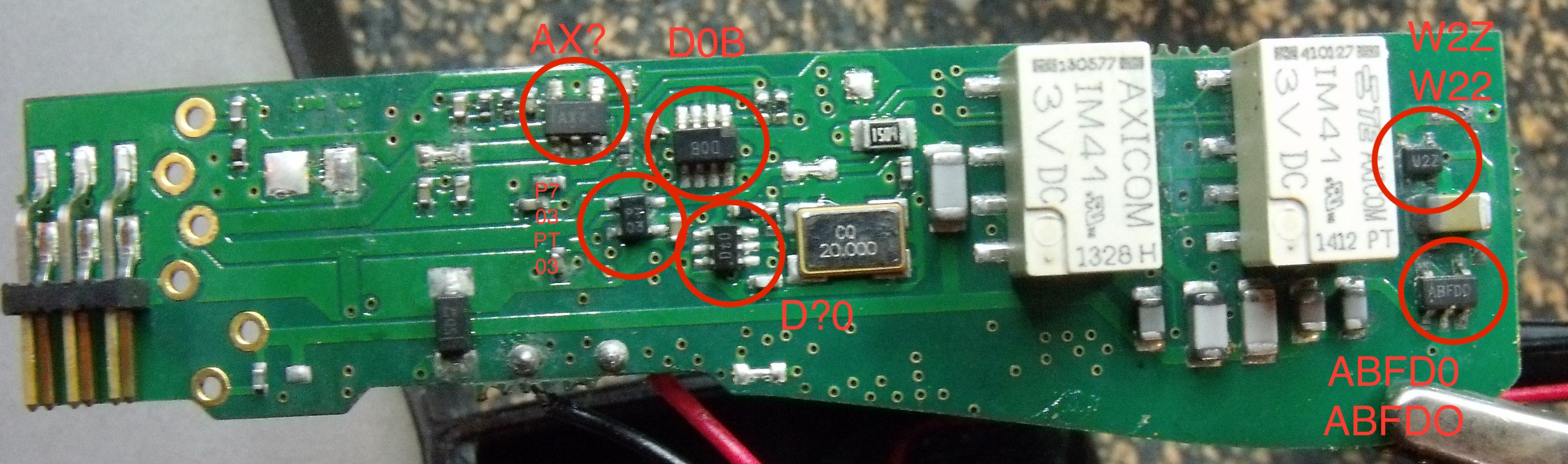

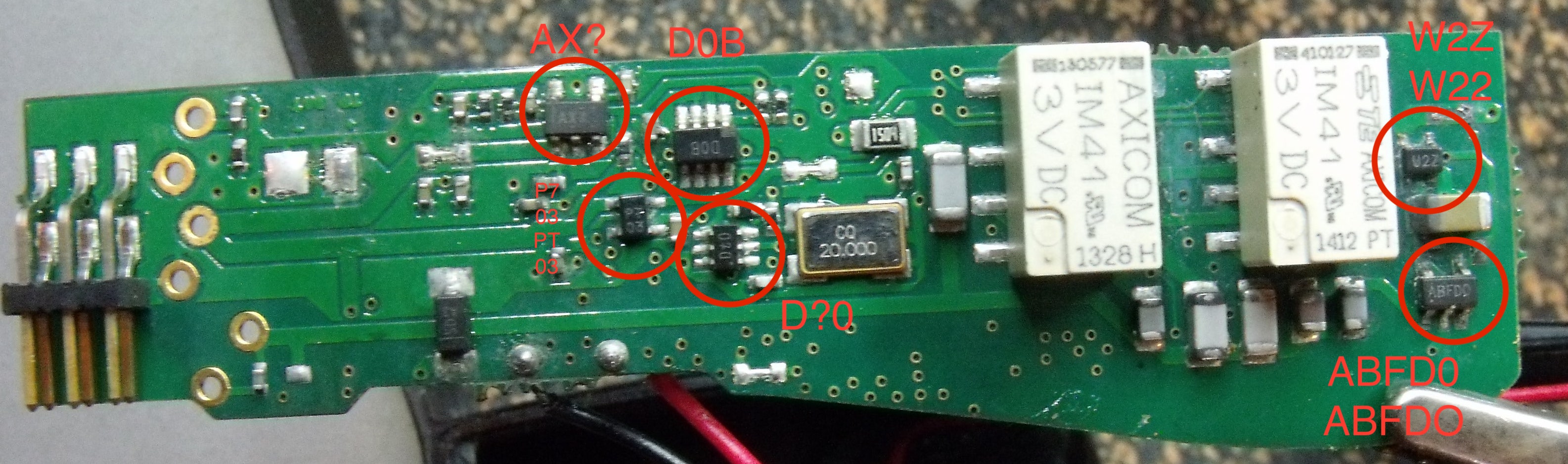

      I think I was able to identify another IC: D0B = AD5160 = 256-Position SPI-Compatible Digital Potentiometer (Datasheet)
      Marked the other ICs with what I was able to decipher...
        FCC-ID info about both Deus and Pinpointer MI-6: https://fccid.io/XFJ (scroll down to "FCC ID applications by XFJ (XPLORER)" section and then follow the links)
          Battery IC identified, it's Semtech Miniature High Current Lithium-Ion Battery Charger SC806 (Datasheet) same is used in the Headphones.
            I think I identified another one, the "D?0" is actually "Dt0" and is a NXP "PEMD10; PUMD10NPN/PNP resistor-equipped transistors;R1 = 2.2 kOhm, R2 = 47 kOhm" (Datasheet). The "t" is the manufacturing plant in Malaysia from NXP.

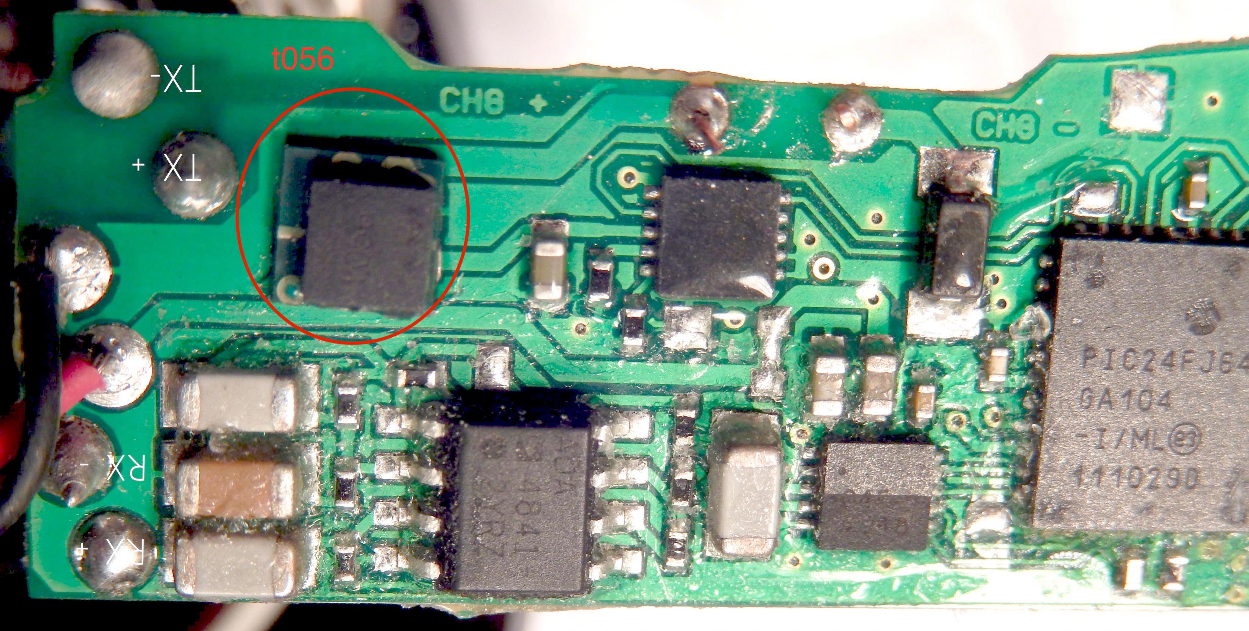

              In this picture here Click image for larger version
ID:	351032 I identified Littlefuse Zener Diode ZEN056V230A16LS (Datasheet)
                What I'm missing is, where is the DAC or power amplifer / mosfets to drive TX?
                  I suspect you're over-thinking the DAC / power mosfet part of the circuitry. The power levels used are very low; in Henrik's small-coil thread we reverse-engineered it enough to see there was no fancy tricks to get more 'power' to the coil, despite just using a single Lithium cell. No tapped TX coil, no bridge drive, no double-tuned circuit. So it's almost certainly just one standard transistor in a SOT-23, driven with a square-wave from the PIC micro. It may even be possible the PIC could directly drive the coil, perhaps with two pins/ports paralleled together.
                  As we found out how easy Henrik's coil was to copy, we didn't bother over-analysing the drive circuitry, to see how the relays affected the tuning. I analysed the front-end amp, with a view to altering gains, but Henrik left it unchanged, it airtested OK as it was.
                    I found the LDO! The AX? part is actually AXX and is Texas Instrument TPS799 (Datasheet) only 2 ICs left!!
