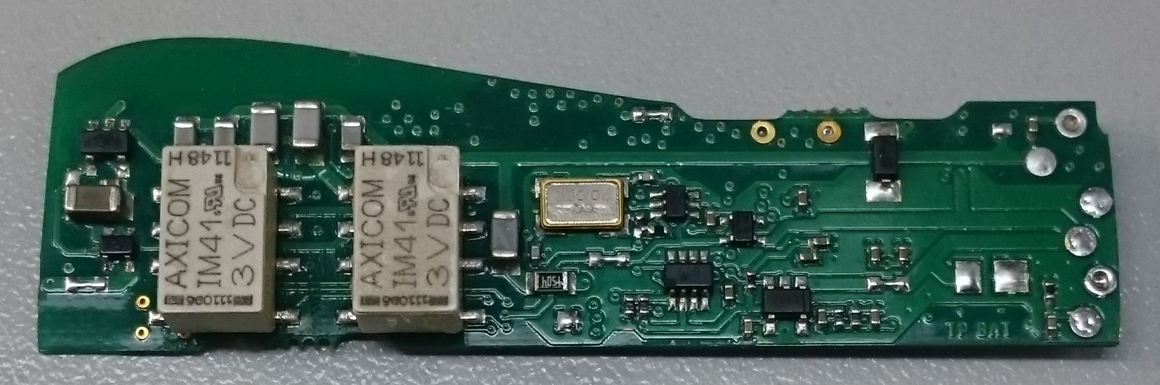

    @ivconic the firmware is encrypted when downloaded from XP, there are separate firmware files for the coils, headsets, remote control. There might be a chance that the fimware is transmitted to the coil unencrypted. However I'm most interested to know what ADC is used, given the ADA4841 Pre-amp and the"C4E" marking (not sure about the last letter) on the Chip I guess it could be the AD7691 http://www.analog.com/media/en/techn...ets/AD7691.pdf, but it's a differential ADC which is strange?
    Last thing, the NRF24L01 can be used in promiscuous mode, sort of, see here http://yveaux.blogspot.ch/2014/07/nr...er-part-1.html
    AD7691 is having 10 pins.
    According to posted photos it is very hard to tell how many pins exactly that small ic is having; 10 or 12?
    I looked at posted photos pretty carefully and can't tell for sure about number of pins.
    Would be really good to be sure about exact ADC model used there.
      I think it has 10 pins, you can see it on Skippy's pictures (see attachment). Still not sure about the exact ADC, however I'm pretty sure it must be one from Analog Devices, often the Pre-Amp and ADC are from the same manufacturer.

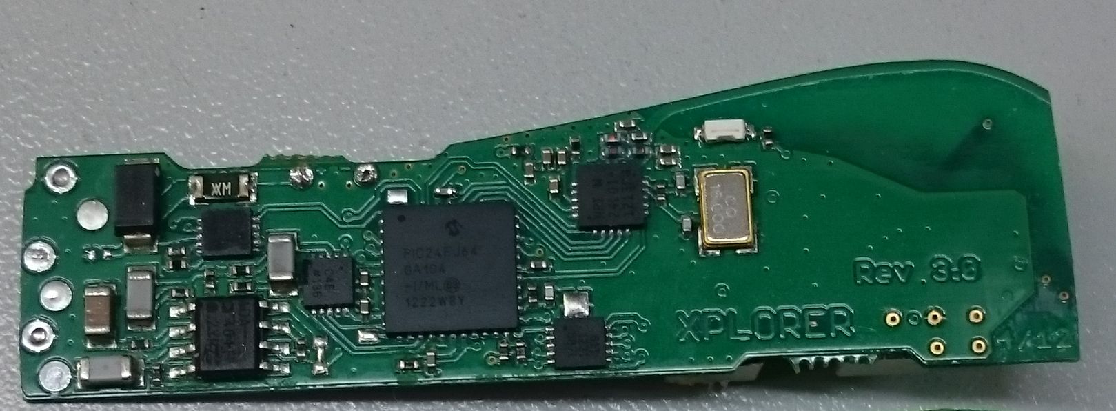

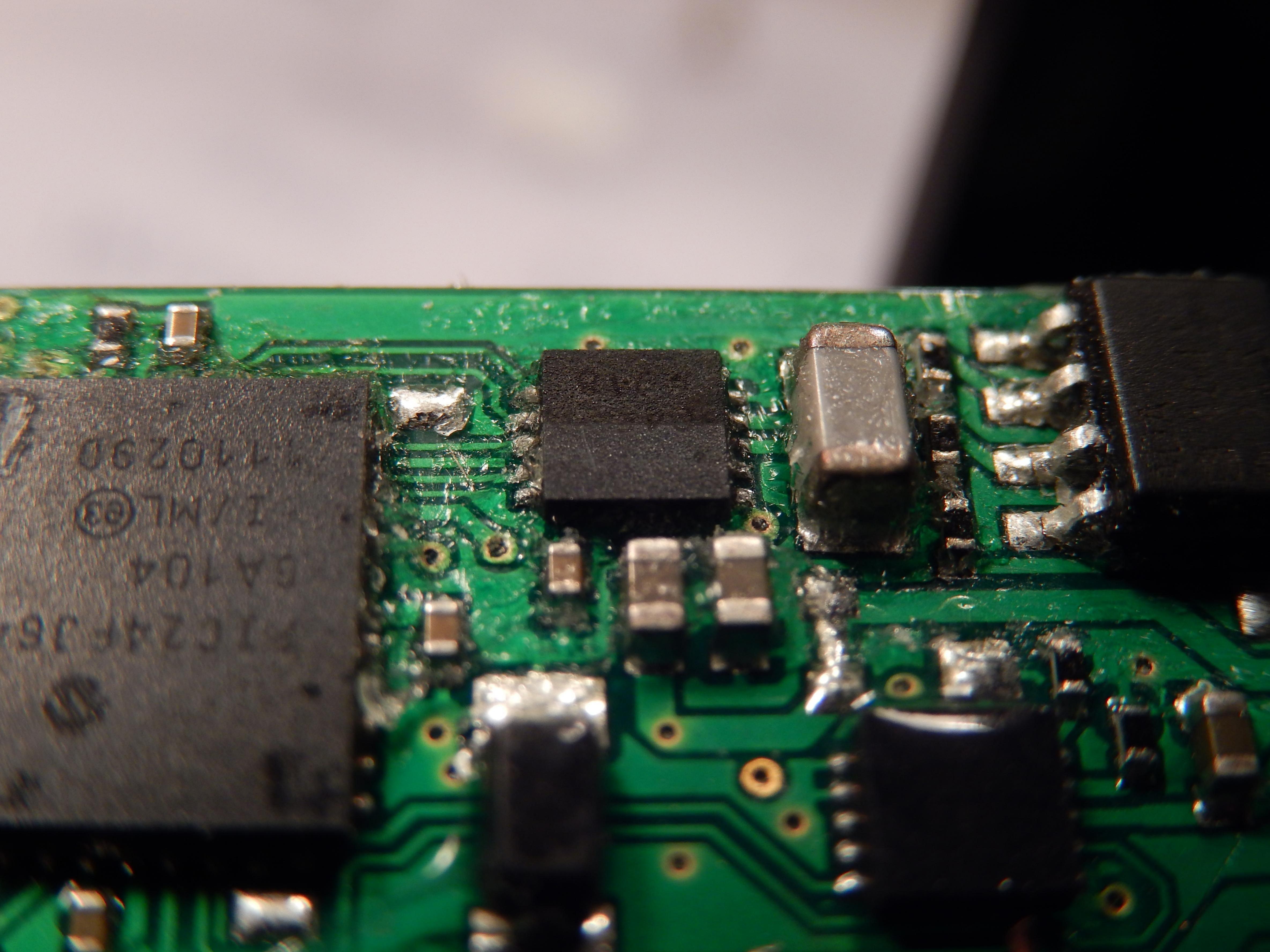

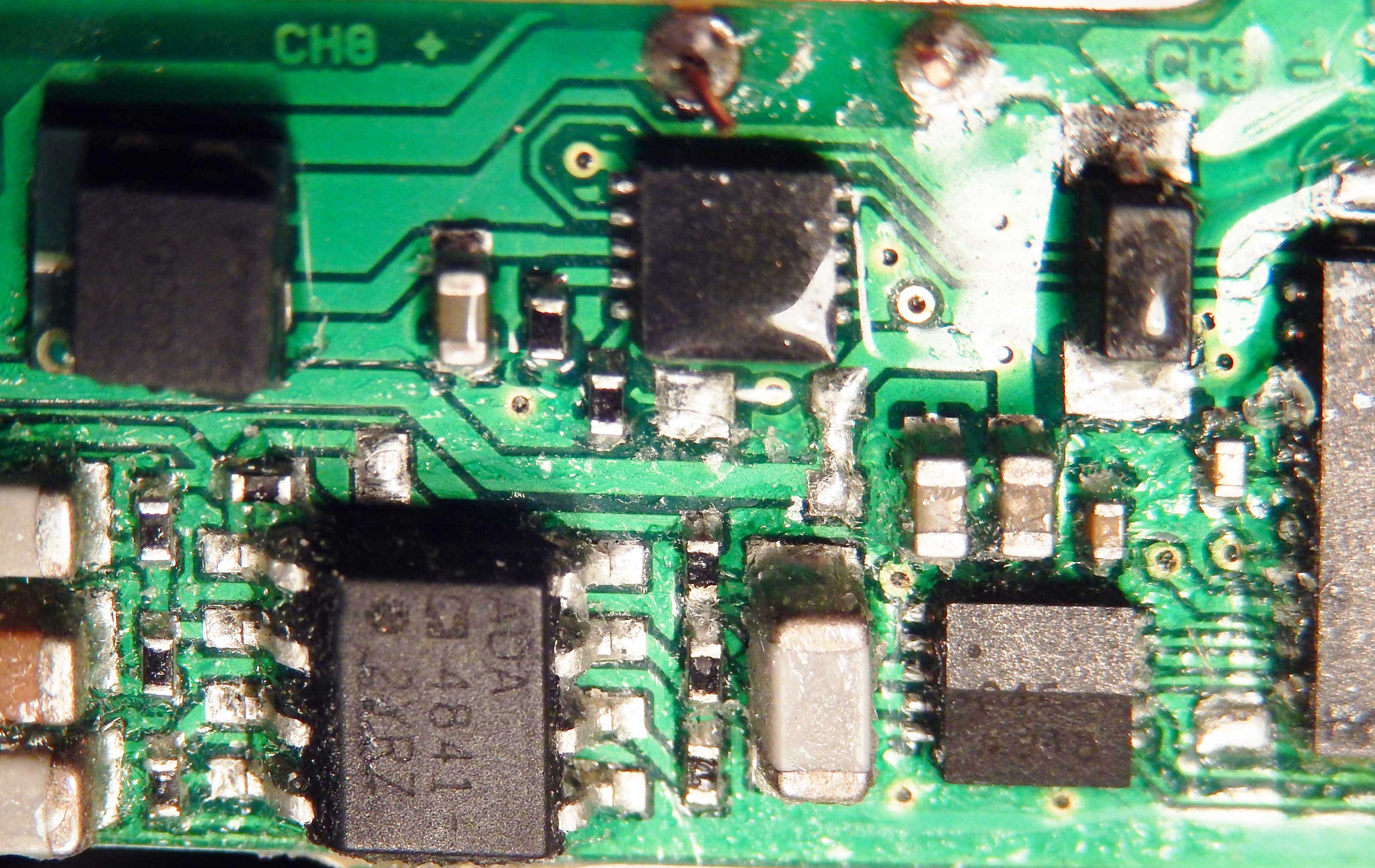

          Here are the Closeup chips:
          PIC24FJ64
          I think my problem could be the chip left to the PIC24, one connector seems broken...ill check for the part no...
          there is also a damaged connector on the PIC24
          ADA 4841-2YRZ
          8064-1235
          NRF 24L01 1307EN
          01T 1416 292L
            Thanks a lot for the pictures, it almost looks like they tried to scrub off the part number of the chip to the left of the PIC. can you confirm it says C4E? It's the analog to digital converter.

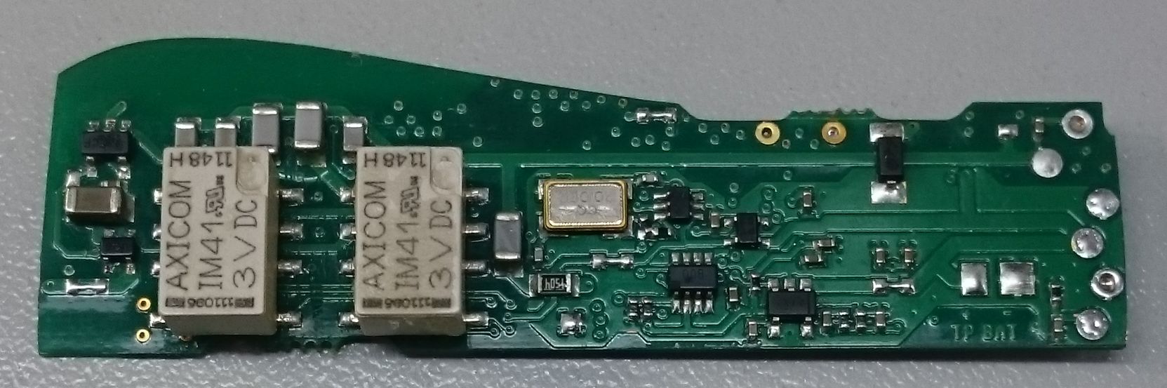

                These pics are hosted offsite.... Someone should make copies and save (Rev 3.1 pcb), or directly attach in a post on this thread.
                Orientation of the chip to left of the PIC.. - is different to the example posted by Henrik in his coil rebuild thread. In Henrikras example, the pins of mystery chip are aligned pointing to/and away from the PIC. (Rev 2.0 pcb)

                    The chips near the PIC , im unable to read it, even with my magnifier tools.I cant read if its CE4 .... I will try again with a computer magnyfing tool we have in a lab. Maybe it will be easier to decrypt the part number.
                    I did an oven reflow of the board (with a printer board at the same time) but its not working (the printer is now working). I saw on the board some connector lost their soldering ... i see the copper
                    I have a friend working in some fine electronic businness (aeronautics), i may ask him if he can clean the pcb with ultrasound then solder the lost connectors...

                        Try the reflow again but DROWN the board in flux first.
                        It also looks like you have conductive salt contamination on that PCB. You NEED to clean that off before you even have a chance. I suggest a 100W ultrasonic cleaner, de-ionised water @ 50 degrees C and 15 minutes at full power, then rinse and dry give it a try. THEN try the reflow.

                            I found some new good quality pictures of the Deus' coil PCB, comparing with other pictures I have, it's clear that the 10-pin DFN package next to the preamp has "C4E" written on it.
                            The ADC is: AD7691, 18-Bit, 1.5 LSB INL, 250 kSPS PulSAR Differential ADC (Datasheet)
                            The 250kHz also matches Deus' operating frequency, i.e the HF coil at 50kHz would allow for four samples per period (= 200kHz).
                            Wondering why they use a differential ADC and how they make that work....
