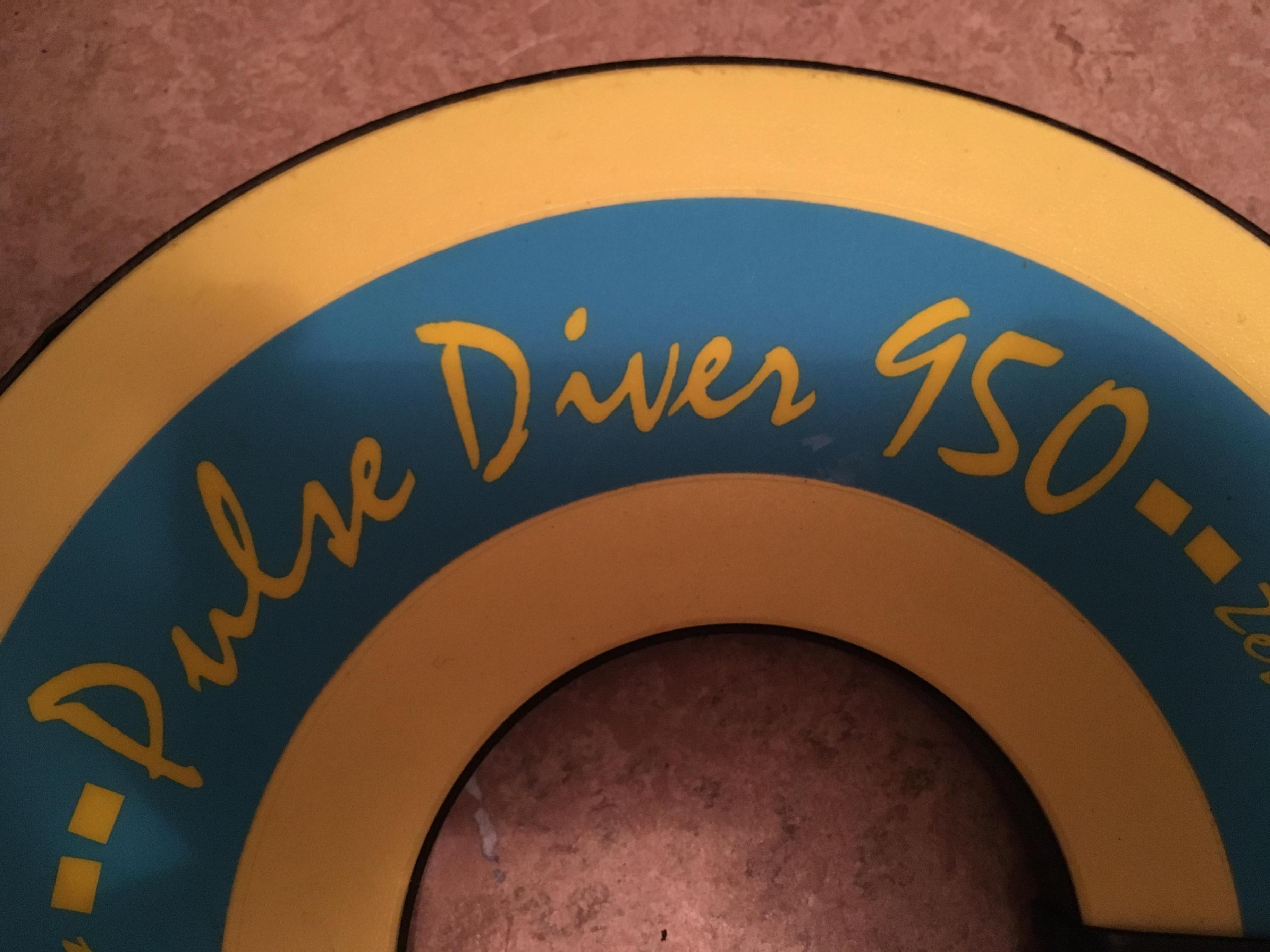

      The yellow 950 coil is original from White's and is most definitely shielded. Thanks, Tony.

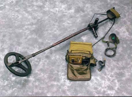

      there's a misunderstanding, The Yellow 950 coil is a Whites original coil yes, but as far as I know , it was standard on the Surf PI Pro.
      My PI3000 came with a different "PI3000 original" coil:
      Whites PI3000 Detector
      Luca

        I think I read somewhere that PI3000 models built from 1995 onwards had the 950 coil.

                So what is the inductance of the 950 coil?
                I found this:
                Coil inductance (pulse diver 950) measure 0.224mh (hi reading) and 292uh(low)- which one is the real value? (i don't have multimeter with me to check the resistance).
                So around 300uH would be ok for the pulse diver 950 coil. So there is a big discrepancy between 36 turns and 18 turns as noted on the schematic drawn by bill lhar. I am suspecting bifilar windings or some hocus pocus business.
                Because a higher PRF(pulse repetition frequency) translates into more current in the coil(all things being equal). You have to use the correct coil for the given circuit otherwise things can heat up, maybe even leading to catastrophic failures.
