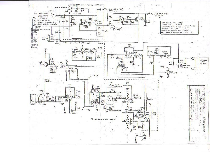

                Hi KT315,
                the set of "PIDX pages" reassemble the Whites PI2000 model. I traced that and compared it with a "Whites PI2000" labeld schematic. My questions are now the following. Maybe someone knows the answer.
                1) Were the PIDX pages issued by Whites Electronics? If not, does someone knows who published them?
                2) If it is not published by Whites, has Whites Electronics copied this detector from someone else?
                3) Was the PIDX dokument published before or after Whites launched their PI2000 detector? The year?
                Unforunally there is no information in the whole document about the true developer of this detector and the cover page is missing as well.

                      Well I am happy to report that the PI3000 is up and running and out of intensive care.....R16 is now a "happy" resistor. Ran the detector for over an hour and R16 (0.6W 5R6) was cool to the touch.
                      Initial tests on my gold ring were better than I was expecting....18K average size wedding band.
                      Thanks to everyone that contributed to the thread......it's good see another White's detector that should have a good deal of life left in her.
                      6 x new capacitors
                      1 x new charge pump (rated to 12v)
                      1 x new diode
                      1 x new resistor
                      1 x new 9V snap connector
                      All other IC's, resistors, transistors and diodes all checked and tested good. Hopefully the other non-electrolytic caps should be good.

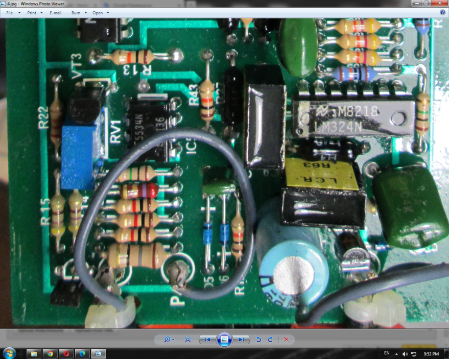

                              • #60
                                this part of board of PI1000 with R16, pics sent me by Pete M. on his pcb he deleted marking of Whites so ID number is absent, in assumption.
