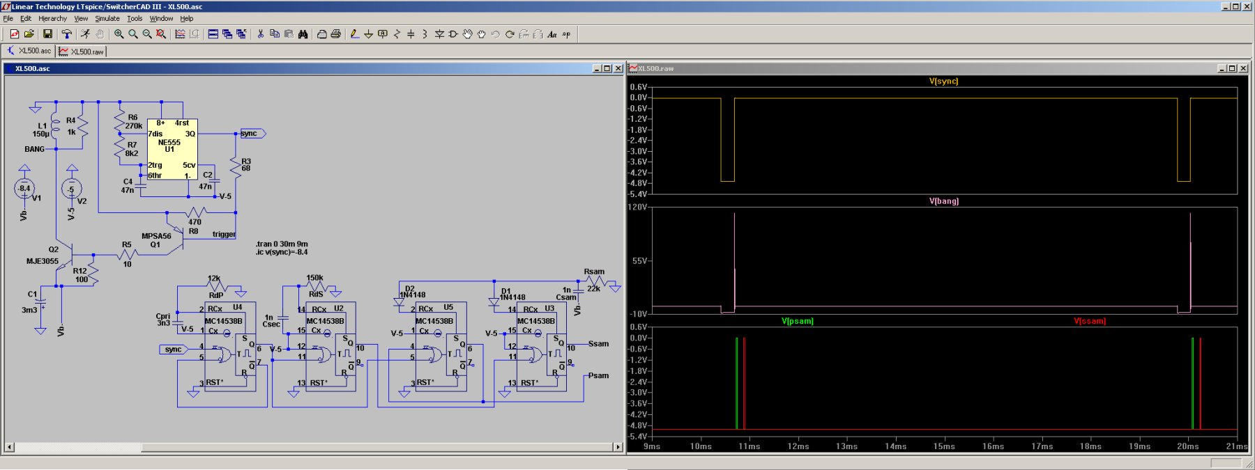

                I'll run set up and run an LTspice simulation and try to give you some more pointers. The timing and target sampling has many similarities to the Goldscan IV which I have already built in a virtual lab. But first, I want to work on my MC14538 symbol - add pin numbers, and check the timing on the model; I think it was adapted from the 74221 which uses a different formula. I'm hoping it takes longer to write about it than to actually do.
                I looked over the schematic, and after encountering the MPSU60 (or MPSA56 in a one of the other versions) and MJE3055 in devices, I noticed that I had no models to represent these. I was up until about 5:30 this morning hunting down spec sheets and spice models for these transistors and also for miscellaneous others transistors cluttering my parts bins.
                I almost got them all, but models for those two MPSxxx devices are missing. I'll have to determine a viable substitute, one for which a spice model can be found.
                I'll try to explain the circuit topology in a day or two, but I still have some foundation work to take care of.

                    The circuit is more easily analyzed if you break out the individual portions of the dual one-shots (os).
                    Consider that the 555 pin-3 output is active low. The "A" and "B" inputs of the os can trigger the device on
                    either a leading, or trailing edge, respectively - depending on which input is used.
                    The first os's input is to leading edge trigger "A", pin-4. The sample timer is initiated as the 555 turns OFF.
                    (Q\ connected to pin-5 sets a non-retriggerable mode of operation, but that is tertiary issue. I'm just pointing that out
                    because the device data sheet may not explain that connection.)
                    The first one-shot sets the initial delay between the rising edge (turn-off) of the sync pulse and the start of the primary sample pulse.
                    The second os sets the delay between the primary and secondary sample pulses. The two diodes (connected to pins 2 and 14)
                    cause the third and fourth os to share a mutual RC network so that their outputs have the same duration; as determined
                    by 22k resistor and 1nF capacitor. This diode trick only works when there is adequate time for recharge between outputs.
                    I learned this from reading Carl Moreland's Hammerhead pdf.
                    Think of the JFETs as normally off switches that are turned on by the sample pulses from pin-6 (primary sample) and pin-10 (secondary
                    sample). In the third os, notice pins 6 and 4 connected; this is how you do a non-retriggerable mode when the "B" input is being used.
                    Yes, the CA3140 is used in a differential mode, but the + and - inputs are fed at different times. The non-inverting input gets the
                    first,"target" sample. The inverting input subtracts the second, "noise" signal which has been delayed by time t=RC,
                    the 150k and 1nF on the second os. Because we subtract the 'noise' signal from the sum 'target plus noise', theoretically we
                    send only target to the following stages!

                    Something bothering me: the MJE3055 transistor is rated at about 60V, and my simulation clearly shows the device is subjected to over 100V
                    on the flyback! That voltage level would be highly affected by the search coil's inductance.
                    To increase sensitivity I would -otherwise- suggest the possibility of changing the timing components on the 555, but you have to
                    consider battery drain, and, possibly exceeding the safe-operating zone of the MJE3055 if the device gets too hot.
                    (I simply do not understand why this particular transistor is employed here.
                    If you change coils, you could possibly subject the MJE3055 to catastrophic failure!) Thermal runaway is a danger. I think that with some
                    simple resistance changes, a MOSFET (perhaps either IRF640, IRF740, or IRF840) could be substituted in place of the MJE3055.
                    I think you would get much faster turn-off, and, over-voltage would not be an issue as you try different coils!
                    I will modify the LTspice circuit and analyze this possibility. I think that IRFxxx could fit on your board if
                    you simply turned it 180 degrees. Mosfets aren't perfect, but they are not subject to thermal runaway.
                    Also, it is easy to increase pulse rate and decrease pulse width. The right combination might give better sensitivity and still not cause
                    significantly more battery drain, if approached intelligently. You want to have an oscilloscope handy before you attempt these mods,
                    but it's not really major surgery, imo!

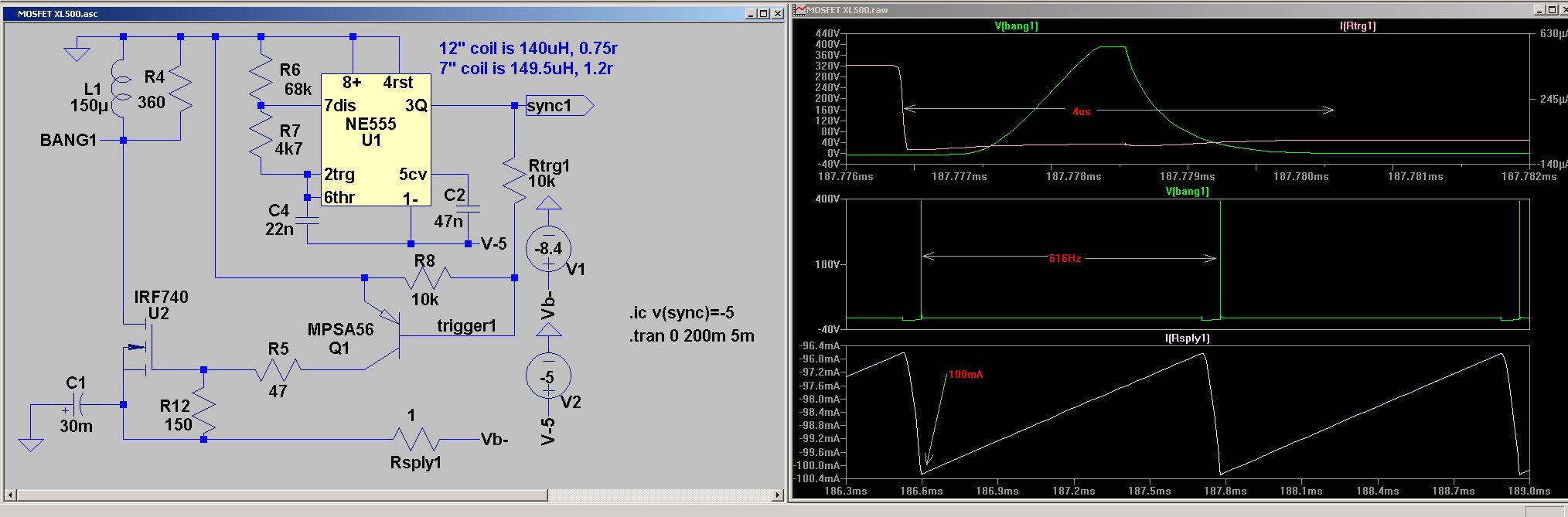

                    Hey, I just read where you mentioned the IRF740, good idea. You still need the predriver transistor to invert the drive
                    unless you change the 555 duty cycle drastically!
                      Ultimately, The Coil driver will be replaced with something like a IRF740. You can do away with the driver transistor and run right off the 555.
                      Your original schematic shows a 10Ω resistor in the MJE3055 base circuit. It should probably be 100Ω.
                      Battery supply current decreases from 150ma to only 100ma when 100Ω is used and it makes for a more reasonable voltage
                      across the MJE3055. I think schematic may be in error. But this is moot because:
                      You want to use an IRF740 but remove the MPSA56? Remember that you have a negative drive pulse coming from the 555.
                      If you were to remove the predriver without also reversing the 555 duty-cycle, then you would be energizing the
                      coil 97% of the time instead of the normal 3%. That is not a good thing.
                      Leave the MPSA56 in the circuit, you need it for signal inversion.
                      With an IRF740 you should change the value of the damping resistor. My virtual test circuit shows that something around 360Ω is
                      best - assuming that your coil is like the one that I am modelling. 360Ω might be OK, but no more. I think it should be rated for => 1watt.
                      I played around with timing and transistor bias. Here is something that might work.
                      The flat top on the coil flyback pulse is about 240ns duration, with a 8.4V supply and 150uH coil.
                      I looked at your original circuit, and that old MJE3055 might be good for salt water, but it turns off extremely slow compared to IRF740.
                      You don't want that for hunting small gold.
                      note: don't look at I(Rtrg1) in my simulation and assume that the 555 outputs a positive edge at that time.
                      If I were to flip that resistor around, then the signal would be shown going in the other direction.
                      One other thing: be sure and reverse the IRF740 orientation before you solder it in place of MJE3055!

                              No, that's not what I said. You got it backwards. So, while I'm typing my little fingers off, you are kicked back doing the 12 ounce curls? That ain't right.
                              Here's what I was trying to say:
                              Sample1 is (target+noise)......... [ pin-3, + input, aka noninverting input]
                              Sample2 is (noise)................... [ pin-2, - input, aka inverting input]
                              Result: (target+noise) - (noise) = target
                              That's my eighth grade educashun paying off! Time, well, spent.
                              Before I forget, some PIs have a small value resistor in series between the MOSFET drain and the coil. Something like 2.2Ω maybe more. I just today saw a design using 5.6Ω. I don't think it's absolutely necessary, but it's intended to help the FET run cooler. FETs get NOISY when hot (so do resistors, come to think of it) - which could reduce sensitivity to small targets. Just keep that in mind. Also, a small heatsink on the FET is good - if you can fit it in. IF not, then don't. I would use both a 2.2Ω
                              resistor AND a small heatsink, but that's just my being a stubborn perfectionist.
                              Although the average dissipation of the resistor may be less than 1/4W, it needs to handle 7W peaks. So, don't use a pee-wee. 2W should be good. You might be able to lift the drain lead on the IRF740 and solder a resistor to it to avoid having to cut the trace - should you deem it appropriate to use a resistor in the first place.
                              note: Although the MC14538 has internal connections between the capacitor discharge terminals (1&15) and pin-8, the datasheet suggests that an external path be provided. I suppose it's no big deal - because we are dealing with microsecond pulses. But that's why I show pins 1 and 15 connected to the negative supply and your schematic doesn't.
