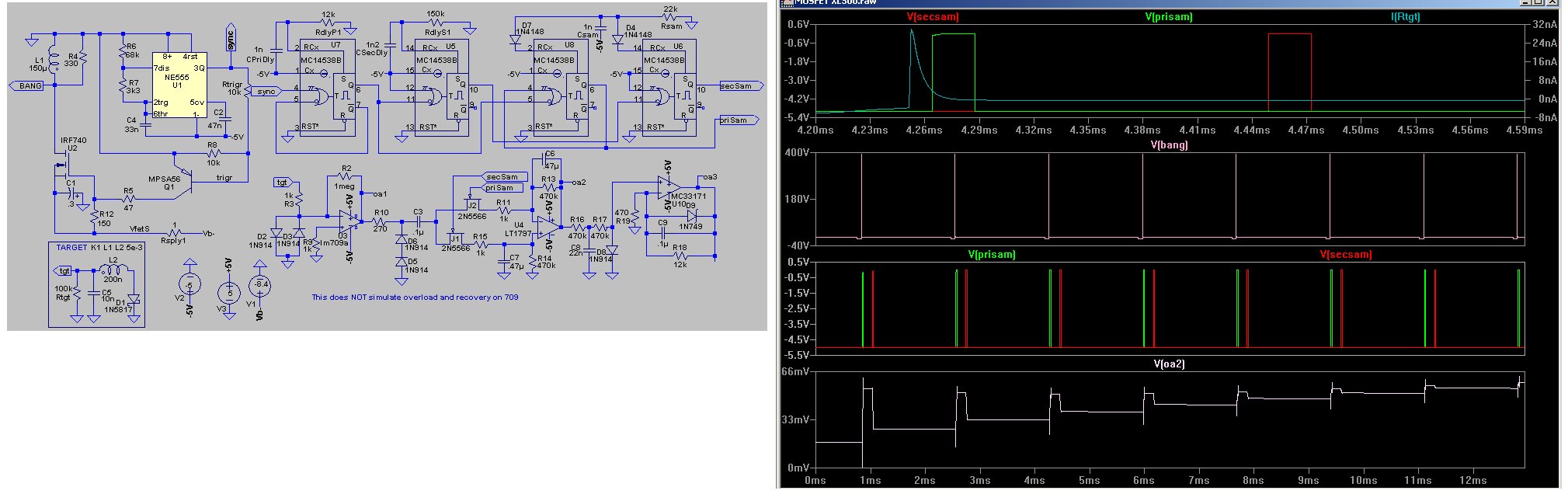

XL500 sample timing

      Do you know which model is this second schematic you posted?
      Just think of the jfets as SPST switches. The one-shots provite the control cignal. Only one switch is on at a any time. The one-shot timing determines their spacing and on-times.
      The first part of your circuit is the easy stuff. I'm having trouble understanding what happens after the 741. I'll need to simulate it before I can understand what's happening. Tarrrr-nation. It's damn convoluted.

            The first schematic seems to have been reverse engineered from the board it's self.
            The 200 and 500 use the same board. Only exceptions is the power control pot.
            The second one is someones knock off I think.
            I found them both here on the forum.
            PCB is there too if you want it.

              I'm working on simulating the scat you posted. It's a pain because, although I have 709 models from three different manufacturers, and even though the models are not exactly the same, they all have the same defect. Only seven pins are illucidated. The 709 uses all eight pins. To salt my wound, two of the pins are simply called "compensation". That would be OK if their connections were mirror images of each other, but according to the device's schematic - they are not mirror images. Which is which, and where is "output compensation"??? Why'd they even bother? How utterly USELESS. It must be a conspiracy to make me go crazy!.
              What's even worse is that my CA3140 model run extremely slow. The sim's already pretty slow because of all the 4538s. They're bad slow, but at least they have movement. CA3140's rediculous. I'll need to substitute something in place of it, simple as that.

                  Alright, I figured out my problem. The output from the first opamp is a negative signal. For a positive voltage to occur
                  at the output of the CA3140 (and then the 741) the primary sample goes into the 3140 inverting input. That's what happens.
                  But I'm not out of the woods. When I wired the rest of the circuit together, the signal to the headphone turned OFF
                  as the output of the 741 went high. That defies my logic and understanding. As I look at the circuit I am absolutely
                  baffled at what the simulation results show. Boo-hoo it makes me want to cry. I might have to pull my hair out
                  before I can understand what's happened. OOOwwww. OOOwwww.
                  Should I skip it or tough it out. Gaaa. (I should have stayed in school.) When I replace the 2N3906 with 2N3904 It works
                  to my liking, but I still can't get my head around the "why" this happens.
                  Moving on. If you examine my output file, observe that the plotpane at the top is drawn on a different time scale from
                  the other three. Primary sample is delayed by 14us (it should be 12us from the RC values, but I won't sweat over it.)
                  I extended the secondary delay by 20% by changing from 1nF to 1.2nF. The "target" is something I concocted.
                  My test circuit can in no way duplicate any overload that may occur in the 709. Sampling at 14us may not be
                  feasible, so that's why we use oscilloscope. I'll get one some day.

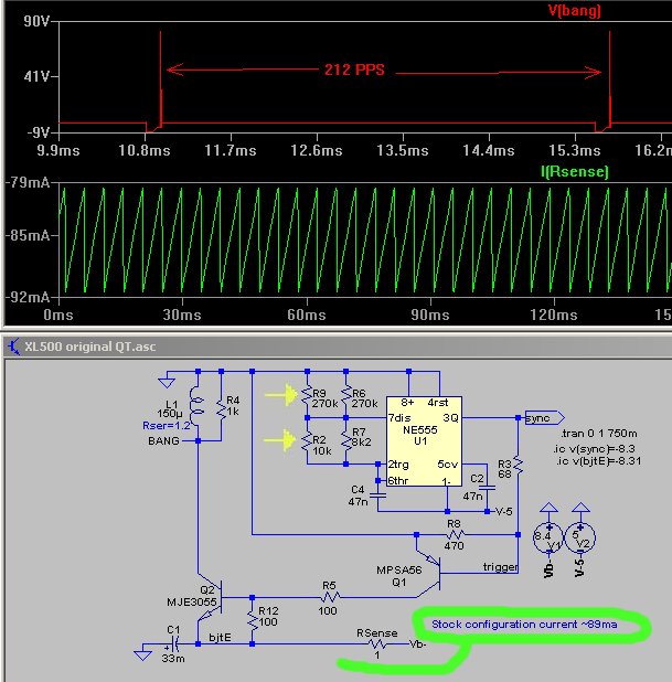

                                I have some other -conservative- ideas for modification. I do not think you would be wise to try and copy Carl's Hammerhead timing setup - not until you have replaced the BJT with a IRF740. Don't do it, you will very likely fry your output!
                                You should try and make sure you do not push your output BJT beyond its stock configuration power level.

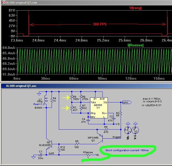

                                Attached are some possible timing mods. If you have an unshielded coil (that's my guess), you may run into problems using high transmit frequencies. 388Hz is not exactly lightning fast, and so it might work better than your original 100Hz. Either of these two scenarios will transmit slightly lower power compared to your stock unit, so your BJT should survive.
                                You will need different transmit pulse duration (RC timing at the 555 ) when switching to IRF740.
                                You should learn to use LTspice, it's free. The XL500 transmitter timing circuit is relatively fool-proof to set up and run. MJE3055 and IRF740 models are not included with LTspice but I could supply them and help you get started.
                                Of course, the 555 timer model (and all the others) are not exactly accurate compared to a real world device, and maybe I rely too heavily on simulation data, but hey - it beats zilching a component or two and not knowing why! Or, maybe I'm just funny that way.
                                With and IRF740; I think your TX signal should decays in about 5us (but don't forget the cable, amplifier overload recovery, etc.). You will probably do well replacing the .0033 cap to shorten the initial sample delay. Maybe .0015 will work? (Keeping your 25kΩ pot and the 5.1kΩ fixed resistor). When you use a different coil, these numbers could all change!
                                You may get better results if you also reduce sample PW approximately in proportion to sample delay.
                                NOTE: I did not show the stock configuration in my screenshots. The "Stock... 89ma" is there for comparison against whatever
                                the i(RSense) value is. I used an extra large filter cap (33mF, 33000uF) and a 1ohm resistor to make it more readily apparent. Also, the two plot panes in each photo use different time scales.
