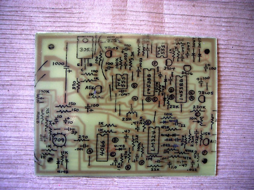

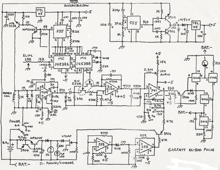

    the schematics you have drawn the parts on is different to my xl500 if you have a look at my photo.The 3055 in mine is a RFP8N18L and on mine there is no MPSU60(I couldnt find anywhere on the net a schematic for this version of the xl500 )
    Here's the schematic I have in my data archive. Is it incorrect?
    • There are similarities but it is not the same one,(i am currently considering throwing the whole thing in the rubbish bin,but sledge hammering it first)
      • Originally posted by Micheal View Post
        Do you have the correct schematic?
        If so, please can you post it here?
        • Sorry I dont have the correct schematic for this model ,and I cant find it anywhere on the internet.It will make things a lot more easier if anybody has it.

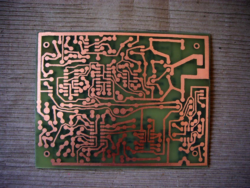

            If someone has a circuit xl500 Please complete this section to upload files together with Pcb
            • Originally posted by mmlove2007 View Post
              Hello to all Dear
              Go back through the pages of this thread and you will find it all.
              • i can old pcb in pdf file
                is not pcb xl500

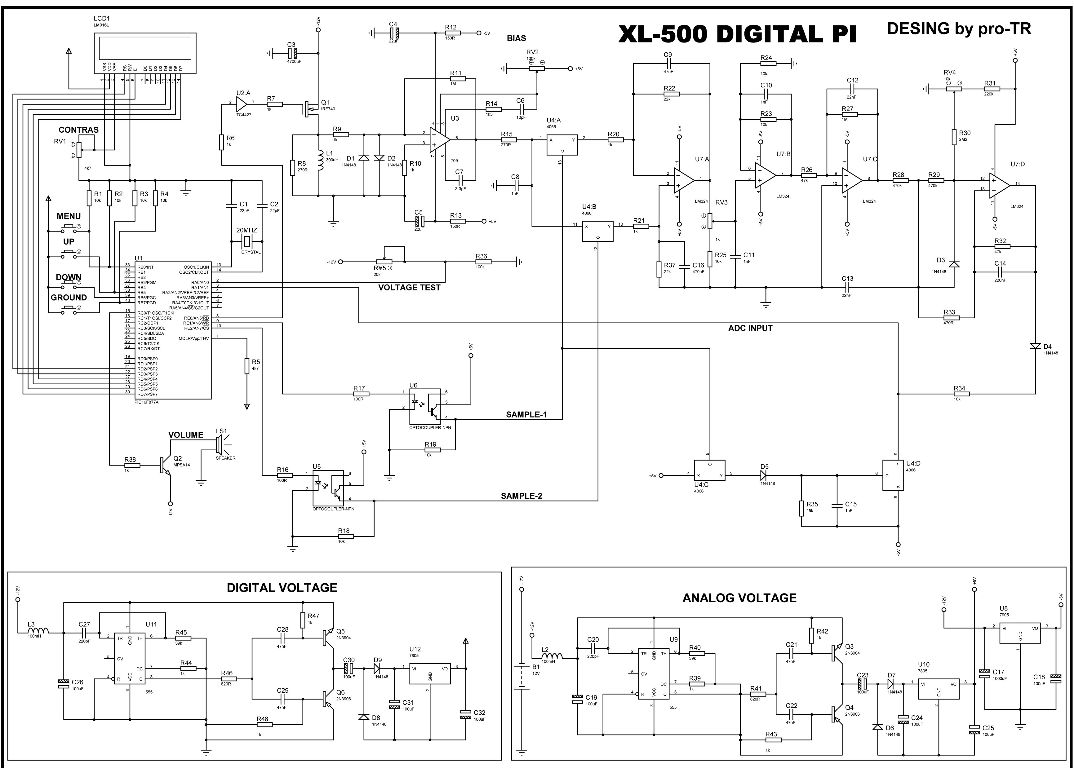

                    • xl500 digital
                      xl-500 full digital
                      • Errata in design of pro-TR (posting #190):
                        1. The resistance of R7 should be lower ohm for fast charging and discharging input capacitance of Q1.
                        2. Tere is no point connecting R41 to R39 & R40.
                        • xl-500 analog
                            ok..
                            1.R7= 100R~470R
                            2.you're right, I was doing a drawing error
                            • For ahmet19
                              What is "XL-500 DIGITAL PI"? Who repeated it? Characteristics? A photo? Video? PCB? Software? Coil? Or it simply theory?
                              • Originally posted by smity View Post
                                hi
                                I designed the XL-500 digital. If you want to do if the PCB of my stock. Software no problem. I've made a similar escape attempt. I made such an analog circuit and digital delta pulse.
                                I'm ready for my XL-500 PCB. But will you make it. I also write software.
