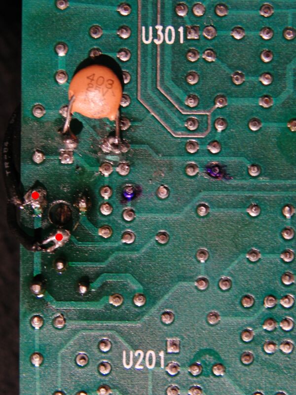

Noise-Reduction for Fisher 1266-X (evtl. 1270-X & 1236-X2)
    Anti-Noise Modification 20nF
    After tests with 5, 10, 20 and 40 nF capacitors I found out that 20 nF works best.
    That's the double amount as default and therefore reduces background noise for 50% by really good conditions concerning sensitivity and discrimination signals!
    Work's like charm!
    If possible for avoiding confusion someone please delete the 2 multiupload-links and 2 capacitor-pix above.
      Here the exact solder-points inbetween (red <---> black) you can attach the additional 20nF capacitor or replace the orig. (-> blue <-) with a 40nF.

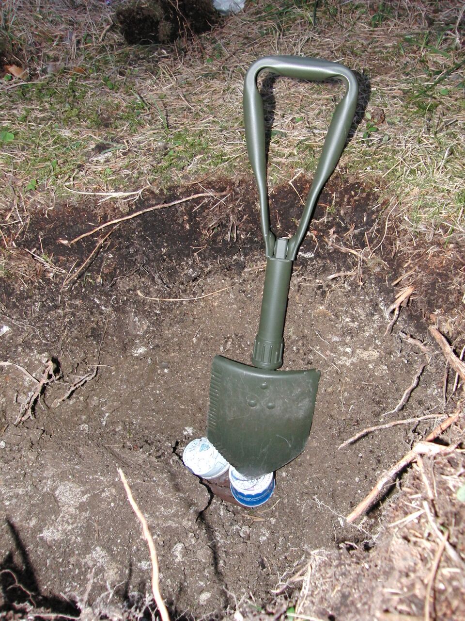

        I buried the below objects in high mineralized ground at 43cm / 17inch.
        At 30th march I tested the "plus 20 nF" mod there.
        I did know exactly where it was so I could distinct a slighlty difference between "snap, crackle and pop" and detectors metal signal.
        Because it was such an almost unhearable difference, yesterday I tested: "plus 40 nF".
        Now the bias is even higher and the signal is well distinctable by almost no background noise!

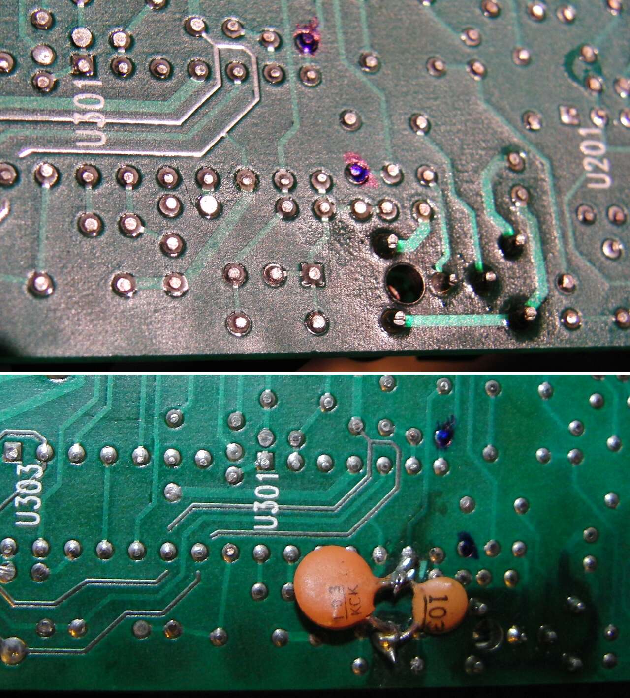

            Below two pix for better explanation:
            That blue "doubleswitch"-var. resistor (used for the sensitivity-regulator) adjusts the output of a grey wire, going to the platine.
            It's a bit complicated to deconnect this resistor so you also can just solder the cable to the board as shown below (red dots) and add a different variable resistor that is accessible from the outside.
            Otherwise desolder the blue cable that is coming from the battery-check knob plus the single 100k resistor from the push-layer contacts which are located near the plain metal backside of the variable resistor and attach the both new cable-connections from the platine there.
