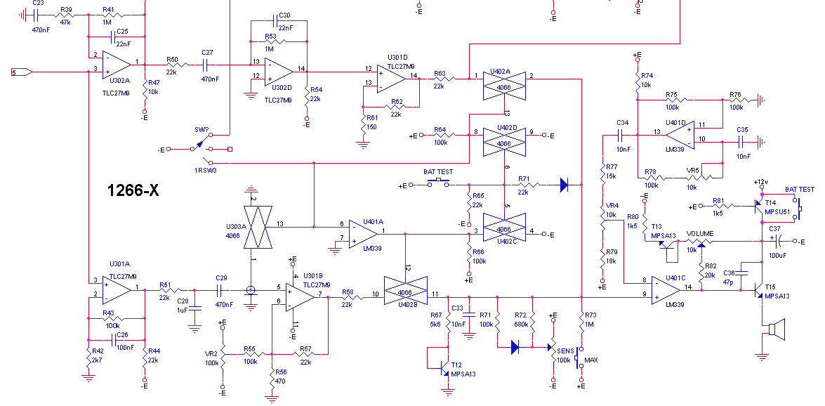

    Good news - my Fisher 1266-X schematic should be still here:
    This link seems to be dead:
    The 1265 circuit is here:

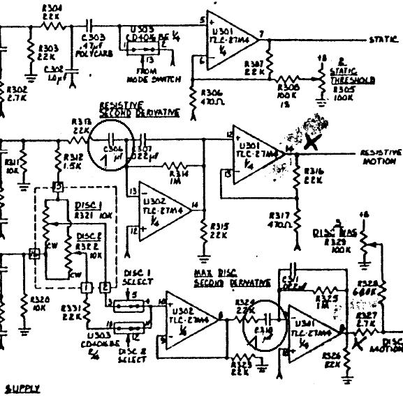

          Attached the 1265-X schematic, by pure coincidence yesterday I found two old Fisher folders
          from the year 2003 & 2008 on my harddisk that contains some files I didn't knew I have them.

              I'm shure now after almost 20 years someone could replace those opamps and transistors with
              less noisy ones to get 30% gain in depth and for those who don't like the signal-booster there
              should be way to locate this circuit on the 1266-X schematic and remove or bypass it.
              It should be located somewhere close before the final audio output stage - see below.
