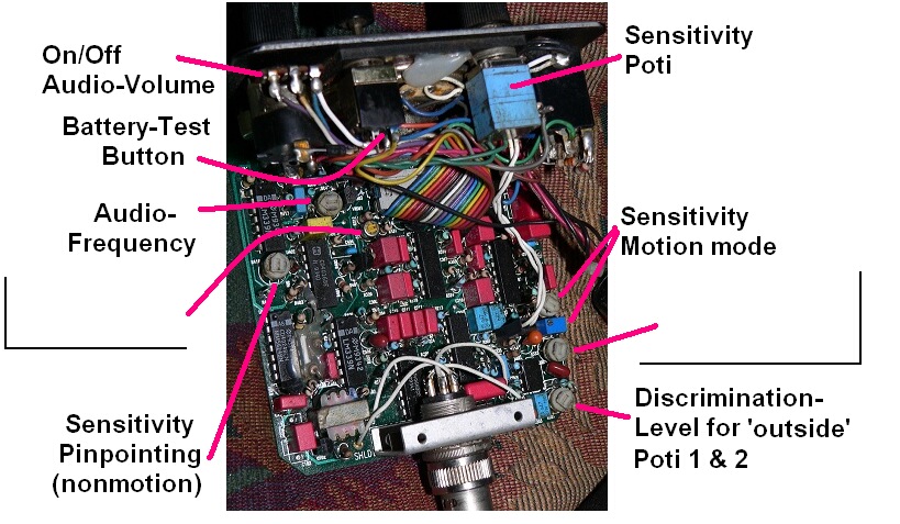

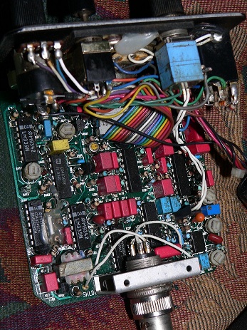

          Can you identify these components please
          Hi ive done pretty well much of the mods on this thread(and by the way what a great thread)few mods left to do,but for now i pretty much know what all the trim pots do except the one with yellow insert by the wired ribbon, closest trim pot to it would be the tone pot,does anyone know what this little trim pot does?and ive noticed up by the ribbon hidden away at the top by pots there's a bulb or a valve,any ideas as to what the bulb is as it don't light up and is bothering me now, that's it for now ill leave it with you boys,but im not finished not by a long way,cheers
            That light bulb is part of a battery charging circuit. So it won't light under normal operation.
            Its an old trick to regulate current while charging nicad batteries. A charger is connected through a series diode and light bulb to B+. When a low battery is connected to the charger there is a large voltage differential. This causes the bulb filiment to heat up and the series resistance to increase. As the battery voltage increases to full charge the voltage differential, and series resistance decreases. This creates a constant current over the full charging cycle. I know too much information
              Altra, in the case the bulb is working like BARRETTER.
                I never heard of Barretter or don't remember.
                After looking it up, yes it works the same.
                  re barreter
                  Thanks for speedy response,any idea what the small trim pot with yellow insert does,and any ideas as to why my threshold sometimes speeds up and slows down and sometimes goes completely?
                    thx dejavuband you liked this thread and
                    great that the mods are working fine for you!
                    Also haven't any idea for what the yellow pot is.
                    But so far I have the following describtion and
                    would be great if someone could complete it.

                        btw. the PCB I have is different, theres just 1 variable resistor in
                        the corner. Perhaps yours now has 2 different pots for presetting
                        each of the both discs.

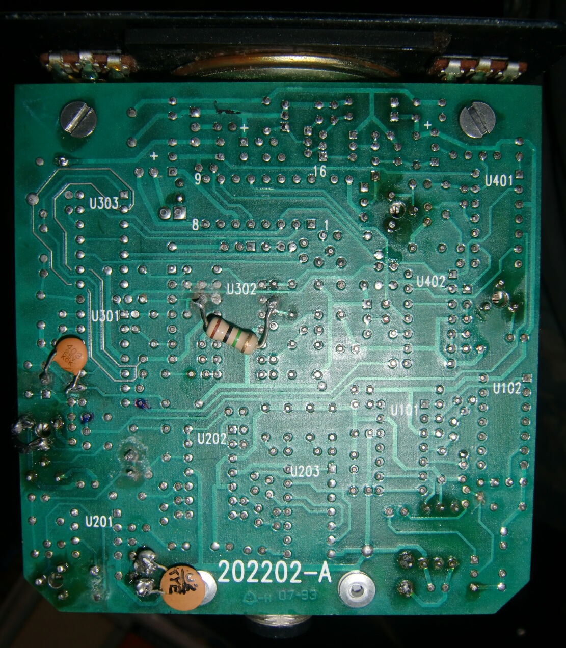

                          Because I opened the Fisher 1266-X for the above picture
                          now I also took a second one from the PCBs back:
                          On the left side the already know 40 nF capacitor and the
                          both connection wires to the variable push pull resistor.
                          As far as I can remember the 1 MegaOhm Resistor in the
                          middle also has to do with reducing the noise.
                          And the very low value cap (I guess around 5-20 pF)
                          was soldered parallel to either the transmission or
                          reception coil contacts (I guess reception) so the
                          Fisher 1266x no longer discriminates very small rusty
                          iron parts (5mm diameter).
                          btw this mod also slightly improves the sensitivity to other
                          finds by some percent (iron ca. 10% < - -> silver ca. 5 %).
                          Perhaps the 8'' spider coil finds such stuff by default
                          because of slightly different "calibraton" (coil impedance)
                          but I haven't this 20cm coil that's why I can't test it.
