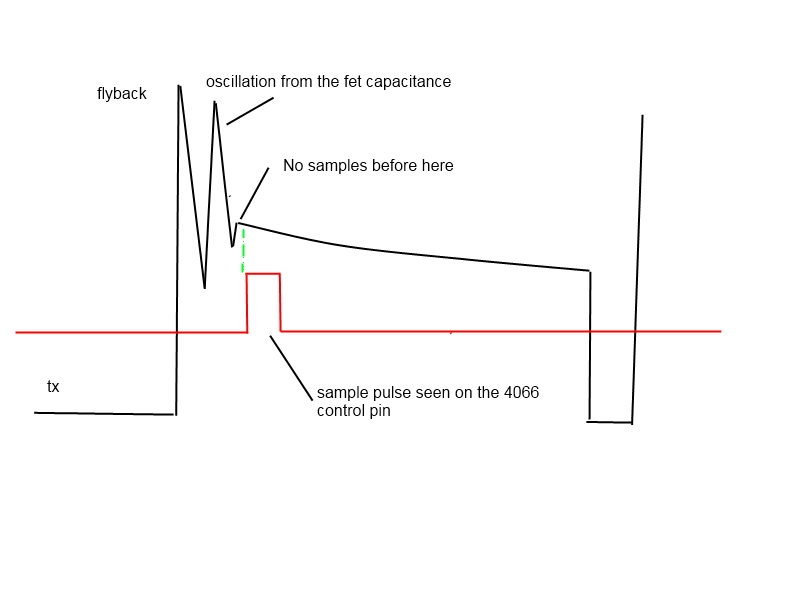

                    • G'day Mario,
                      The reason why it takes so long to boot up and then ch2 is only sensitive to large objects is the first ch2 sample must be being taken before the front end fets have turned on and settled properly. Slowing the oscillator back down some might allow the sample to happen at the right time. Might be worth the exercise to put the std caps back in and try the different timings then and also try them on the ground.
                      To make sure all of the samples are happening you need to look at the test point near the 4066's with your scope and with the other channel test each of the control pins on the 4066's and make sure the sample pulses happen after the front end has settled. I have attached a dodgy pic of what this will look like! Check this with both your coils too because the coil you made could have different capacitance to your 6" coil and may take longer to settle than it should. Can you send me a photo of your scope controls so I can guide you a bit better....
                      Cheers Mick
                      • Yo Mick!
                        I solved my problem.
                        Man did it kick my ***!
                        I took a look at those pulses like you suggested under the scope and realized something wasn't right about them. So I decided to install the original eprom and rewired everything to default settings. After realizing that the problem did not go away, I went over my work and noticed I had cut a trace to that 33.5nF capacitor on the photo, the one left of the 27C256 IC. In order to make the 28C256 chip compatible, I had to retrace the two pins I mentioned earlier and that cap didn't close the circuit leading to some eprom ground pins not having that much needed capacitance. Finally, I carefully bridged the trace back to its original form and my hard boot problem got resolved!
                        You were also right about there being a difference in capacitance for my coils. I made my 6" radial in design and is really super fast. I love using that little coil. I can swing away quickly and not miss anything and is really sensitive. The only reason I don't use it much is its lack of depth. It has an inner diameter of 4.25 (i forget) so I have mediocre depth and coverage. My 6" has a nearly perfect inductance of 301uH, while my 11.5" has closer to 314uH.
                        After solving that hard boot problem, I can now verify 100% compatibility with the programmable 28C256! Just make sure to do what I suggested earlier (with the exception of cutting that capacitor out!).
