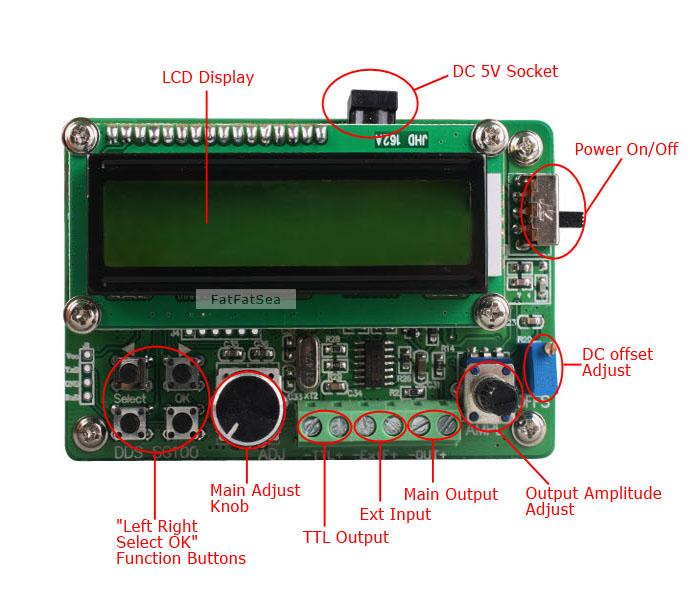

                  DDS 50 bucks on ebay ... sometimes buying beats building :-)
                  See ebay .... just search on "DDS"
                  eg .... item
                  280700041512
                  these are new items !!

                    Thanks Ian,
                    This mod should work fine with the SD2000s. i did not notice any jitter from 1-4Mhz,so there should not be any audio issues. Still, I would like confirmation.
                    However, with the SD2100s, the situation becomes tricky. Because I'm inderectly controlling the frequency, those two caps limit my range . if im not carefull jitter starts distorting the audio.
                    My next step involves finding the right cap combination before finishing up. Otherwise, I'm going to slightly mod the audio.
                      Moodz,
                      Before building my solution, I explored several options. After my failed attempt at trying a programmable VCO (like Ian), I found the above board on ebay.
                      It is sometimes difficult to trust the claims of those ebay sellers. The above board does not use AD9851 for DSS, but did claim similar specs.
                      Sometimes it pays off to reinvent the wheel.
                      • #41
                        Hi Mario,
                        my comment was a bit cheeky....I was just indicating a possible shortcut for some who dont like surface mount soldering etc. Of course there is always opportunity to make a new an improved wheel like your good work.
                        regards,
                        moodz.
