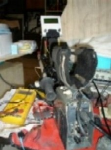

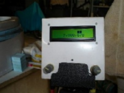

      Software done
      I have completed the software (soon to be posted) and have resolved the last remaining issues.
      You may watch the video here: http://www.youtube.com/watch?v=8UnrnvRAb68
      I decided to cut the little board, and incorporate the controller module inside my power unit. I found enough clearance to fit the little board entirely inside the case, but decided to subdivide the dss module and main controller. I could not find enough room for the LCD, pot, and encoder in addition to the stock pots and selection switches.
      I really like this mod since it allows me to use the stock ground balancing pots and switches. Though they now feel redundant, I did find myself using them alongside the encoder for fine tuning the frequency at the lower settings.
      I know this mod is more of a sophisticated frequency hack. A more refined approach would have been to replace the whole oscillator/eprom/ transmit circuitry with micro generated signals, like some of you have done, but it is what it is...
      Maybe after attaining a deeper understanding of the signal train could I then try to emulate it. If any one has a solid understanding of the signal and would care to explain it, please do drop me a message. Or If any one has a link to a good article or discussion on the issue, please do email me also. I envision the day some one will digitize the signal and process its characteristics via a super fast 32bit micro, assuming none of you have attempted it yet.
      Anyway, one last addition to the mod I will eventually include (later rather than sooner) has to do with the eeprom. That eeprom just begs to be re-written to. The Atmega328 has a 1k eeprom so I could theoretically fit the entire system timings inside it (the contents of the 27C256 eprom don't exceed 1k). In fact, the stock timings currently expressed don't even exceed 256 bytes (don't forget about the 3 hidden timings -it's these 3 hidden timings that bring up the eprom size to 1k!); therefore, I might simply end up re-writing the program to include support for flashing this 27C256 with the contents saved to our Atmega328.
      Imagine wanting to experiment with your own hand-made timings. If I include this mod, you would, simply, flash your Atmega with your experimental timings along side the stock timings. Then, when you're ready to experiment, you would flash your detector with your saved timings. And If anything went wrong, you would revert your timings back to stock-no harm done.
      The eeprom mod is a perfect compliment to the frequency mod! All we need is 3 extra pins from our current setup and separate grnd/vcc rails. Here is great potential for further enhancing our detectors.
      One last thing I will mention, I need some rest, so forgive me for disappearing for the next week or so....I've been working on this and need to stop. In addition to my regular job, I'm really really exhausted. To all of you that have posted and have shown interest in the boards, I have reserved them for you. I will just need the types of configurations you desire (board-only or board+component combos). I will only sell the AD9851 chips to those who can not find suppliers -they're really pricey, digikey's selling them at $29US!
      To everyone else who's interested, email me to reserve a board. I only have a selected remainder so some of you might not get them...I might order another print run if there's enough interest, but unlikely...
      just please give me some time to take a brake...
      thank you for understanding
      Note: I screwed the dss sub module to the daughter pcb and will include the controller inside my power supply.

              • #52
                Put in another 3 hours
                Everything still stable, the mod keeps going strong.
                No sparks or smoke !
                My offer still remains: A FULL non-assembled AVR-DSS kit for a working "DD" coil. I don't care if you build it. I just don't want to take time to build my own.
                *Lipo kit or audio amp not included
                • #53
                  images
                  This completes work on this project guys. I'm really proud of this software release. After several hours of field tests, I can attest to it's usability.
                  Update includes:
                  -Save/Load frequencies
                  -Decreased battery consumption (by a lot!)
                  -Defaults now to SD2000 (toggle pin 27 to get SD2100 Mode)
                  -No modifications needed to hardware.
                  -Program is very stable.
                  -Make sure to program the fuses with the following: Low:62 High1 Extended:FF
                  Also, I did mention my intentions about programming the SD2100's eeprom. However, it seems like I was wrong about the pins required. I need far more pins than the Atmega328 can provide. Indeed, even with the 64 pins of the Atmega128, it is barely enough to do something useful. Having said that, I'm working on interfacing with this eeprom. I'll keep you updated.
                  Last thing I would like to mention: I took Ian's offer on the coil, So no more trades.
                  CODE SAVE as "AVR-DSS-2.hex" and enjoy!!

                  • #54
                    Hi all,
                    Well I have got Mario's module up and running on my SD2000M after sorting out a few bugs mainly self induced although is is running early software it is truly impressive I will now go and do the tests Mario requires so he can optimise the upgraded software for the 2000 I can not wait to try it in ernest here is a picture of the module mounted on my 2000.
                    Regards, Ian.
                    • #55
                      Hi Ian,
                      Nice work on the case, where did you get it done?
                      Also, I never did ask, but how did you interface with the detector? Did you end up removing the Crystal selection mod? Did it work with the 100pF cap? or did you install the other test caps?
                      I'm glad to see the mod up an running on the SD2000. That model just keeps getting stronger as the years pass.
                      • #56
                        Hi Mario,
                        The case is homemade out of the same 1mm ABS as I make coil housings from but fabricated not vacuum formed and yes it is fed through the 100 pf cap into the detector in lieu of the crystals I can either switch the crystals in or your unit in .
                        Regards, Ian.
