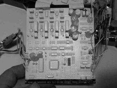

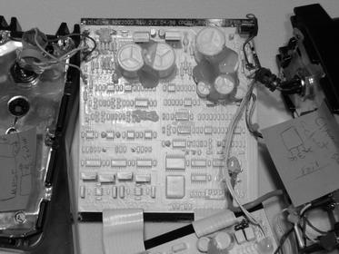

                            As promised here are the pic's of the SD2200V2. They are in the next posts, because I don't know how long it will take to UPLoad each one as they are from my 14Mg pixel camera. So will try one and see what happens!
                              SD2200V2 CCT
                              Power Supply is comming in from Upper Right Side.
                              TX and RX are on the Upper Left Side.
                              Well guys I looked at the upload window and will have to either upload to my Photo Bucket acct. or I'll have to seriously down grade the resolution to post them.
                              Heres what I got, If anybody could explain or tell me where to go to learn to post larger better resolution pic's PLEASE Shout Out!!!
