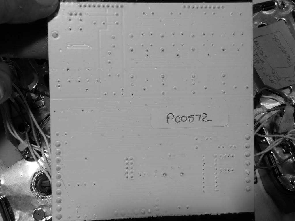

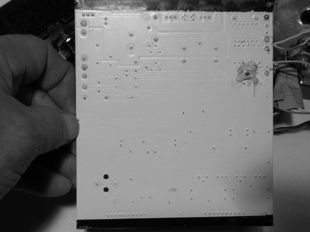

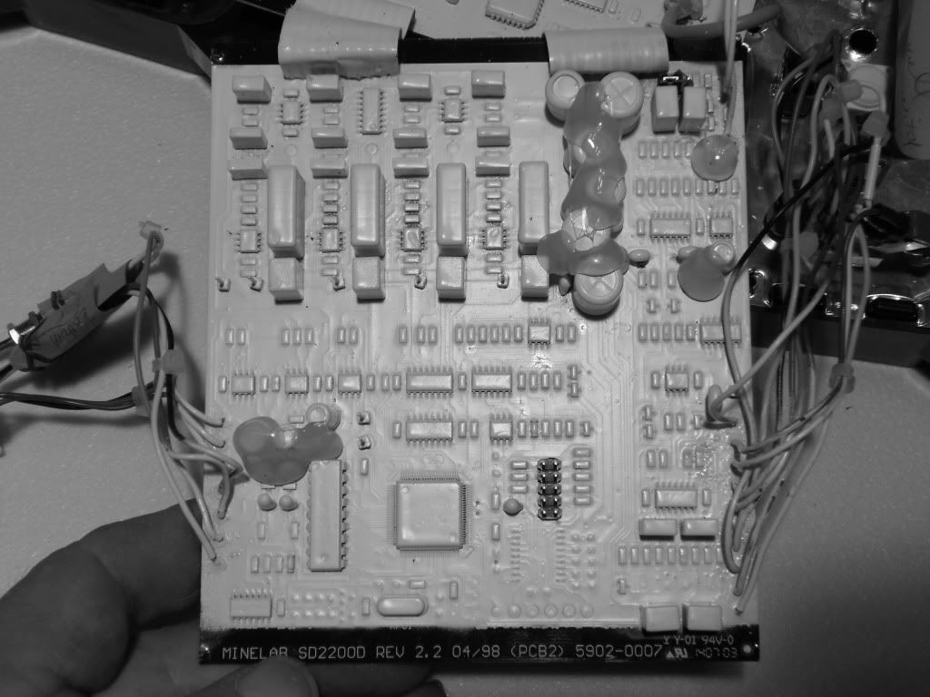

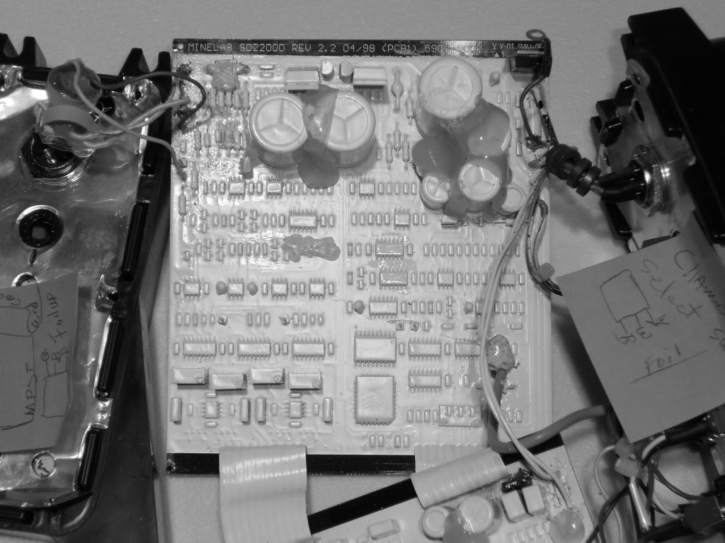

      High Resolution Pics.
      TX-RX Componet Side^^^ Power Side^^^^

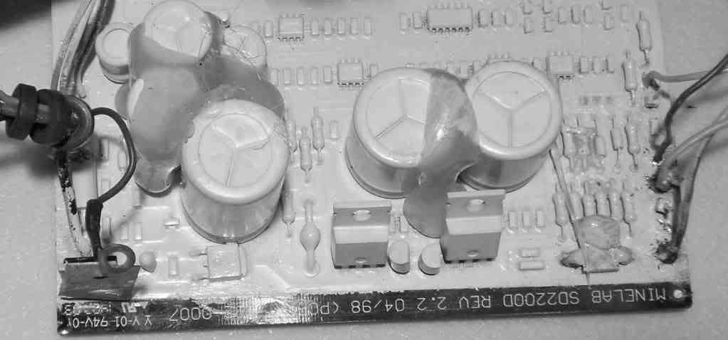

      This is the Battery In side ^^^^^^ I'm trying to figure out what the SOT23 chip is to the Left of the Big Cap!! Anybody have any Ideas???
      Any Body have any luck getting the "Paint" Off these boards. I tried some MEK and it worked a little after a fasion.
      What is the Stuff Anyway????

        To get the paint off, either find someone who does soda blasting(like sand blasting but not as harsh) Google it!
        Or the way I do it is contact cleaner and a small flatblade screwdriver. After a while the contact cleaner makes the paint go a little bit soft and it seems to lift off a bit easier, either that or the determination goes up a gear! When finished, just clean up with more contact cleaner and dry. You will need to coat the boards with plasticoat or some other protective spray to keep the moisture out.
        Try and avoid paint stripper, it is bad stuff(for you) and can eat the copper from in vias and end up under your ic's. If you do use it you have to clean the board with water making sure there is enough pressure to clean under the ic's. Then blow with compressed air and dry with a hot air gun(don't get it too hot!)
        However, you might not need to scratch off much paint anyway, from the photo's a lot of the traces are identifiable, you can probably get away with just using a multimeter to test for continuity. When cleaning the tops of the components, be careful as there will be resistor markings there, make things easier if we can just read the value.

            What you see in the High Res photos is my Solution to the URBAN Myth that the SD2200D and the SD2200V2 and the GP Etreme have the same CCT boards or are similar. The're NOT.
            This is very apparent by looking at your pics you posted and my pics and the link to Woody's pic of his SD2200D power supply end.
            at the following link;
            http://detectormods.maxforum.org/201...pgrade/#post15
            All I wanted to do is REPLACE the Weak Fet with the One Woody suggested, so I can run FROM a Battery at 7.6Vdc for 4 hrs at least. I don't like to have to keep comming back to the Rig In mountainous terrain untill it gets Dark.
            I am Still trying to ID the 2N7002 FET so I can replace it with the IR part and the Bipolar transistor ZTX688 because it controls the other half of the CCT, and I don't want to swapout the wrong one.
            The other reason for posting the pics is to see if maybe we can get a CCT Schematic Started off the old 2200/2100 ones.
            Anyone interested??????

              Hi Bill, I think bkline was advising against removing all the white paint. Usually what happens is unintentional damage to the caps since they easily soak up whatever cleaner fluid you use.

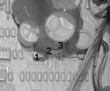

              Anyway, take a look at the picture I uploaded. To identify "2N7000", simply follow it's gate, it's connected to a 100ohm resistor; afterward, it will eventually connect to an IC (hex4093). The drain will be connected to the annode of a diode (maybe it could be the big ugly diode seen also in the picture, to the right of no. 3? ). And the source of "2N7000" will be connected to battery ground.
              My machine uses ZVN2106, not 2N7000, and if I had to guess, it would be either of those parts I numbered as 1,2, or 3.
              I don't know if it will help much by making this part beefier. If anything, you probably want to find one with a lower Vgs to make sure the gate is fully saturated. I will have to go with the general consensus that the power cct is noisy and needs to be overhauled in these older SD models. After looking at your pictures, I'm glad to see that your board has the 27C256 eeprom since you can make this detector much more sensitive if you wanted to by playing with its contents.
              If you want to find a replacement circuit for the power section , you can always look at designs found in pcb software. Eagle comes with several designs. I use Sprint Layout 5, and it also came with several designs...all of them ready to be printed.

                  I am including two high res pics from my USB Microscope, on where I romoved some paint from the cct brd. I had originally thought I had Scrapped off the TRACEes, but after close inspection I id'ed the presense of a copper trace UNDER the BLACK Epoxy/Mask/Paint/????.
                  I am beginning to think that this white paint and black mask?? are just Environmental SEALS, for mainly protecting the Board from the elements. MineLab makes Military Mine Detectors and I can see them just having 10,000 boards made that would use the same layout for both types, and just substitute componets and MCU Code for each different use. AND Yes I Know its the living Pitts none the less.

                  Mario, I'll try to get the paint off the componets you labled and get some pics of that part of the board.

                    Looks like black solder mask to me. Instead of the boards being green, they are black!

                    When you are scraping the paint away, stop when the track starts to become visible. That way it will be much easier to figure out what goes where. Black traces with white background, nice.
