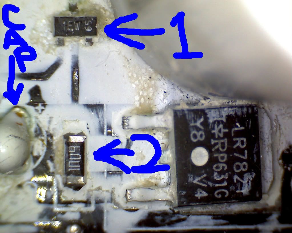

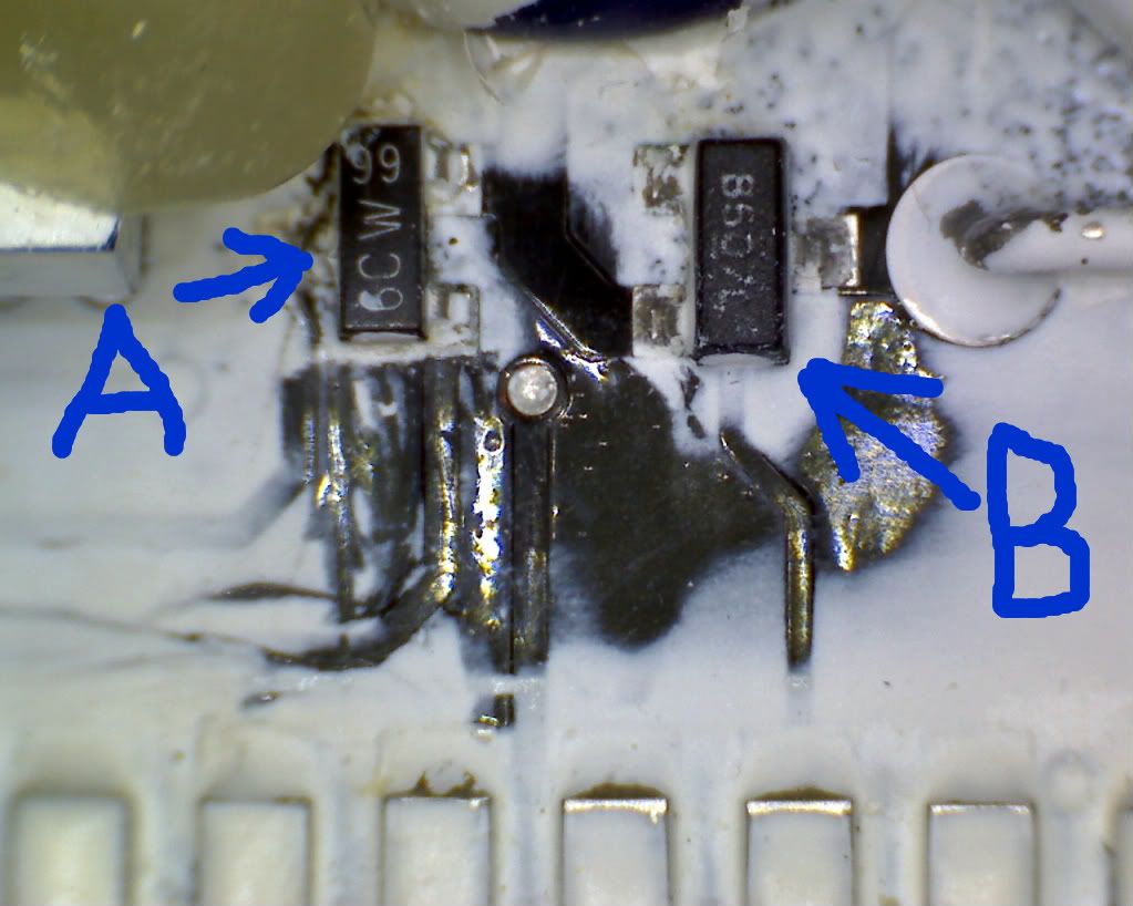

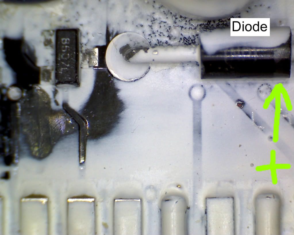

                I agree bkline, so here is the pics I promised last week!!
                #1 is the fet Woody was talking about I think, IRLML0060TRPBF, BUT HAVEN'T CONFIRMED YET.
                #2 is a resistor with a measured value of 985K.
                A is not the one??? The #1 in your pic mario I don't want to take the time to clean off yet.
                I think the #3 in yours (B in mine) is the one that connects to the diode in the next pic.
                My eyes are too poor to be able to see with out the microscope set up and then I can't get the probes and other crap all setup to take measurments also. I didn't realize how much my macular degeneration would hinder this endeaver. I'ts been some time since I tried to do any real closeup work like this and I'm just realizing how bad it's gotten.
                and this is selfexplainatory above.
                mario how do you reaconize and or Identify the parts when they are SMT pieces. The numbers don't cross reference until you know the part # and then the numbers on the SMT part are just the date codes and such???
                Is the part number under the black solder mask? This isn't like in the 1980's and 90's everything's different, or I'm too old and ignerant!!!
                • #53
                  I believe the 6CW is a SOT23 - BC817 or SOT323 - BC817W
                  45 V , 500 mA and are NPN general-purpose transistor
                  The 1EW should be a BC847 SOT23/SOT323 -
                  45 V, 100 mA NPN general-purpose transistor
                  I couldn't make out the other SOT23 chip numbers. Maybe you can.
                  Info taken from www(dot)s-manuals(dot)com website. (replace the dots with a .)
                  Select on the left side marking smd selection and it brings up a table to select from.
                  Hope this helps.
                  /r
                  jonn (aka Jiminy)

                      jiminy, thanks for the info. It's just what is needed by me anyway, I didn't know where or how to find the CrossReference #'s for the SMT stuff.
                      the IC (B) is a SOT23-85 0 7L with an overscore and underscore on the 0.
