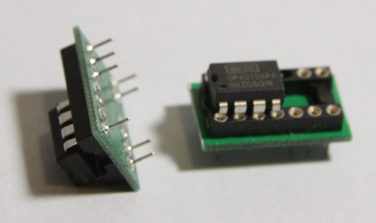

hi dan thanks for the quick answer and info, had the board a bit only just got around to build it, i cant get my head around the piggy back board for the dual amp suppose you havent a pcb overlay for it i could copy thanks for your help
happy new year
dave
---------------Originally posted by angleiron View Posthi dan thanks for the quick answer and info, had the board a bit only just got around to build it, i cant get my head around the piggy back board for the dual amp suppose you havent a pcb overlay for it i could copy thanks for your help
happy new year
dave
Angleiron I recommend that you install a gold plated IC socket for the OP37 amp and build the original Chance as designed. That gold IC socket will allow you to plug in the 2 stage amp later. I can post a PC board layout for the 2 stage amp. Another tip is to install a couple of gold plated socket pins for the clock crystal. I'm now in the process of another mod to allow the Chance PI to sample at under 7us to improve small gold detection. More on this later!
i look forward to hearing about your build.
Dan
Its just a daughter pcb that plugs into the original IC socket on main PCBi cant get my head around the piggy back board for the dual amp
this is not a picture of it, but only to give you the idea.
Quite awhile ago I posted pictures of the daughter board in post #161 of this thread. There are several pix in various stages of completion. The first pic shows six holes larger than the others and these accommodate the socket pins that plug into the original single stage IC socket to achieve the interface from the motherboard. It should be noted that the second offset pot has been eliminated and this will simplify this board a bit.
Dan

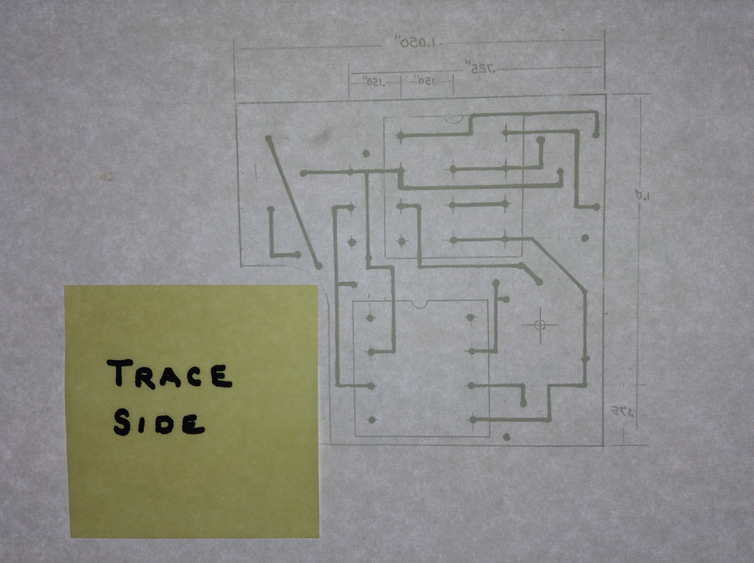

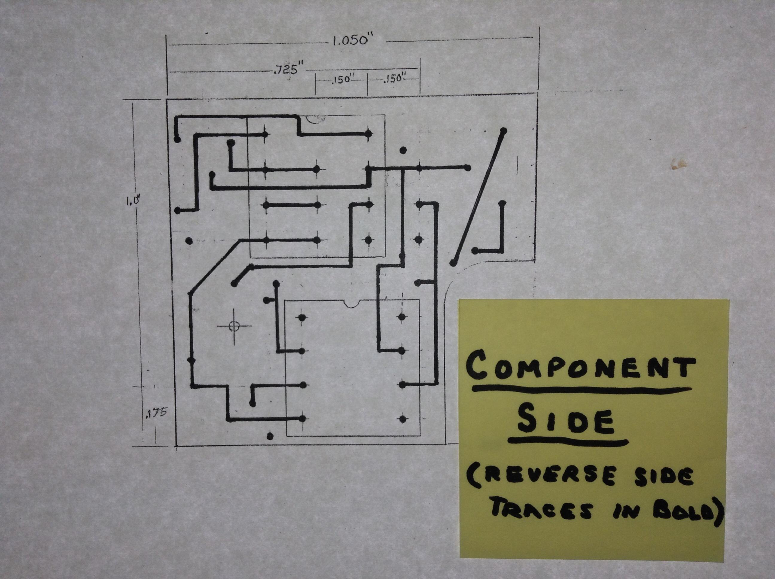

Drawing of the original 2 Stage Amp board
Attached below are two pictures of the 2 Stage Amp PC board layout. The first pic is of the component side of the board with the reverse side traces shown in bold. The second is of the reverse trace side of the board.
I should note that the tab above the cutaway section of the board at the upper right on the component side picture is no longer needed as it was where the second stage offset pot was located. This pot has been eliminated. The board should measure 0.8" wide by 1.025" long with this part removed.
Dan
thanks dan for the traces for the amp board, i am looking at getting a scope, funds are limited, would a pc scope ie(hantek 6022be priced @ 41 pounds on ebay) be goood enough for these projects and able to handle the coil voltages and timings.
