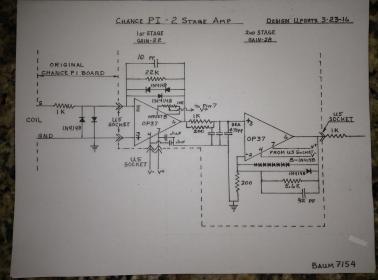

                      • LIMITED-2 STAGE AMP for CHANCE PI - Design Update
                        The attached diagram is the latest revision for the 2 stage Chance PI preamp. It incorporates a lower 166 ohm interstage coupling resistor and the capacitance change to keep the 677 kHz filter value. It is necessary to readjust the 1st stage offset pot for optimum A/D sensitivity and discrimination. For a description of this amp operation see my post #125 in this thread.

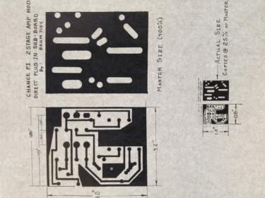

                        • CHANCE PI-2 Stage Amp-Direct Toner Heat Transfer to PCB Mask
                          Attached is my direct heat transfer to PCB mask for the 2 Stage Amp modification. These masks are for the ground plane/component side of the board and for the Trace side of the board. I will be posting complete fabrication of this direct plug in mod/upgrade of the front end amp.

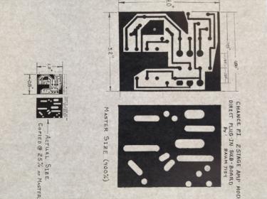

                            • Thx, but bad Quality.
                              if you send me better files i can redraw them with layout Software and from there to pdf or bmp with high res
                              • Thanks Bernt1. What kind of files do you need to do the pdf or the bmp? Post 329 has the traces and post 341 has the latest circuit revisions. Additionally I have the original drilling coordinates I used on the milling machine all in inches.
