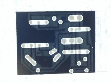

            • Attached here is a picture of the ground plane on the component side with the tracks of the trace side 'ghosted in'. This shows the relationship between the two sides. This board is 0.8" X 1.0"
              Dan

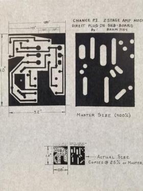

              • JPEG of 2 STAGE AMP direct heat transfer PC board masks
                Attached below is a PDF of the scanned artwork mask for iron-on heat transfer to a .8" X 1.0" double sided PC board. When completed this will result in a direct plug in 2 stage amp for the CHANCE PI detector. The larger images in the PDF can be sized to 3.2"X4.0" and can be printed at 25% to yield the 0.8" X 1.0" size.
                2stageampmasks.pdf
                Dan
                • Hello Dan,
                  i am back from Mallorca some hours ago. Files you´ve attached seems correctly that what i need to reproduce a pcb with software.
                  Big Thanks. I will redraw this and when finished i upload my sprint layout files and gerber, pdf...
                  best regards
                  Bernd

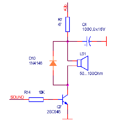

                    • Chance PI D10 Value.
                      Can anyone tell me the value for D10 on the latest Chance PI boards. It does not appear to be on the Schematic or in the parts list.
                      Cheers.
                      • Originally posted by Borisimo View Post
                        Cheers.
                        From Andy's site it is a 4148
                        • Cheers 6666,
                          Thanks for the rapid response. Is the Andy f site considered the best and most up to date 'build and test documentation' for this project?
                          Thanks.
