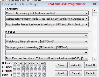

                      • I am a beginner programming microcontrollers.
                        I have programmed the chip (Atmega8-16PU) with the programmer usbasp and khazama Avr. Now is the problem of recording the fuses on the chip and I'm afraid because long ago I managed to leave another chip as a brick.
                        Can someone help me and tell me what I have to do in this window?

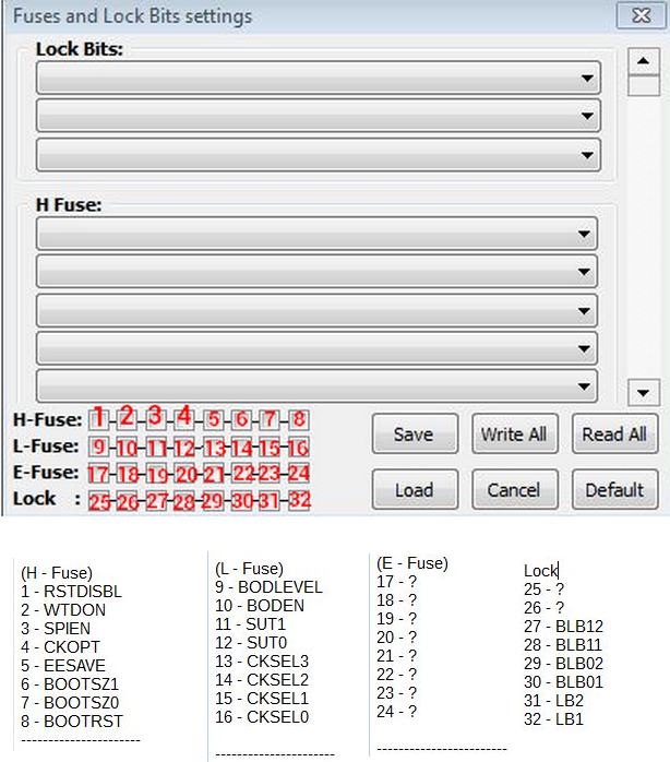

                        We have to take into account what a forero says in post number 89.
                        "But please pay attention for fuses because for Khazma checked bits = 1 but on Chance website with Ponyprog screenshot it has checked bits = 0
                        So INVERT ALL FUSE BITS or Ooooopppssss .... Atmega8 Bricked ..... "
                        Two days with this, anyway. I hope someone can help me.
                        Attached the photo. What numbers do I have to select? Thank you very much.
Name:	fuses khazama Chance pi.JPG
                        • I use burnomat for this, never fail me, dont use fuse from anywhere except from the author, yesterday i try to use fuse to follow the latest dantech firmware for atmega8 and bricked my at8.

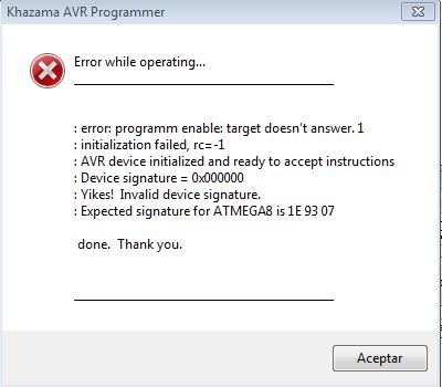

                          • I got my second ladridllo, soon enough I have enough for a house.
                            I think I've selected the fuses well and now I can not access the chip.
                            Written this way
Name:	Fuses khazama.JPG
                            Message trying to read the chip.
Name:	message khazama.JPG
                            The .hex I have programmed before and although I can no longer access the chip.
                            Will the chip work on the detector?
                            • Try it, if it show on the display then its work
