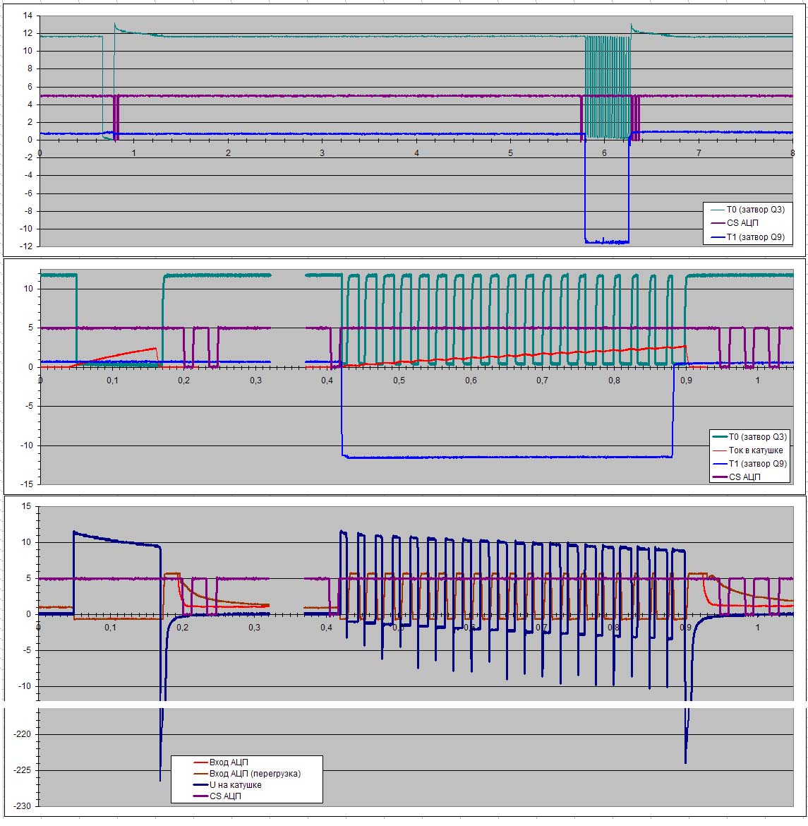

            • [QUOTE=dantech;221417]I shall read this thread more carefully again.
              Facts from code below:
              1. 16 pulses acts only in the even cycle. During entire even cycle Q9 is closed and coil does not transmit entire power. So I do not thing that Q9 circuit + PWM makes something useful.
              At the moment I switched off PWM and use one pulse only. I do not see any difference in the field. Fandy told me in the past that Q9 circuit does not work in fact.
              Q9 can be closed during the entire even cycle as you say because diode D6 conducts only in the fly back polarity which is the opposite polarity of the transmit pulse polarity.
              Dan
              • I do not think so.
                Notice that the even cycle has 16 PWM pulses but Q9 is switched on during 15 pulses only. In that phase (Q9 is on - additional damping)
                coil current grows but without generating pulse.
                In the last 16th PWM pulse Q9 is opened (the coil is not additionally damped) , the coil current stops growing and then when coil is switched off the pulse is generated.
                So, main condition to generate pulse is Q9 switched off. When Q9 is switched on there is no pulse but the coil current growth only.
                More or less...
                It looks like some power pump. I have checked total power consumption and despite the entire even PWM cycle takes nearly 600us the power consumption
                is the same as only one 240us pulse instead of mentioned PWM! It seems that the PWM solution allows to reach higher coil current without excessive power
                consumption!
                But in fact I do not see any advantage during the detector work in the field. Opposite, I see some VDI instability with PWM solution.
                Of course I can be wrong

                • [QUOTE=dantech;221444]I do not think so.
                  More or less...
                  consumption
                  dantech ,
                  We are saying the same thing with one exception, Q9 is not 'damping' the coil. Because it is shorting the coil it is keeping (storing) the energy in the coil. Damping is the opposite action of causing the coil to release its energy more quickly. It makes sense that Q9 is not on when flyback is intended and it is then that the damping resistors R13 & R16 in combination do their job of coil damping. This is why optimizing the value of R13 is so important in getting the coil to release energy as rapidly as possible in order to detect small/fast targets especially at sample delays below 10us.
                  Dan
                  • Here are timings from v84. Ones are quite similar to v121 timings (no prepulses and 20 PWM pulses instead of 16 ones)
                    Look onto the coil current growth during the even cycle.
                    Like I said earlier, Fandy has told me that PWM solution does not work.
                    My tests in the field confirm it.
                    Regarding the word "damping".
                    Probably it is question of translation. From my point of wiev the word "damping" means "attenuation" or even "shortening" in some cases.
                    • Dantech
                      We agree. So the PWM is now eliminated but the fixed width pulses still remain. I appreciate the information you are providing through your insight into the original firmware
                      Thanks,
                      Dan
