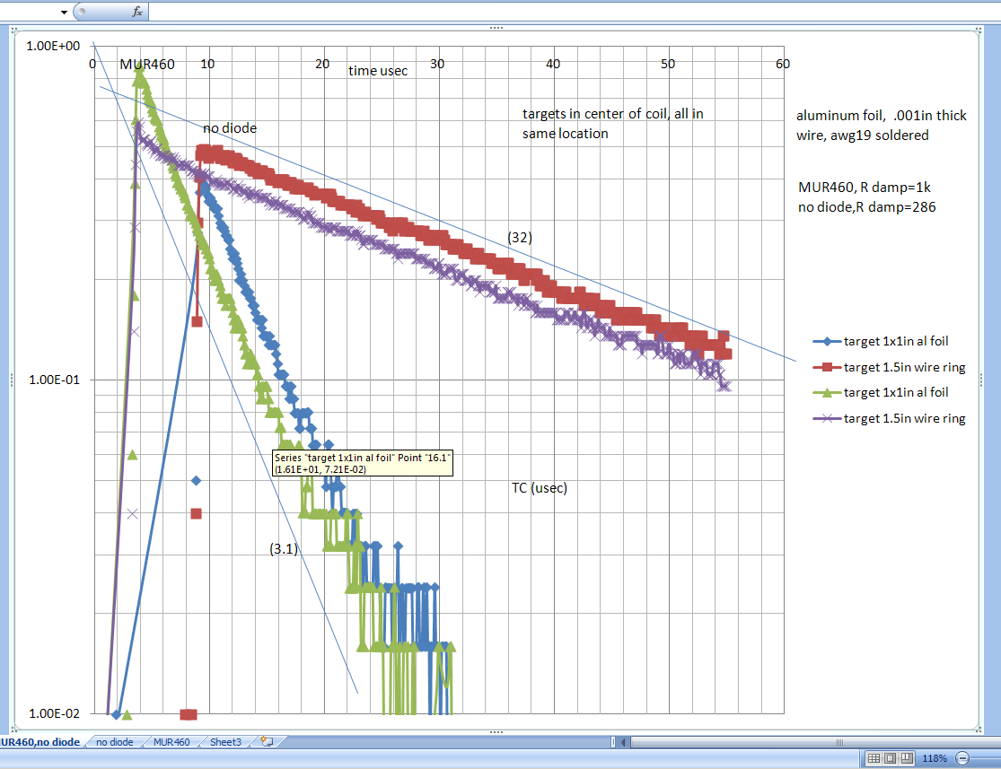

                          • A chart I posted in another thread awhile back. The diode allows sampling sooner. The diode drop caused less peak current so the signal was less. Tx time could be increased for same peak current with the diode. The diode may cause more or less peak current drop with the Chance circuit. I wasn't thinking about the diode drop causing a problem before I ran the test. With the same peak current sampling sooner makes a difference with the 3usec TC target not the longer TC target.

                              OK. I have restored D4 . I use UF4007. One has 25pF instead of 75pF (MUR460)
                              • Green, do you recall the TC of the 6mm square of AL can sidewall? Was it the 3us or even shorter?
