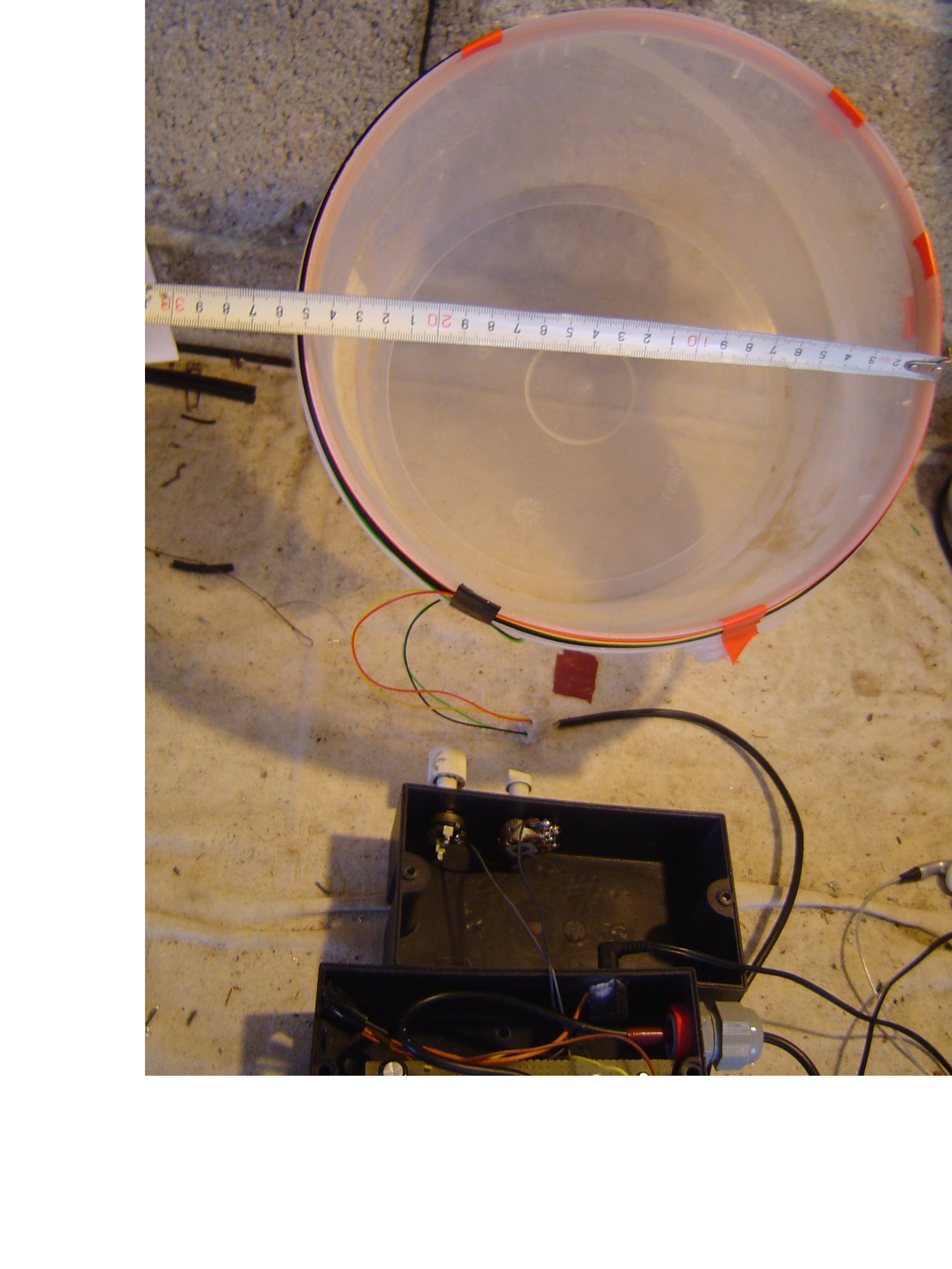

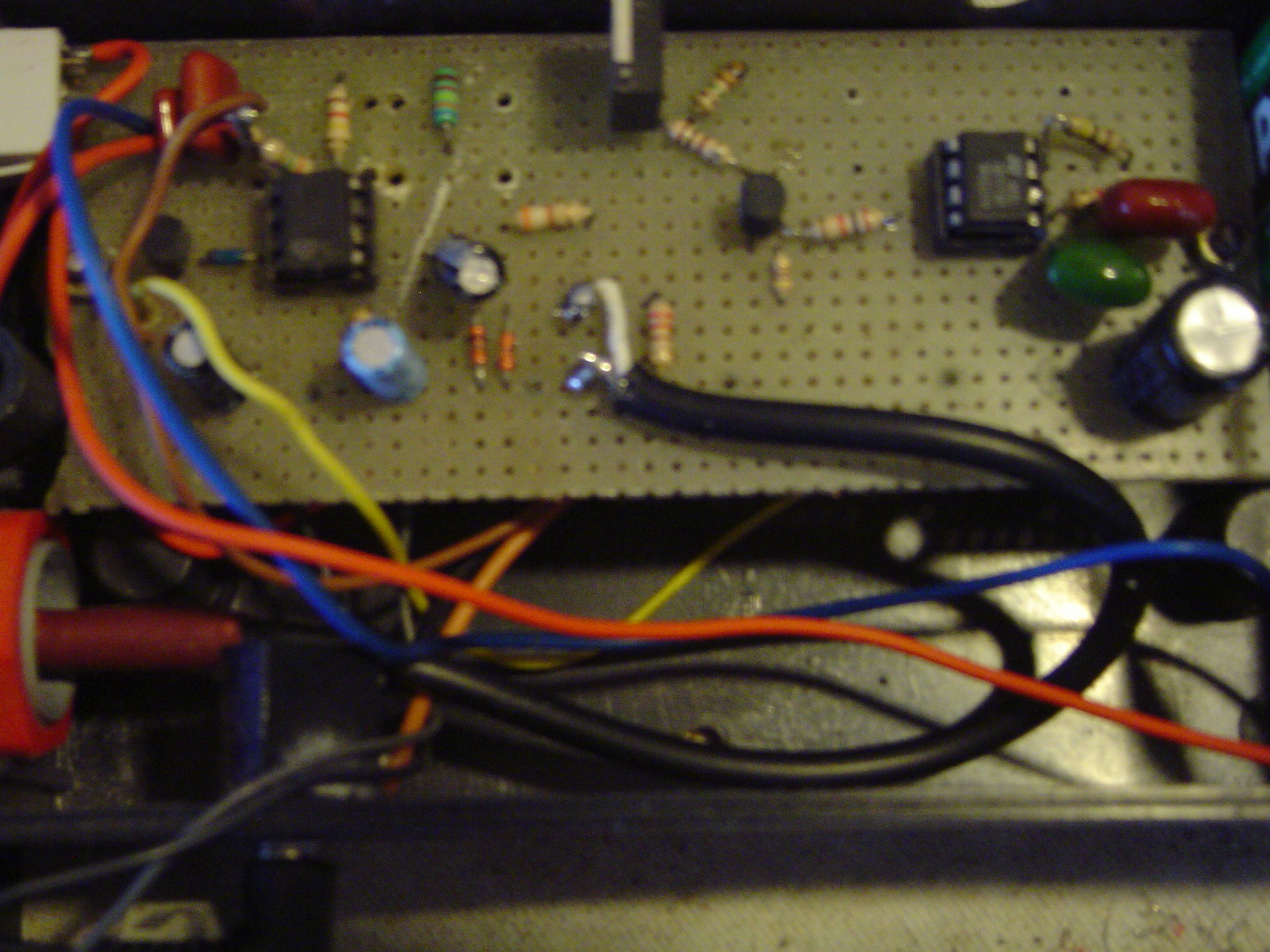

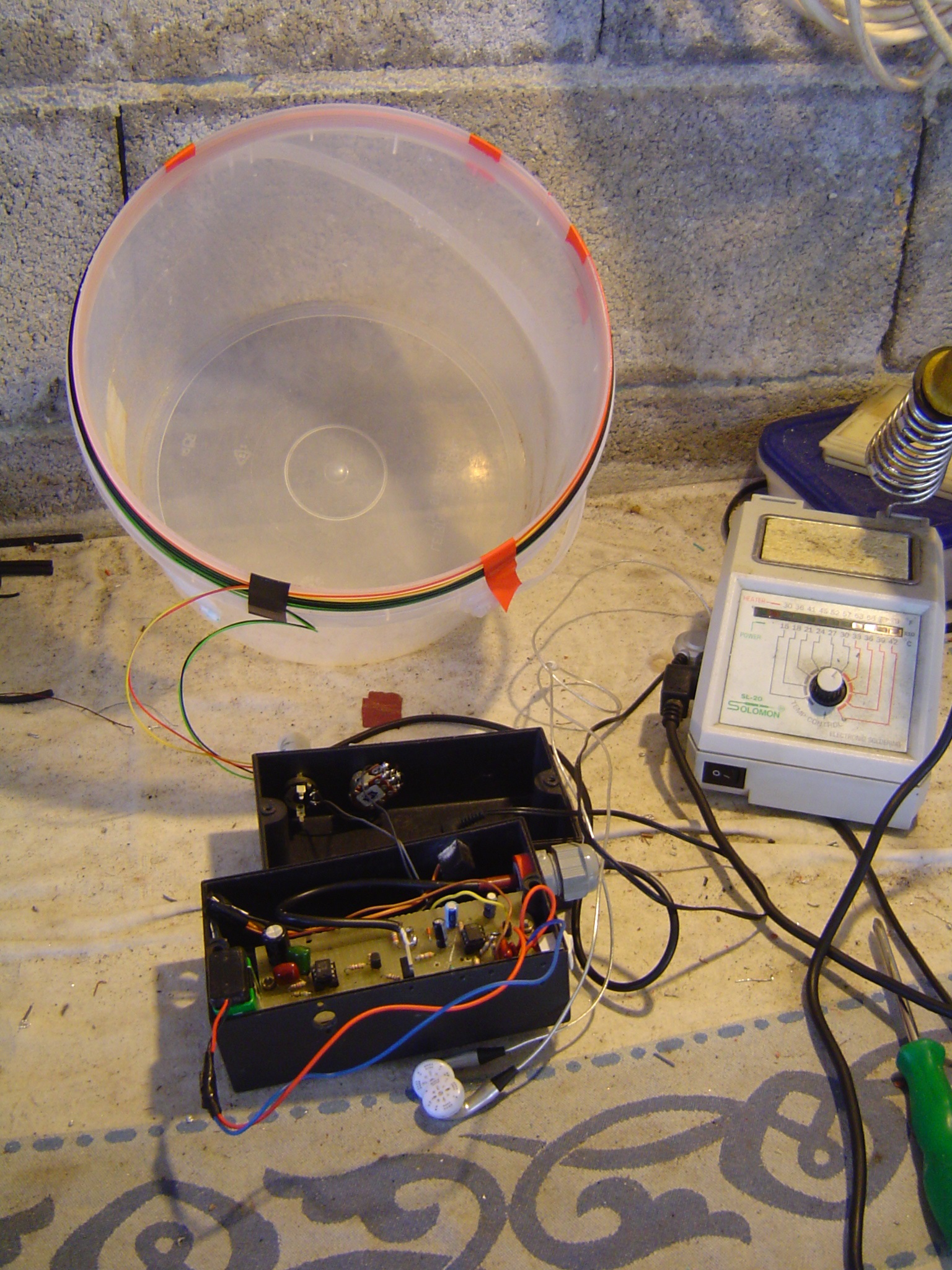

  • []24323[/ATTACH]
    • here are some pics
      will later by more
      thank you all
      • Interesting solution.
        Did you try to put water in your plastic-container-coil and detect something underwater?
        • No, the container only has the needed measures to make the coil. It was the easiest I found.
          • So did I
            • Titus
              I'm very confused with your coil... :/ ...
              you use 4 wires: black. green, yellow and orange?? How is this???
              You have a youtube channel???
              Can you show details of coil??
              Thanks.
              • good night
                are only 4 wires that I joined to make long
                4 wire 12 meters, with diametro.3mm
                the two together, of which: two wires 24 meters
                By the end of 1 24 meters with wire .6 mm Excuse the bad English
                thank you
