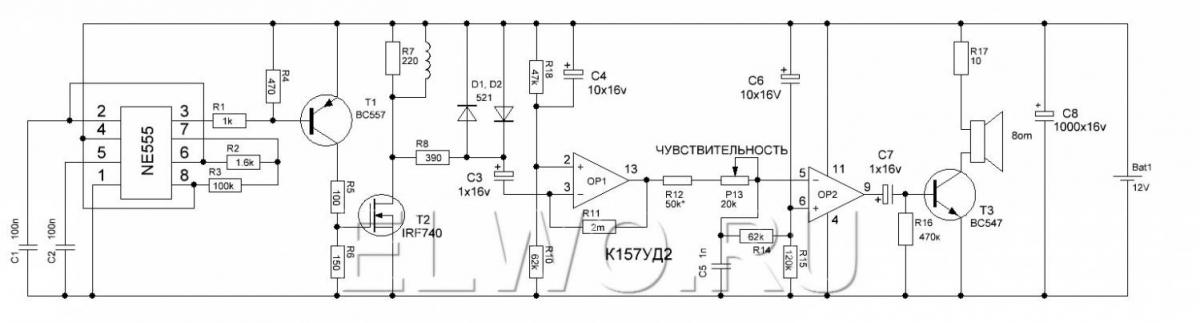

      The original scheme of Eddy http://www.geotech1.com/forums/attac...5&d=1358762518
      and after consultation here on the forum, I threw out part of the transistor, and made directly manage IRF740, exactly along the lines of "surf pi" scheme.
      I think someone checked in the simulator "ltspice" that has the same characteristics as originlna scheme.
      I made its the test plate, but it worked very poorly, only to 10cm max, so I gave up to study why not, because I do not have sufficient knowledge in electronics that I find out what the problem was.
      It would be extremely nice to someone who is perceived, and there is a will, that the model of the Eddy PI, do indeed Simplest PI, which will run from the first.

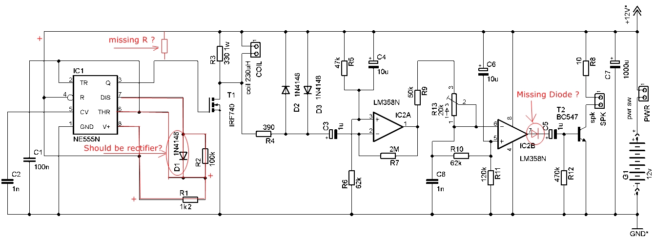

            • It looks like R1 should go to pin 7...

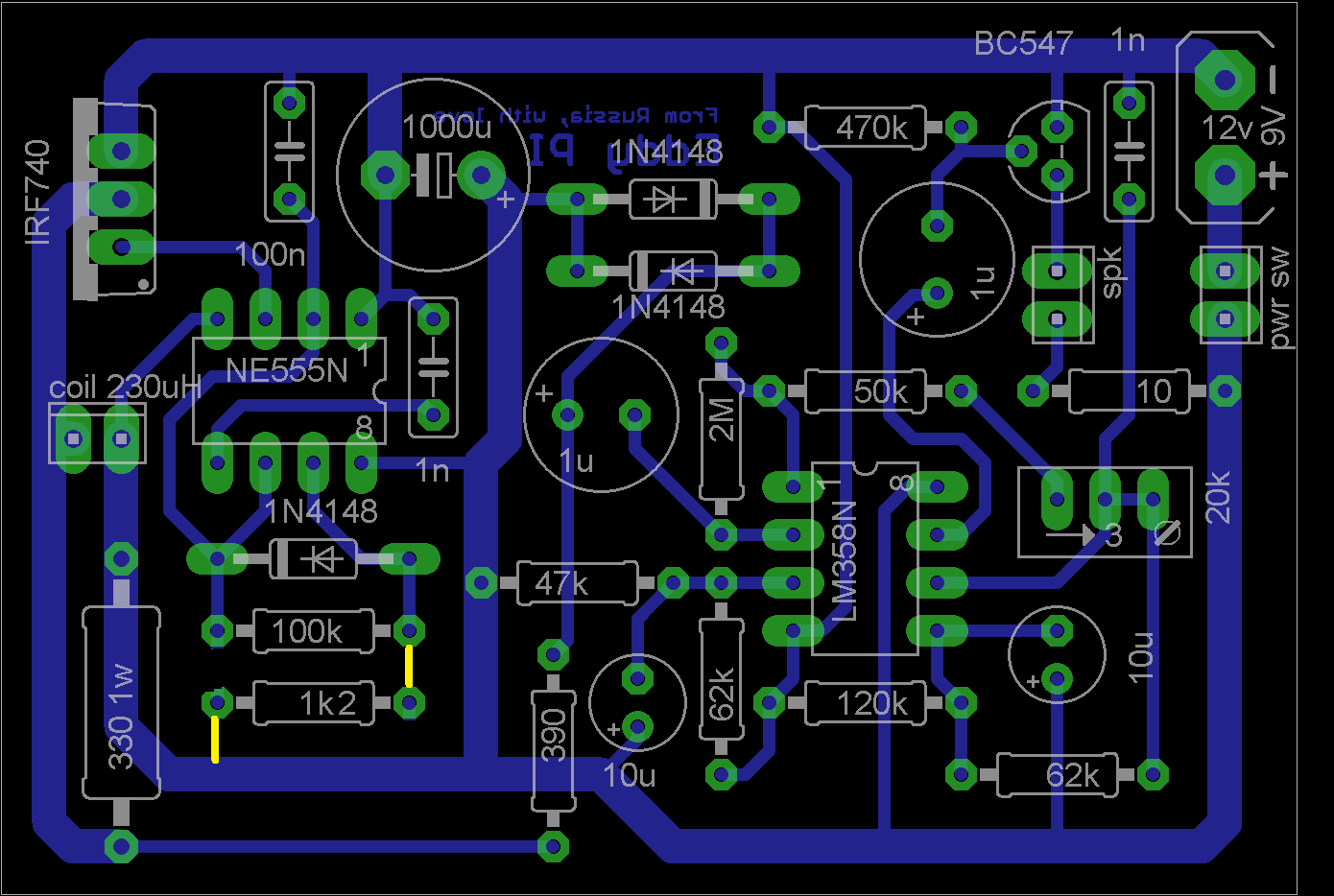

              • Here's the new layout;
                • checking everything
                  Silver Dollar, It looks like R1 goes to pin 7 in a round about way based on the schematic but not to sure if its correct or not.
                  Since I reversed R1 and R2 and it got hot quickly, as you mentioned it is working since that changed the TX so it
                  must be something else around the 555 which maybe could be how R1 is connected, just not to sure as my knowledge
                  isn't up to par with some of you guys.
                  I have a ton of data and books on the 555 and their circuits, I'll research it a little today while wifey is in the pre op.
                  Read last night that a signal diode (4148 ) isn't good enough on a 555 circuit like this and that it should be a rectifier
                  diode 1N4001 so I'll swap that too and see what happens with it.

                  • I fixed R1 on my board and now have a good TX. The pulses are 125us wide and happen at 7.3 ms intervals for
                    a 1.7% duty cycle so there should be low power in the FET and coil. I did use a 1.5K for R1.
                    Try moving R1 to pin 7 and I'll bet it works better. Now to finish wiring the circuit...

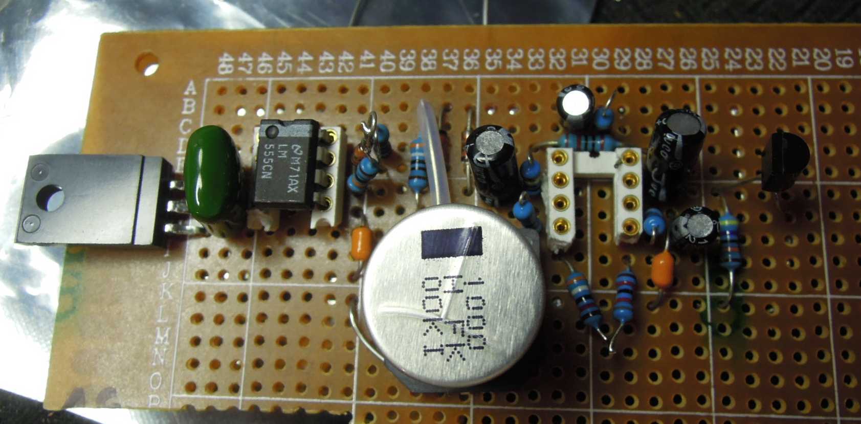

                    • Well here's my build. I substituted a few parts because of availability. Anyone know how much voltage
                      to expect on the coil (don't want to burn the scope up!). I'll try firing it up tomorrow...
                      • That was it silver Dollar, I swapped ends on R1 and attached as you show and BAM, it works.... I knew it was something
                        simple, just wasn't seeing it.. Good to have fresh eyes and a clear mind check things out, appreciated...
                        Not a super detector but it works and detects a us quarter at 1-1/2 inches and a standard pair of pliers at 3 inches in air
                        on the bench. The tests were done with multiple coils, from 300uH up to 550uH with approx same result, the 330uH coil seemed to be best
                        as far as sensitivity and air test depth at max 3 inches.
                        I was thinking I will add a couple pots for some adjustability with the timing to see if there is a sweet spot
                        somewhere. I will be swapping the mpsa13 for a bc547 today to see what if any kind of difference it makes.
                        Will see what this little board can do with some substitutions and a little thought, I will continue messing with it
                        and making changes here and there.
                        Big Thanks to Silver Dollar for the help and with spotting the wrong connection on R1.

                            • geoscash1,
                              Here PCB to bite into acid. I fixed also R1 and replaced it with a potentiometer as shown in your video.
