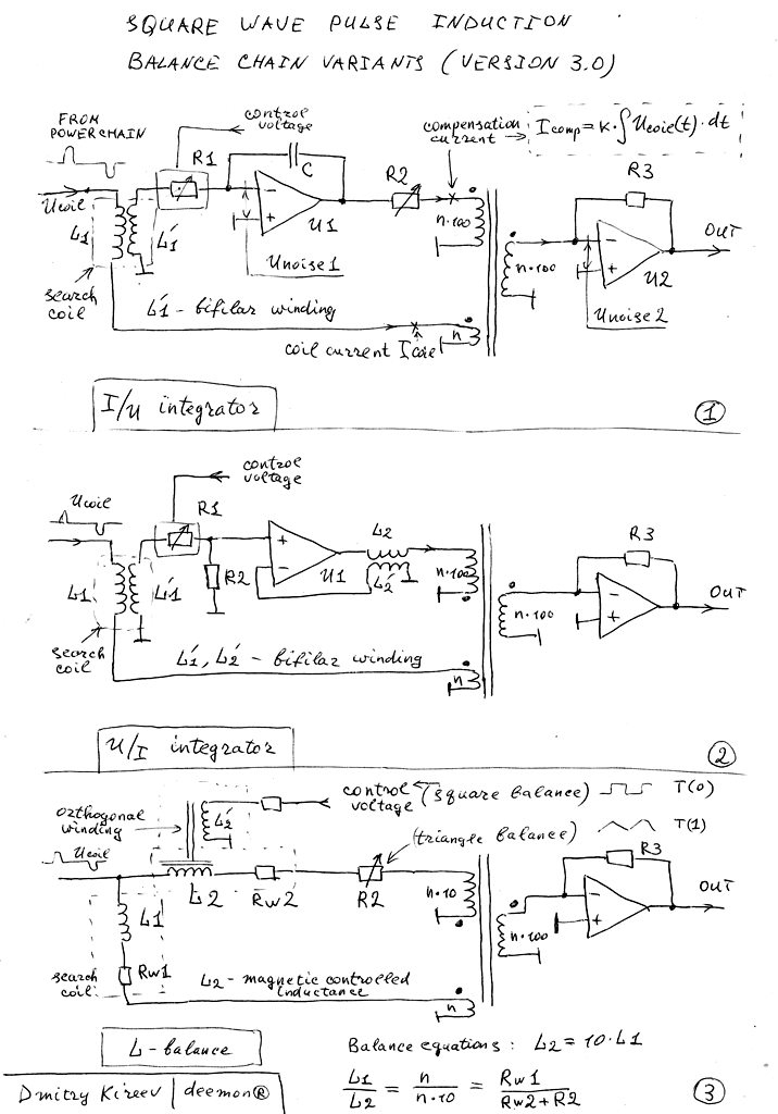

As we can easily see on the picture , the compensation output signal goes to the current trans via the variable resistor R2 , connected to the coil winding with the same turn number that output winding does have . So the compensation signal is "virtually connected" just on the U2 (-) input , where the negative feedback resistor R3 goes too . So , now we have an "unwanted" R-divider in the feedback loop ( R3/R2 ) , and the whole circuit begins to amplify the noise voltage of our integrator U1 ( Unoise1 on the circuit ) by the ratio of this divider , in practice it was about 10 .... of course it's bad . But we have even more trouble - the noise voltage of the U2 amp ( Unoise2 ) does have the same amplification
) .... but anyhow it does exactly what I need - it takes the voltage and gives the current , so I don't need to convert it on the resistor and can supply it directly to the current transformer compensation winding . The situation seems to be better here - because we don't have a resistor ( and this integrator has a current-source output property ) we don't have any amplification of the U2 noise ..... but with the U1 noise the situation is worse . Its input noise is just applied to the L2 , being converted to an output current just like a signal does , so we already have its noise amplification on the output of the circuit . It can be clear when we calculate the real values of the parts of the signal path
) - but what can I use here for the coil ?
