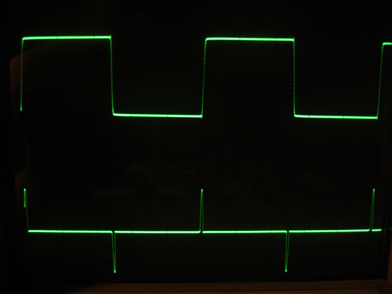

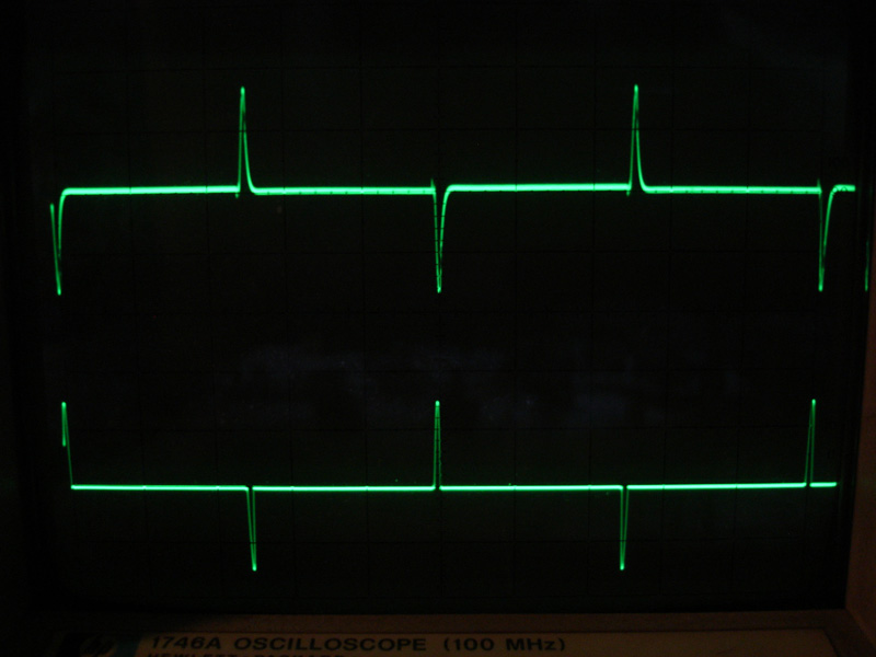

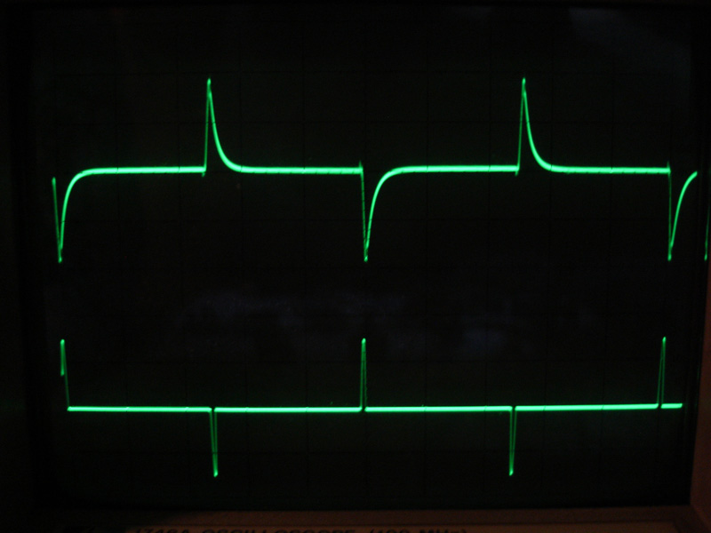

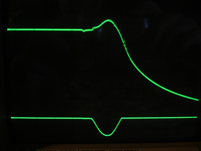

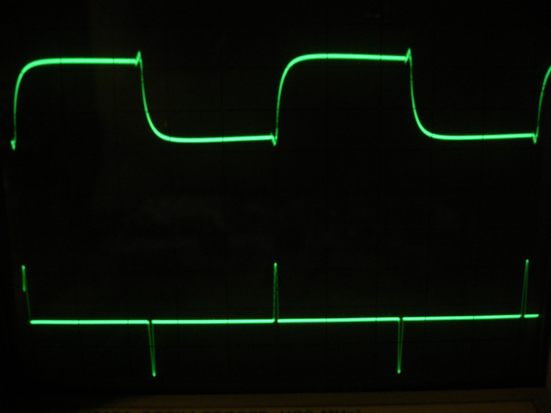

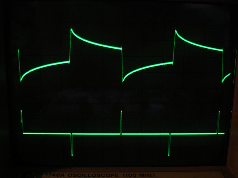

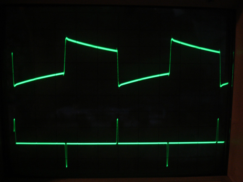

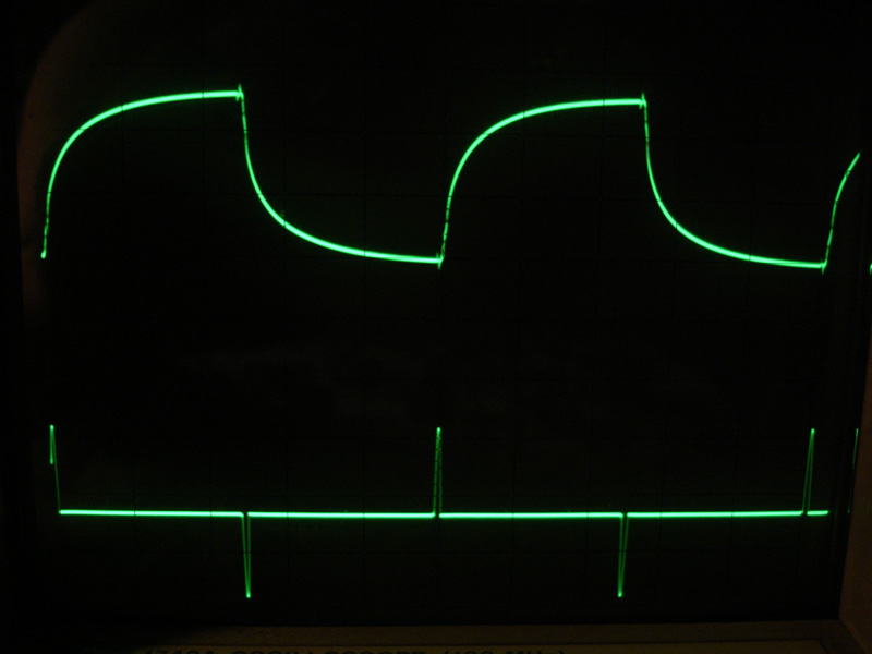

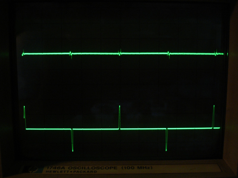

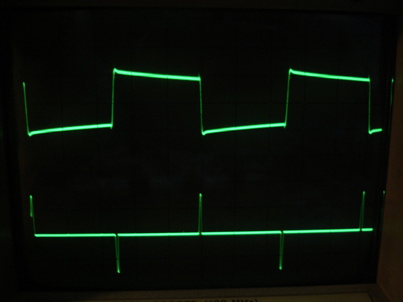

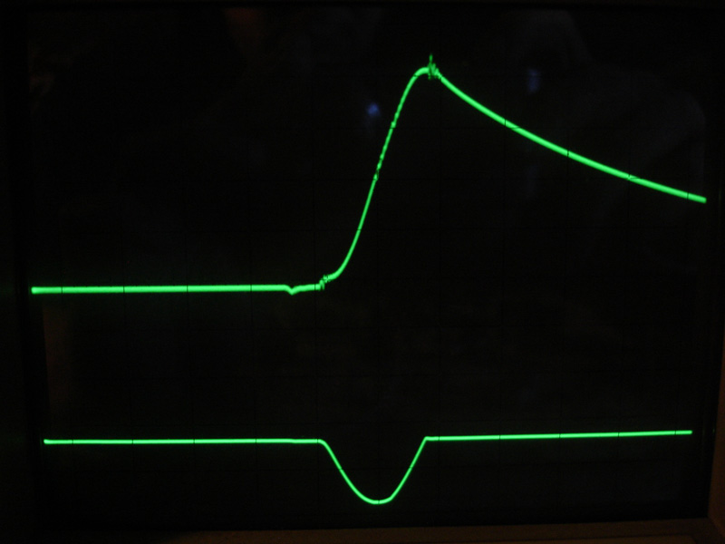

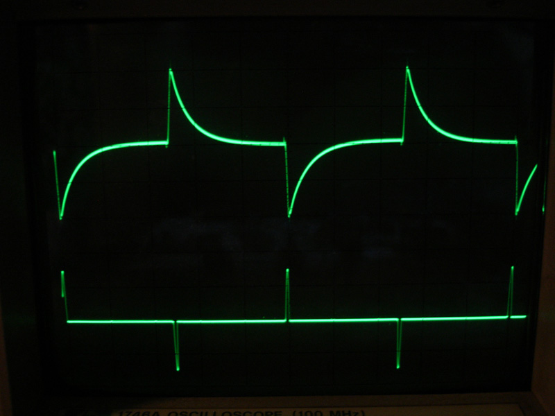

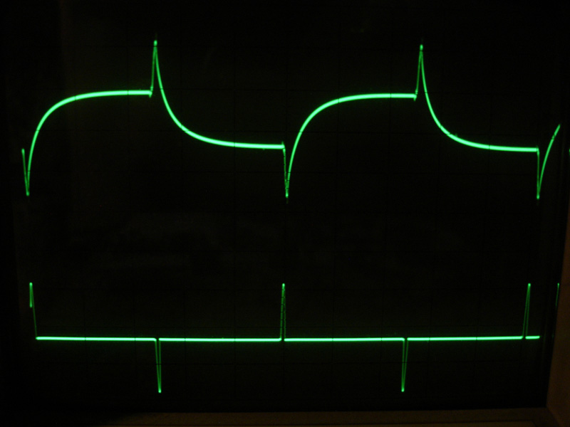

I took some photos of the signals from the different ferro and non-ferro targets - I will upload them today ....

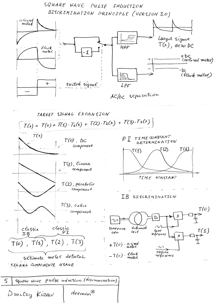

Our system is bipolar , so the target response does present in the both half-periods in the opposite polarity , and the first thing that we must do is to "rectify" them - I mean that we need to invert every odd half-period pulse on the preamp output , in order to transform our signal to the unipolar shape . We can do it easily , using the inverting stage ( op-amp based ) and the simple CMOS switch - as shown on the upper block diagram on the picture . After doing this we'll find that the signals has two main components - AC and DC . As we can see from the picture - DC component gives us a very useful information ( that absent in the classic PI devices ) , whether the metal target is colored or black . But why we are able to get it here ? It's just because our system is balanced and we can transmit and receive at the same time ( like we do in IB devices ) , so while the black target increases the coil inductance , the colored target does the opposite thing - it decreases inductance , and they produces the opposite polarity of the unbalanced signal . And when we apply the signal to our "full-wave active rectifier" - we are transforming this unbalance signal polarity to the DC component , that can be measured and analyzed for the black/colored ( ferro/non-ferro ) discrimination purpose . So we can see that our system behaves here just like the IB system , and can do the same things .... but with mono-coil search head - it's a substantial advantage
And this is why my new device can do the thing that previous one couldn't - I mean the ferro/non-ferro metals discrimination . Previous device , being closer to a classic PI - ignores this DC component ( that depends on the immediate reaction on the coil current and can be obtained only by transmit and receive at the same time , the thing that my old device cannot do ) . In another words , this new coil balancing technique allows us to obtain ALL the target information in one device , using the mono-coil search head .
. As I had shown before , if we excite the target with this square wave pulse train - we can obtain the same exponential decaying target response as we can get from a well familiar PI device . And what can those devices do ? In the simplest PI machines ( with one sample pulse ) we can operate only in the "all-metal" mode , and cannot determine both the metal type ( ferric and non-ferric ) and the target TC too . When we add more samples , we can measure target TC more or less precisely , but a ferro-discrimination is still impossible . Using my terminology , I can say that those devices can utilize only the "highest" terms in the Taylor series of the target response function ( T(1)-T(3) ) , but without T(0) . If we take into account the fact that this T(0) signal depends on magnetic permeability of the objects near the coil ( as I explained before ) - we can easily understand why all PI machines does have a good "ground tolerance" . It's just because the ground has a ferromagnetic properties and might give a most strong reaction on the T(0) signal . But if the metal detector cannot receive it - it has very weak reaction to the ground , of course . And we must notice that the simplest PI device cannot separate T(1)-T(3) terms , receiving them "in general" , receiving only the sum of them , more or less effectively , and this is why they cannot distinguish a big piece of metal from the little one . But my new circuit ( VERSION 3.0 ) can do this and it can obtain the T(0) term also , so it can do the thing that PI device with mono-coil never did - I mean ferro-discrimination function . In another words , I can say that my device "includes" PI principle in it and all PI devices are a kind of "subset" of my device . It's become obvious if I "cut" my circuit , I can get a simple PI device with "all-metal" operation ( VERSION 1.0) , or a more complicated VERSION 2.0 ( see a block diagram in the post 29 of the topic ) , being equal to a PI device with a TC measuring possibility . And we can easily see that 1.0 version receives all the exponential decay in general ( as I explained in the post 34 ) , and the 2.0 version can "disassemble" this function and analyze its parts , measuring the target TC .
In order to make it more clear we must make a simple "mental experiment" . Just imagine that we add a narrow-band filter in my signal chain after the preamp stage . Everybody knows that a square wave signal can be presented as a sum of a harmonic frequencies with odd numbers . For example , if my device works at 1 khz PRR - it actually transmits on air a number of sine waves - 1 khz , 3 khz , 5 khz , and so on ... and all the transmitted frequencies being received and used in the correlation algorithm . But if we install a filter , tuned on the fundamental frequency ( 1 khz ) in the receiver signal chain - we'll cut all the higher harmonics and leave only the 1 khz sine wave in the receiver , and the result would be the same as we'd transmit ( and receive ) only this frequency , like IB devices usually does . And what we'll have on the our demodulator channels ? In the classic IB we transmit the sinewave , and receive the target response - the same sinewave but with the phase shift , caused by the target . But how we can measure this phase shift ? We use a pair of synchronous detectors ( analog multipliers ) with low-pass filters on the out . In fact , they are the same correlators that I use in my circuit . And on the reference input of the first multiplier we send the sine signal ( in phase with the transmitter wave ) , and on the second multiplier reference input - we send the cosine signal , having a 90 degree phase shift with the transmitter wave . By the way , this cosine function is an integral of the sine function on the first channel reference . And the output signals of those multipliers ( correlators ) we usually call I and Q signal ( in phase and quad phase ) .... but in metal detectors we usually call them X and R signals . X signal is proportional to the "instant reaction" of the objects , without any phase shift - it depends of the target ( ground ) magnetic permeability , and R signal is proportional to the "shifted reaction" , due to the eddy currents in the target . And further we can use both signals for the discrimination purpose . Polarity of the X signal can show whether the metal is black or colored ( ferro-discrimination ) , and X/R ratio can show the phase angle of the target signal , depending on its time constant ( TC ) .
