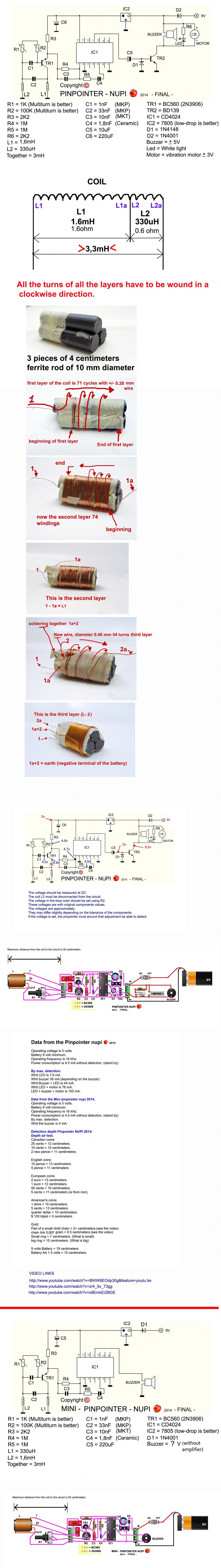

Can pinpointer detecting thin chain?
  • Sorry, NOT parallel but in sequence with R1
    • Hi Nupi.
      With a 100k resistor constantly beeped all the way of VR2. I tried lower values and with 56k beeping stopped, but it works "backwards" as before
      • *************** PP - UPDATE ****************
        • Put 2 from 100K or 3 en try
          • mistake
            • I put two 100k and then a 330k resistor in series with VR1, and always beeps continuously.
              • What is the value of C2?
                • Is 33nf. I tried with lower and higher values ​​and only the sound and the engine speed was changed, but kept running backwards.
                  • Does your ohmmeter do good '??
                    What I do not understand is the high resistance of the coil?
                    What kind of wire you use for coil and what are the dimensions of the coil?
                    Another question, can you measure the inductance of the coil again?

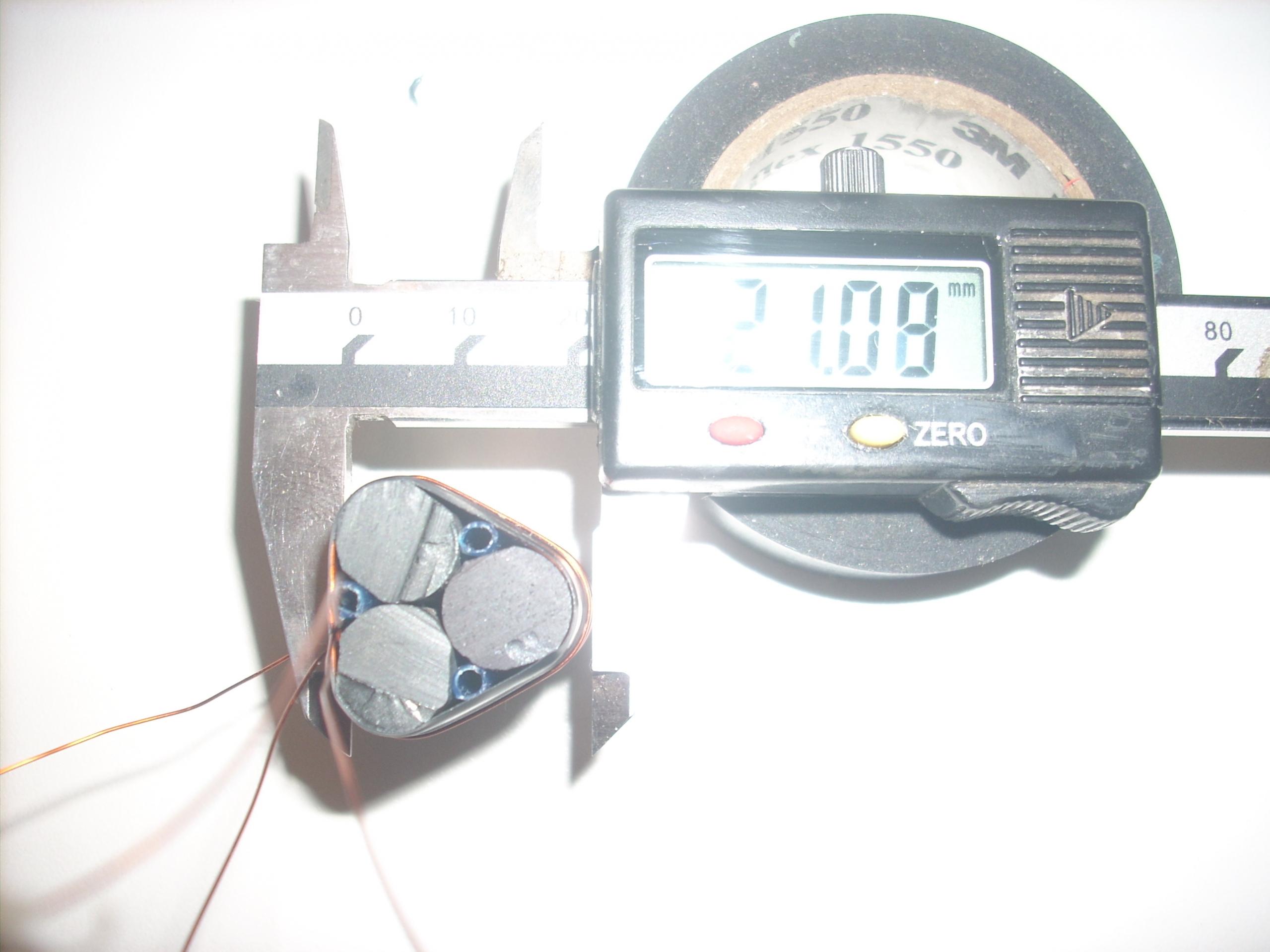

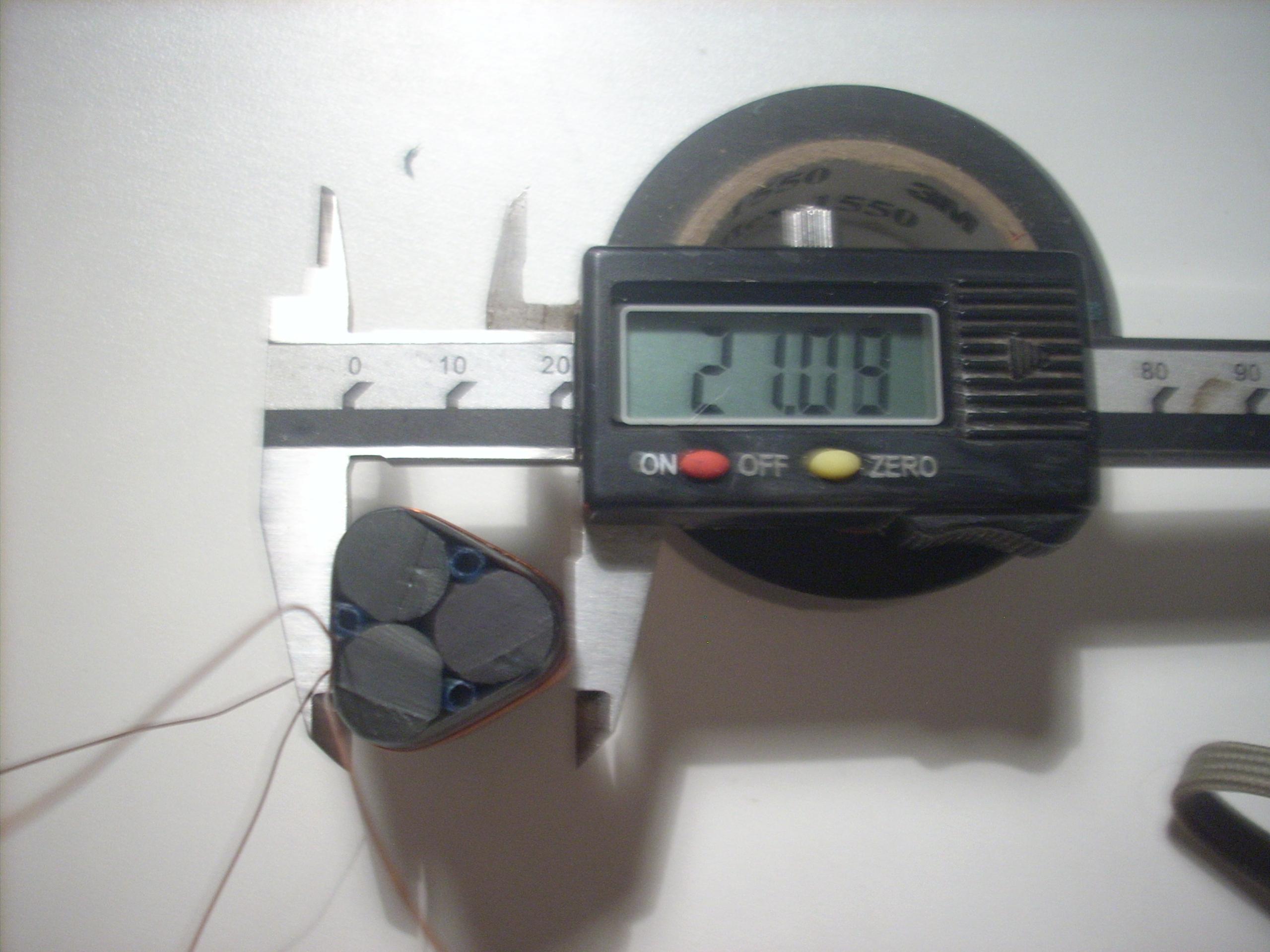

                      In this one, my last coil, I use .32mm and .35mm wire gauge (L1 and L2)
                      Dimentions in the pictures
                      • That the wires are not the same as mine is not the problem.
                        The coil looks perfect.
