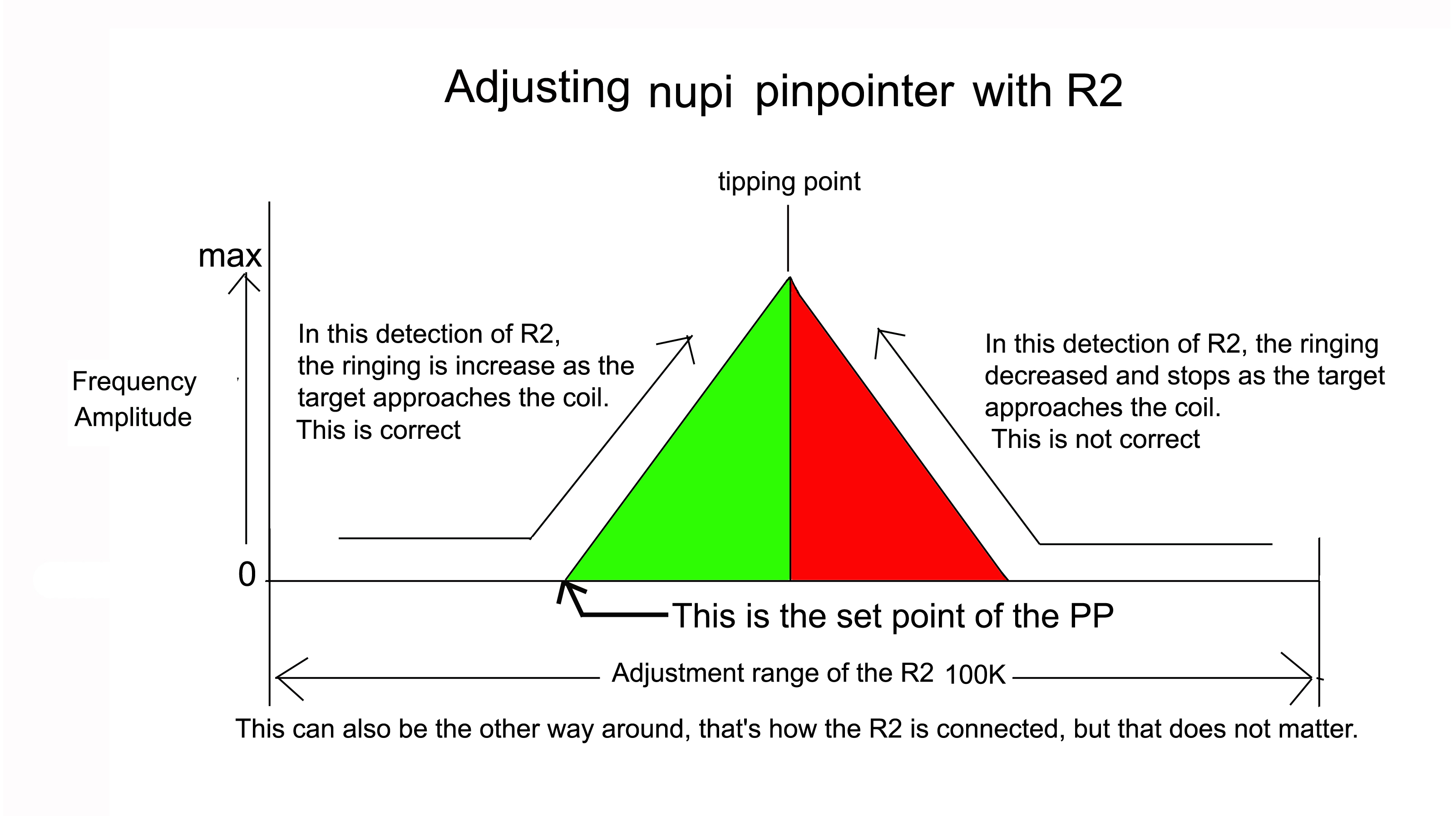

  • Adjusting the PP.
Name:	Adjusting the pinpointr..jpg
    • Hello Nupi. I was working on the PP during the weekend, and I could not find a solution. I wrapped several coils, triple-core and single core (15mm ferrite) and the result was the same. I changed ALL components, including the BD139, the 4024, all capacitors ...
      I will build a new PP, but I read this post by Davor and wondering if has something to do:
      "I'd say your Q factor is too good. No kidding. This oscillator is very touchy on the coil Q and transistor gain, so the trimmer may not compensate if both are too good. You may try 100k in series with a trimmer, or you may go for a lower frequency by increasing the tank capacitance."
      I already tried putting a 470K trimmer in series with R1 and did not work well... Can the problem be related to the transistor? Maybe put a transistor of other features, or something. I put a 2N3906 but it works just like the BC560.
      If not, I'll build another PP on a perf board as Nezocas and you did. (Can PCB tracks influence the performance of PP?)
      Fabián

        • Hi Gary, thanks for your reply. I have no problems with the operation, unless my PP runs "backwards" (stop ringing when I approach a coin into the coil) and I can not "straighten" the operation of the detector. From what I can measure the inductance of my coils is correct. Just resistance is a bit high compared to that achieved by Nupi.

            Runs Backwards: INCREASE the Value of the LARGER POT to give More Range of adjustment.

              Hi, Fabian
              What Davor says that is not related because We have already done with the resistors in series with R1.
              How did you get the coil wound?
              Are the layers of tight turns on each other or have a lot of
              insulation between layers? In that case you have too much capcity between the windings.
              Experiment with C2 with smaller values ​​or try without C2.
              regards, nupi
              • Thank you both for your answers. I will implement its recommendations.
                Nupi: Yesterday I made the coils with each turn very close to each other. I also tried with lower values ​​in C2, and even took it off. He continued working "backwards"; just the frequency changed.
                But do not worry, I will make a new board. I do this as a hobby, and as you Nupi, I have a lot of patience ...
                Fabian

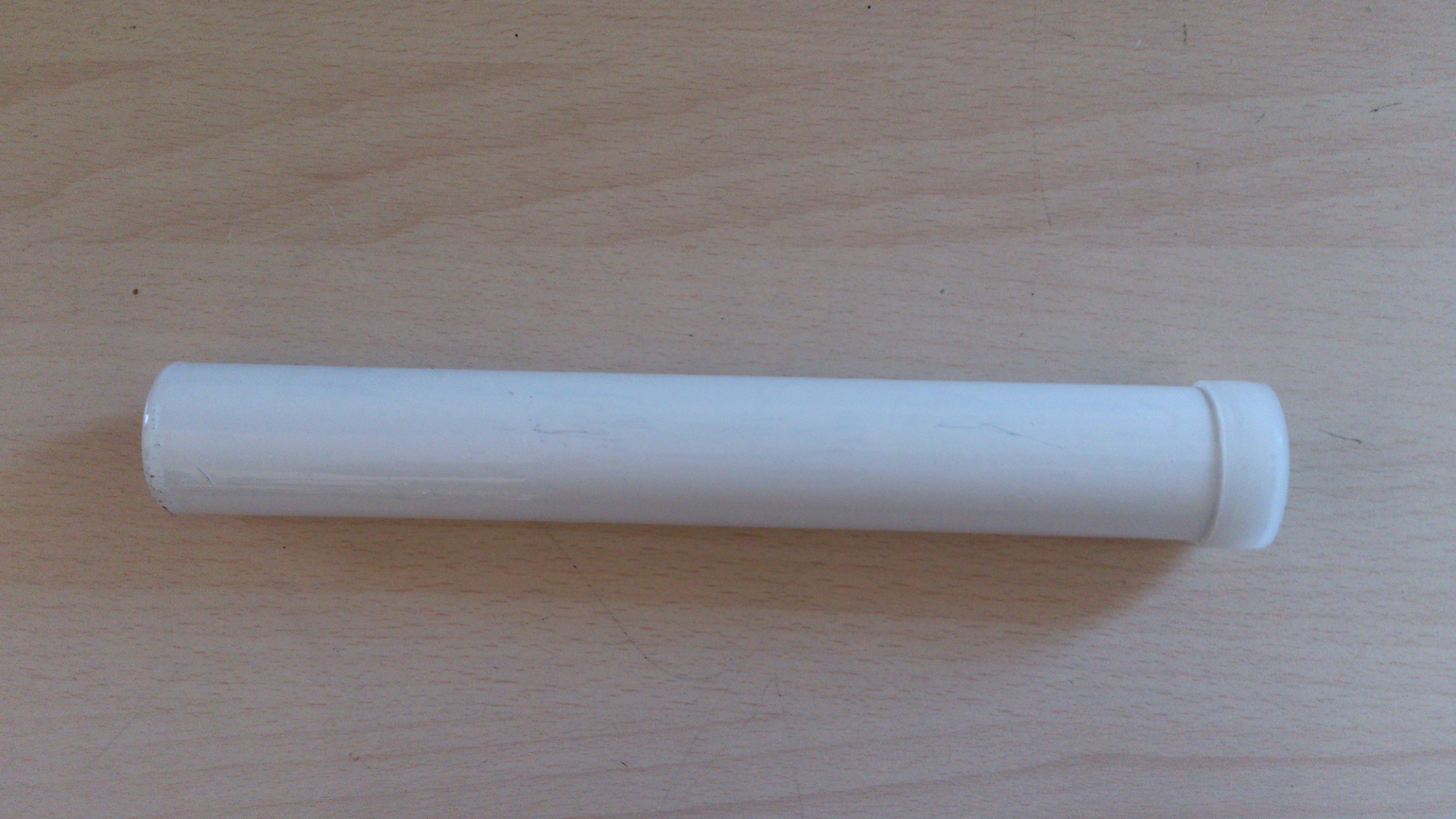

                  • Hi,
                    Finally I had some time to finish the NUPI Pinpointer.
                    It ended up with a 21.5 cm long "tube" and with 3 cm in diameter.
                    It is fully water proof, this was all ready tested, I placed it at the bottom of a 3 meter depth swimming poll for a complete day, without no batteries inside.
                    I upgraded it with a reed-switch to power it on and off with a small neomagnet.
                    It is very stable and does not looses detection range for long periods.
                    When whether gets warmer it will be tested underwater at the beach hopefully finding some rings.
                    Lets see how it behaves in salt water.
                    I made a small video (turn volume up a bit) because this PP only have the vibrating motor on it.
                    http://youtu.be/OvG9h2lsELU
                    I didnt atchived the 11 cm´s detection to an european 5 cents piece (only 7.5 cm), because if I tune it up a bit the PP gets very "nervous" .... but I am very pleased with it.
                    In the past I wanted to buy the Vibraprobe or the Vibratector, but they are both up to 200€ .... and this pinpointer it is very cheaper to make and has got more detection range.
                    THANK you so much NUPI, for this great PP

                      nupi PP made by Nezocas
                      • Hi NUPI,
                        When I recived the PP from you, I did some testing with it and it only detected to 4 cm (I didnt touched the R1 and R2).
                        Now its up to 7 cm´s... it is very good.
                        I will make the 50 Km´s trip to the ocean very soon...and then report back to you.
                        Underwater finds will only be made with good weather.

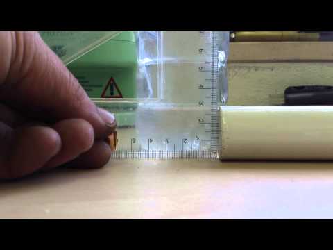

                          • Hello Nupi,
                            http://www.youtube.com/watch?v=BWW8EOdp30g
                            In the video where you presented the sensitivity of PP, you used a marker-pen with which you recorded the distance on the paper. It seems to me that this marker is in aluminum housing, all except the very top, and I noticed that your PP is not detected, even if it was very close to the coils? What is the lateral (side) sensitivity of your PP, if not a problem? Or, marker is plastic one?
                            Thank you!
                            • Hi Harp,
                              The pen is completely made ​​of plastic. It is the: edding 8400 CD / DVD / BD marker.
                              The lateral (side) sensitivity of the PP is 30% less than the front.
                              regards, nupi.
