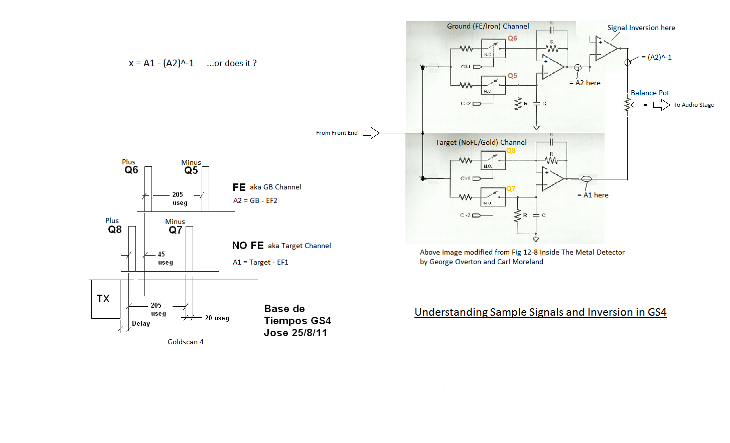

          Hi All, would anybody have a drawing of the CORRECT timing sequence for the intergrater input pins ?
          on the GS6 thats LM358 U3A pins 2 and 3, and LM358 U3b pins 5 and 6
          I am trying to code a micro and a simple drawing would be helpfull, thanks
          • I've been looking for exactly the same thing 6666, here's what I found, if you still need it.
            • Thanks Eclipse for posting picture, still experimenting with this.
              • Do you use same timing scheme?
                • Still trying to make up my mind which is the correct timing scheme , was hoping to find out exactly what was being used in GS6
                  • Maybe something helps About the timing !
