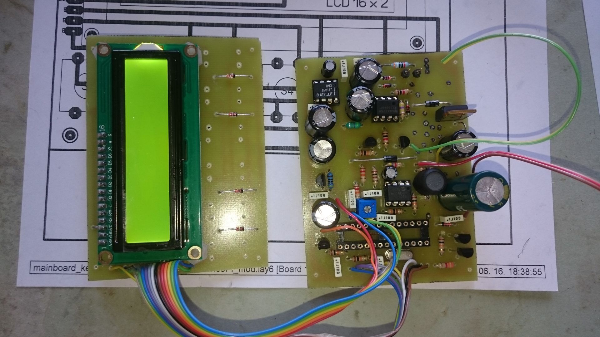

      I put the circuit under power, its power consumption is around 70 mA. But with search coil attached, its going up to 1 amp. There is no negative voltage on the pin 5 of LT1054. Strange...
      If I changed the resistance of the R26 potmeter, the voltages are also changed on the pins of the Atmega IC socket. Is it for this purpose? Keep the voltage on the IC below 5.5V?
      • My fault, there is negative voltage on the LT1054, but only -8V, and is constantly decreasing. LT1054, NE5534 and R13 are warm.

          Is the TX PULSING with correct Width and frequency??
          Check with your O'scope.
          • Thanks for the idea, I'm not there yet. But after I soldered the buttons, there is -11,3V on pin5 LT1054. That was the problem

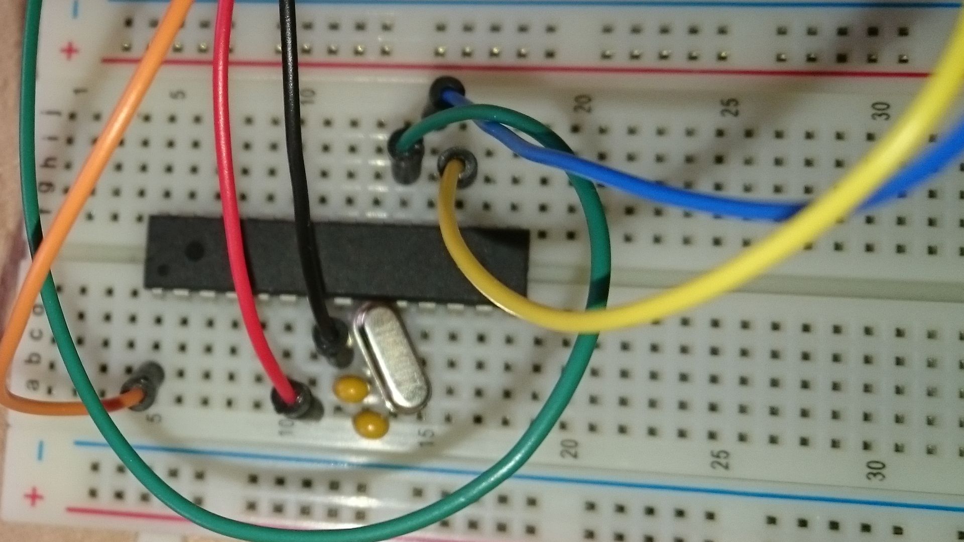

            • I tried to program the Atmega328P but no success. I have used Extremeburner with USBasp. I could write the hex, but after I tried to write the fuse bits there was an error message. After that the program could not communicate with the mc. Every fuse bits was exatly as it should be, I double checked everything. Now I have 2 died mc's. I did a test to see if it works, but only one line black square is on the LCD.
              I still have a problem with the enormous power consumption of the search coil when I plug it into the circuit. I'm stuck.
              I think it's time to let go this project
              • My bad. I had to add two 22pF capacitor and a 16MHz crystal, now I can easily program the Atmega328P.

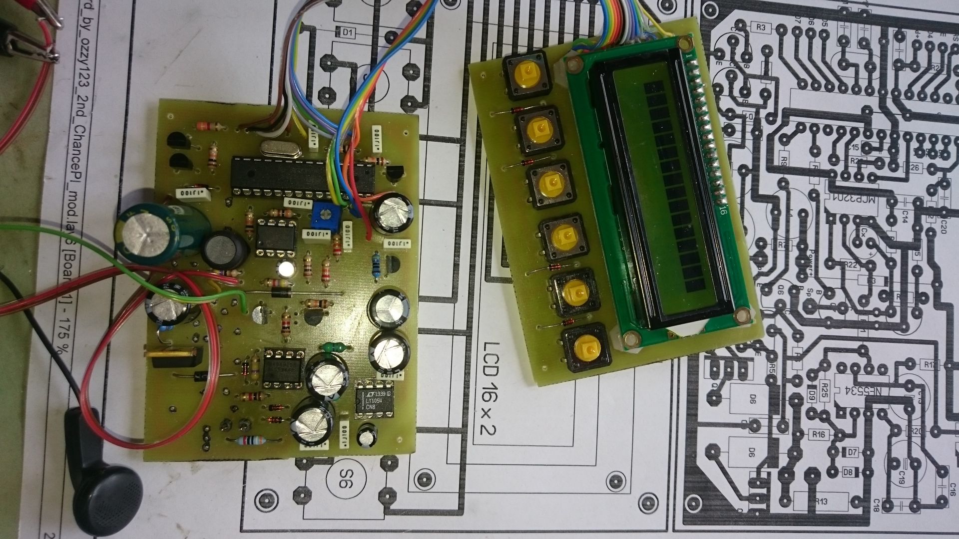

                The circuit still not working. There is 11.7V on the search coil pins. Static sound from the spaker, static picture on the LCD
                Any idea? Where can I start the debugging? I can borrow an oscilloscope.
                • Borrow the O'scope and check oscillator and then the Pulse output from the Atmega.
                  O'scope is a must.
