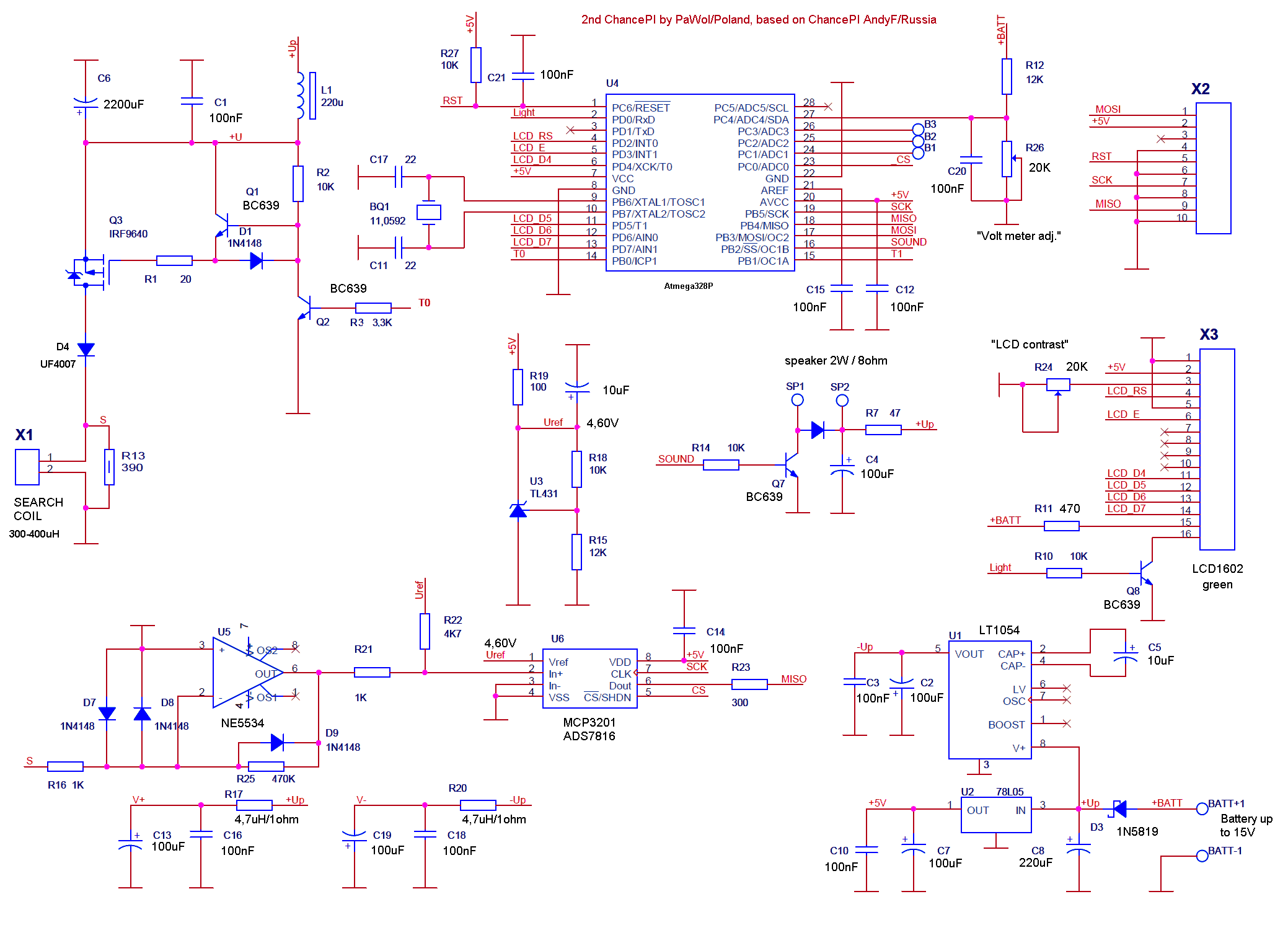

Name:	2nd ChancePI_schematic (1).gif
        If you can try to improve dynamic range of 2'nd Chance PI OP using some good and fast R2R rail-to-rail OP instead old NE5534.
        Good examples are OP from microchip. My choice are MCP 660-669. Very high gain x bandwidth range of 60MHz, with very fast Skew rate 32V per microsecond are ideal for amplifying nano and microvolt signals from fast decaying targets like pure gold nuggets, golden rings, golden seeds, small golden coins at high deep, or normal size golden coins in highly mineralized ground.
        http://www.microchip.com/ParamChartS...ranchID=110153
        Also clamping diodes at should be schottky type smd diode. At output of OP directly to op-out pin should be some pure resistive load from 10 to 600 ohm to stabilize OP circuit in wide range of input impendances. S-parameters tuning. Good values from 330 to 620 ohm.
        Transmitting part should be corrected. Instead old PFET 9640 with 11A drain-source current, 200V breakdown voltage and, 0.5 Ohm,drain-sourc4e channel we need something newer with continuous drain current over 50A, with peak impulse current over 200A and drain-source resistance in 0,0xx range,
        For penetrating deep ground soil we need hyper sharp fronts of PI impulse. It means rising and faling times in several to tenths of nano-seconds. To get this we need high speed high current driver special designed for draiving high current mosfets/igbt transistors with big input gate-source capacitance Cgs from several nano farads. To very fast charge this parasitic capacitance we need very high current pulse direct from mosfet driver.
        My choice is
        ixd630 30A peak pulse current
        http://www.ixysic.com/home/pdfs.nsf/www/IXD_630.pdf/$file/IXD_630.pdf
        Puting 3 in parallel we have 90A current pulse. Square this value multiple with coil inductance and devide by 2 and multiple with number of target kicks per second and you will know how much energy hit the gold target. This imply using very high electrolytic capacitor usualy connected to source of mosfet to supply driver and mosfet with enough peak current in range 100A-200A. Value bigger than 50 000 uF will be fine. This capacitor is main source of detector power and only he could release several tenths or biger enregy pulses in properly designed coil.
        And for the end negative voltage pump LT1054 must be synched with ATMEGA328 directly to avoid wide range of interference problem due to uncorrelated currents in all parts of PI metal detector.
        These are my little suggestions for you and other builders. Try it and see it. I don't ask nobody to belive me - but to understand me.

        • Hi Don,
          You have made some good suggestions.
          The original Chance PI design used an OP37 amp that is much more capable than the NE5534. If you have not already done so, take a look at the original Chance PI schematic.
          Dan

                  • Just checked original cct compared to the 2nd chance some differences Flyback clamp, coil damping resistor & R11 from + bat to socket X3 pin 14. My main concern is the fly back clamp what impact does this change have.
                    • found answer in the tread will have remove & change components

                          Because of question from users I have to clarify a little bit ...
                          Entire Q6 solution was a bit "fictious" in the original Chance PI. It did not work properly in fact
                          did nothing usefull instead of additional and unwanted 100mA power drain
                          So I do not drive Q6 in the 2nd Chance and I have changed the way of coil driving.
                          For instance the original Q6 solution drains 180mA but my solution drains 80mA.
                          Is there any difference?
                          Like I said Q6 solution was not succesfull
                          Should not be difference if Q6 circuit is placed or removed from PCB when using my software.
                          In my software Q6 is driven as inactive whole time. The ICL7660 / LT1054
                          is enabled whole time also.
                          So, simplifying, my release should be backward compatible. I do not test it at all.
                          For purity reasons I have removed Q6 circuit from my pcb completly and new schematic diagram and pcb.

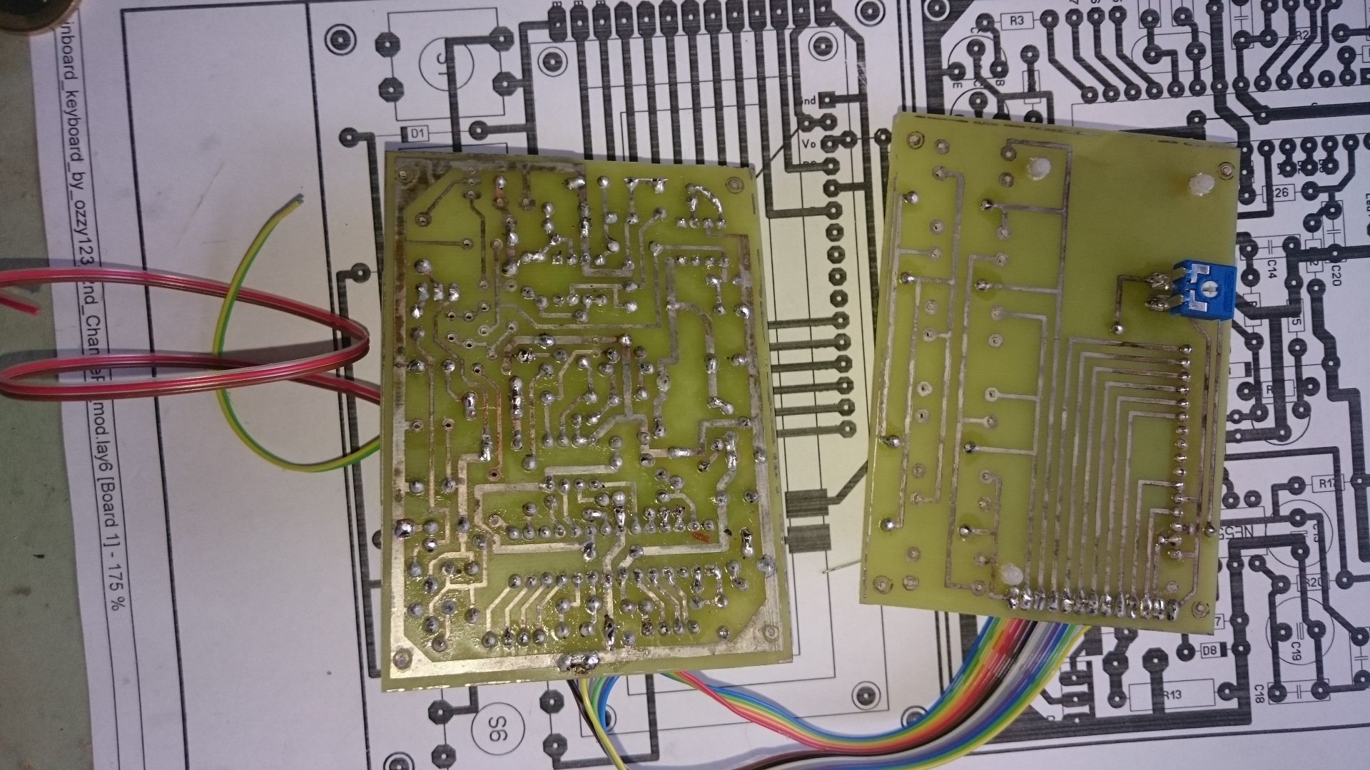

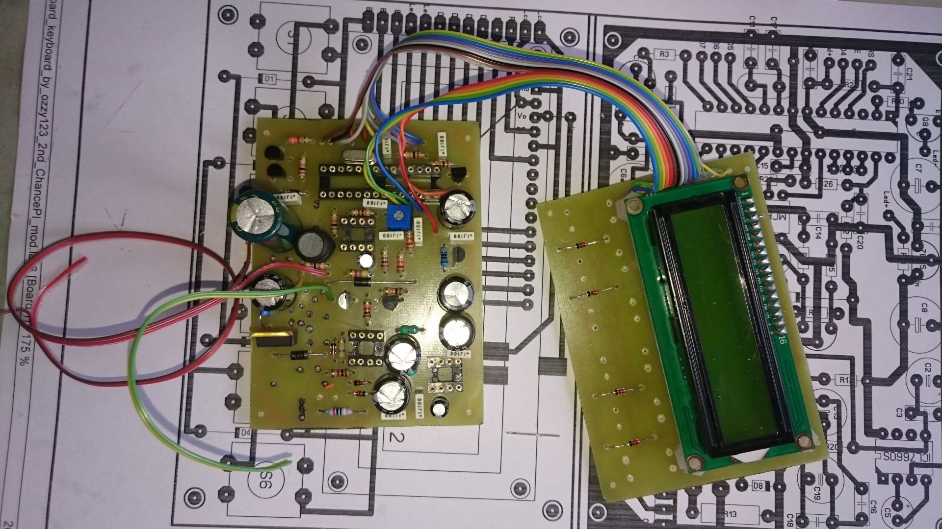

                            • I'm nearly finished my circuit. Not too elegant, some ugly soldering, but looks short circuit free. And I have some questions
                              What is the purpose of R26? (Volt meter adjust) What value should be seen on the voltmeter while turning the knob? And where can I measure?
                              The other thing is the Atmega328P. I ordered an USBasp programmer, which I think good to program this IC. I have a blank IC, do I need program bootloader in it? I think the answer is no, because this is not Arduino. The buttons and the programmer will arrive shortly. I have to learn to program this chip so far.
