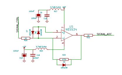

                              Hello dantech
                              i see schematic NE5534 have LC DC filter, capacitor before inductor for DC filter?
                              capacitor->inductor , or inductor -> capacitor
                              • #45
                                Pin3 of the preamp must be connected to GND and yeah that LC filter doesn't seems correctly connected.
