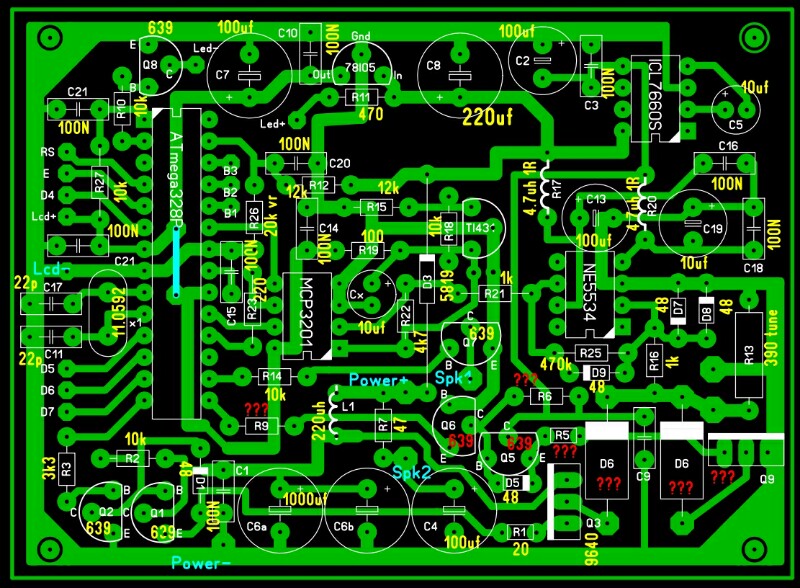

                          • Btw, i really like to build ur pcb version, but as you know it was fail or i miss something.
                            If you have time plis redraw the sprint layout, so it can be clear what to omit and not.
                            With my original updated chance pcb i think is not compitable with ur firmware, when i set up something like barrier or go to setup menu its alwasy ringing, and i should restart the md to make it normal again.

                            • Unfortunatelly I have not free time. In my opinion documents I gave are enough to build 2nd ChancePI without problems.
