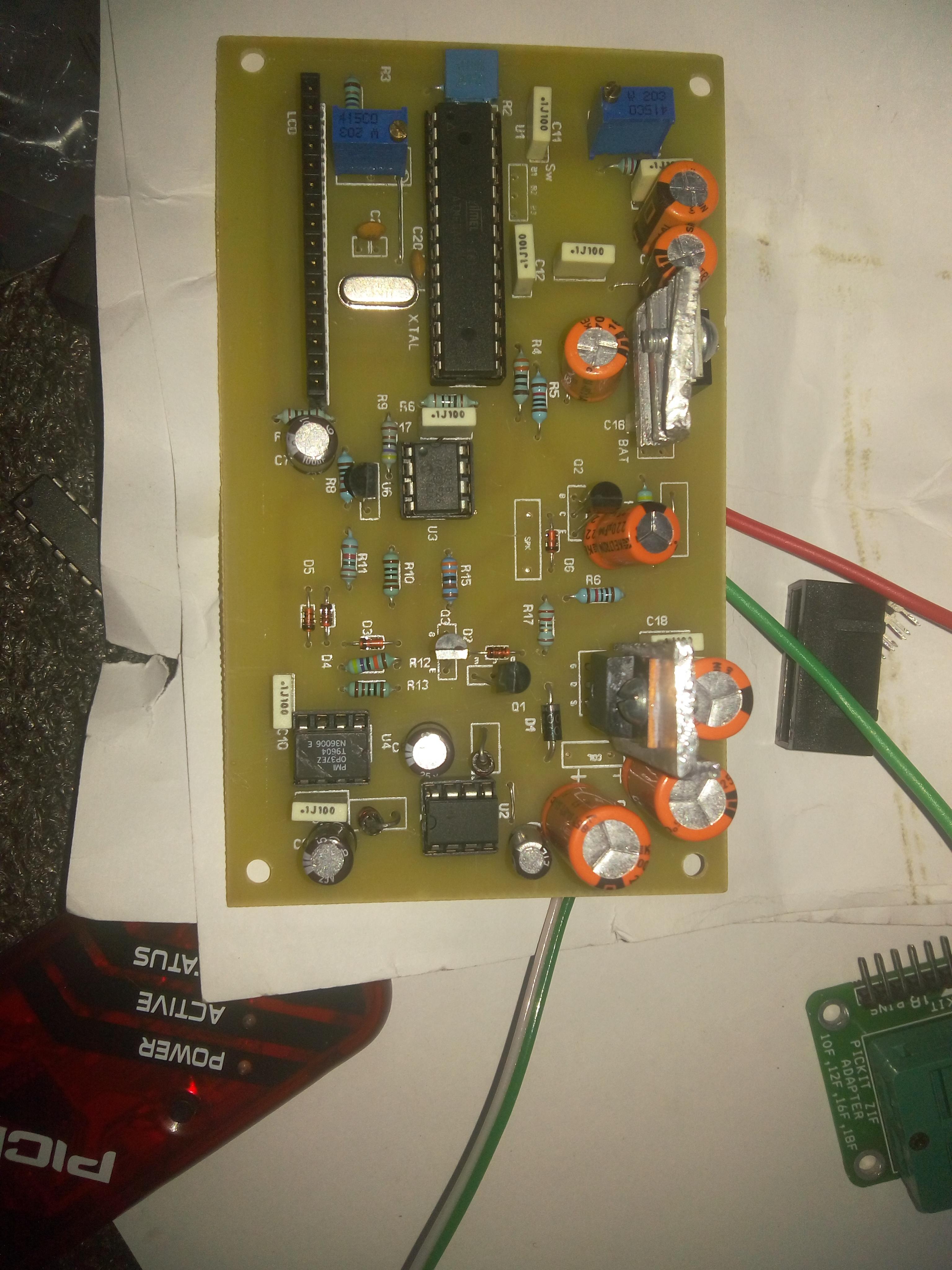

    Please check my assembled version not working
    Last edited by UnHappy; 05-19-2017, 11:09 AM. Reason: time out while attaching pictures

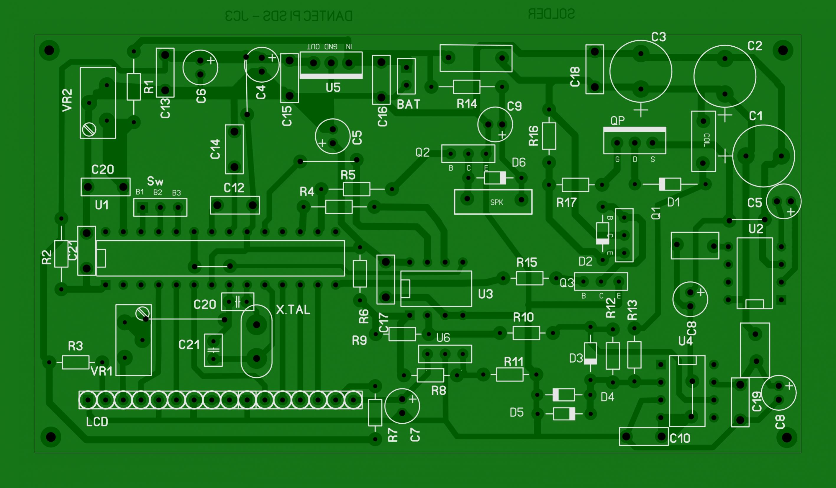

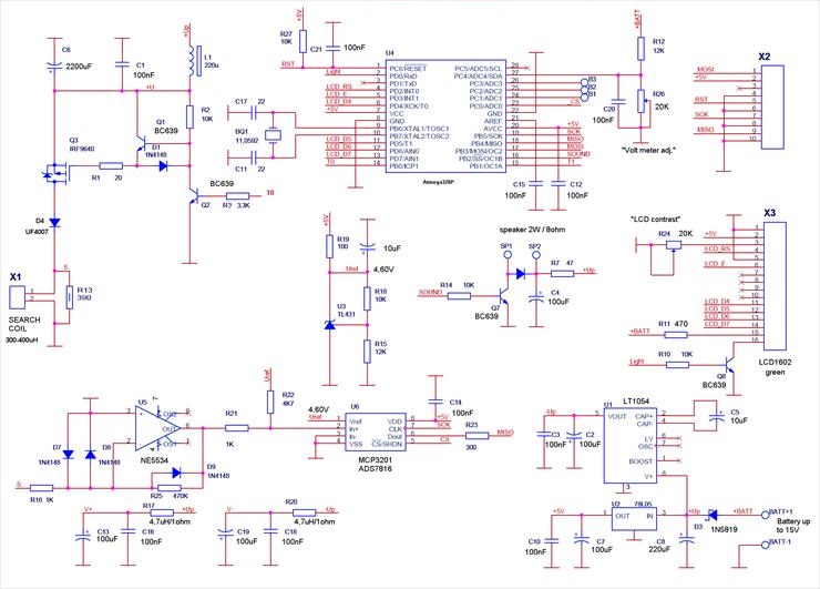

    • Can we have the layout to compare , As I am unable to initialise it

                    • There is one serious problem. There is no free pins on ATmega328. The only one which is free is Tx output.
                      I want to use it as a outcoming data to other subsystems, so I cannot implement vibrator support
                      • A good way would be to drive the lcd by I2C with a converter board.
                        Or simply use the same pin to drive the vibrator and the audio with a different driving method through the soft..
