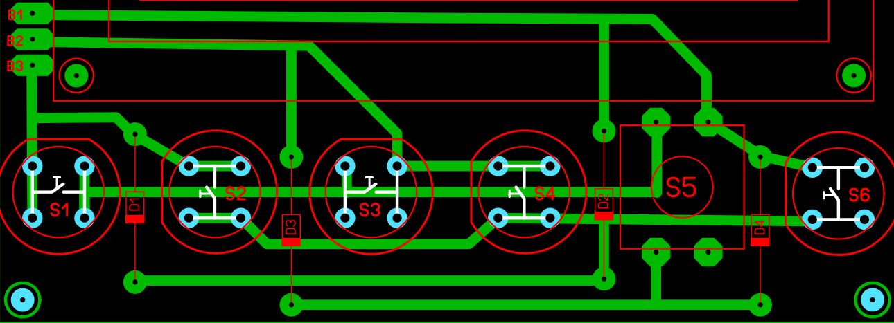

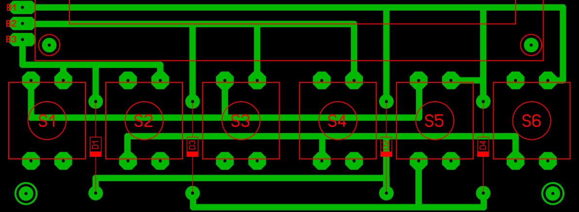

    Hi Dan,
    thanks for your great Projekt.
    I have a question about the "Switchboard" (Switch 5). Which Pin´s are connected, if the Button is pressed ?

      This is in fact common project with AndyF. He was developing project a few years ago. Above v121 (and at the 2nd ChancePI) is developed by me
      But we have to keep in mind that AndyF did huge work
      "Straight from a head"
      S1 - left/signal mask -
      S2 - right/signal mask +
      S3 - up/volume -
      S4 - down/volume+
      S5 - OK/filter reset
      S6 - Menu/escape
      Personally I use keyboard PCB layout (keyboard_pcb.lay6 file)
      Plik keyboard pcb.lay6 na koncie użytkownika dantech • folder PCB • Data dodania: 9 paź 2016
      That PCB is fully verified with schematic (keyboard_schematic.jpg)
      Plik keyboard schematic.jpg na koncie użytkownika dantech • folder Schematics • Data dodania: 9 paź 2016
      You have to compare both ones

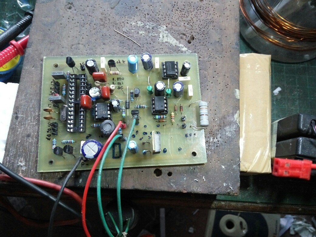

                All parts complete, let me know if there any mistake, im not sure about wrong choke placement from post behind.
                Any voltage measurement?
                What is the value of C9?
                Programing directly from B1 B2 and B3?
                • #83
                  B1,B2,B3 comes from "buttons". This is keyboard connector.
                  You have to programm in the external socket or solder additional wires under the PCB
                  C9/C18 is the pair of 100n / 100uF in the positive power rail of NE5534. I do not remember which one is C9.
                  At the beginning you have to run the circuit without atmega, MCP3201, LT1054 and NE5534.
                  Then you have to check power consumption (several miliAmps), +5V, +12V, -12V, Uref =4,6.
                  Next you can place ICs in the sockets. Should start at once
                  By the way you cabn use ADS7816 instead of MCP3201 also.

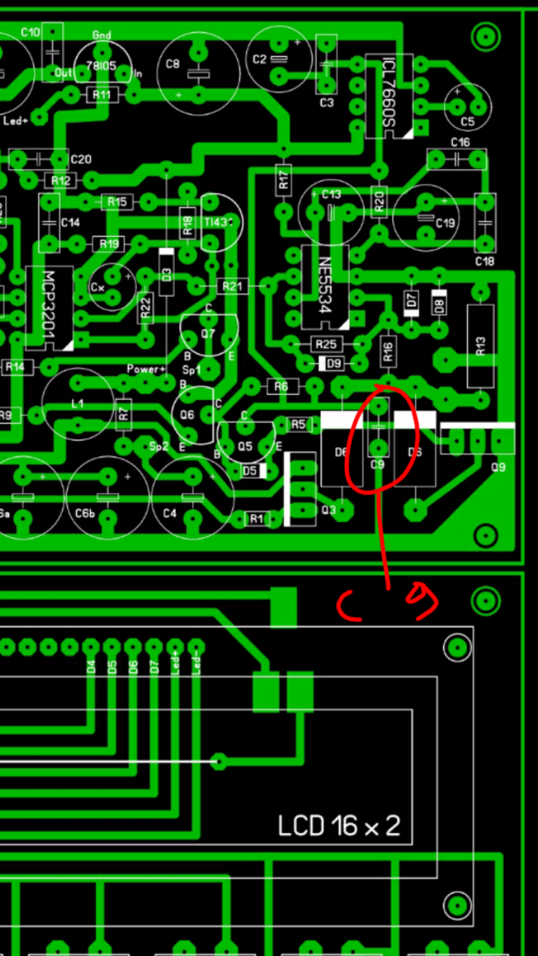

                  • #84
                    This c9
                    according to the scheme, c9 should not exist, on the pcb layout its connect to pin5 LT1054.
                    • #85
                      Right, I was looking onto another schematic version

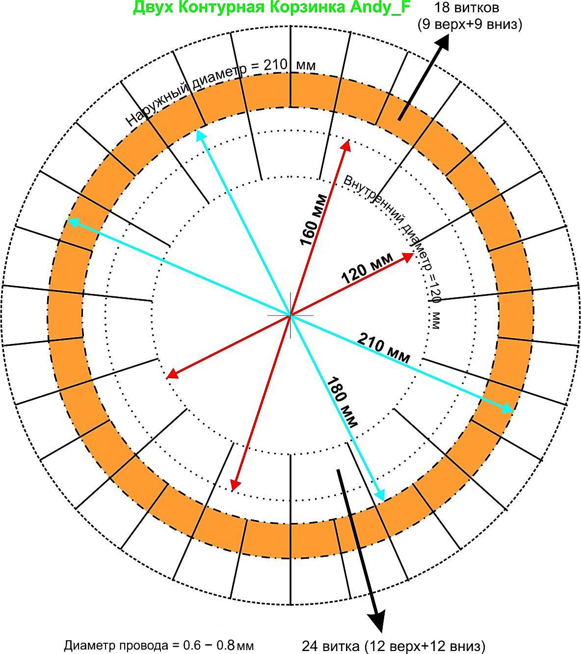

                        Coil industance, resistance?
                        Or just following the pic, 24 (12+12) top bottom, and outer 18 (9+9) top bottom. I have 0.6mm wire
                        • #87
                          Follow the picture. I prefer 0,8 mm wire. Then we have 1 ohm and 350uH
                          I think that 0,6 mm can be also used but resistance will be higher eg. 1,7 ohm, inductance should be circa 380uH. So the coil can be little bit slower (2-3 us)
                          • #88
