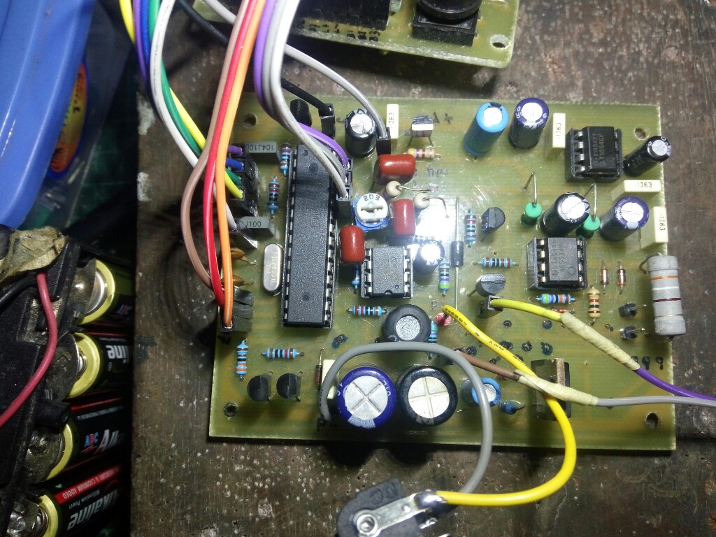

Good morning all,Originally posted by dantech View PostAny problem, any progress?

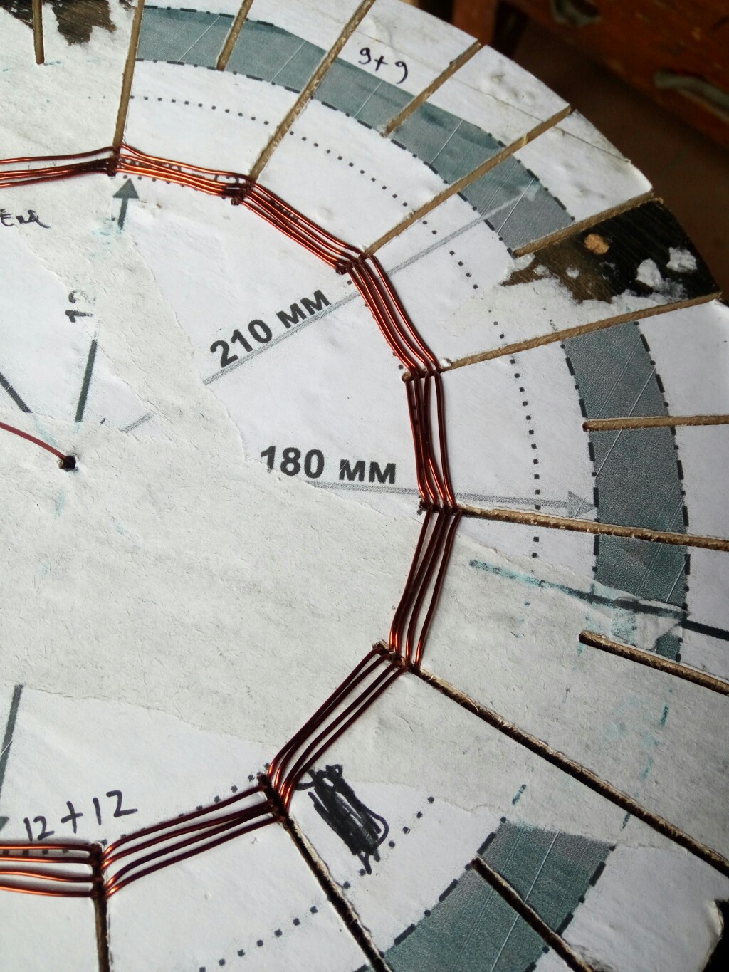

Not yet, i like to get 0.8mm wire instead, for stock
, btw i dont know what diode should be place on the keyboard D1 - D4, or its just 4148
Do you have pic top of your pcb, i like to make sure all is already on place.

1. Remove all ICs
2. Check power supply lines +5V, +12V, -12V. Power consumption should be circa 30mA
3. Check shortcuts on PCB near ATmega328
4. Verify Atmega328 fuse bits and flash memory content
5. Put ICs back
6. Check oscillogram on crystal pins
7. Check signals on ISP bus (eg. clock signal for ADC)
8. Check LCD connections
9. Check LCD contrast resistor
- Likes 1
1. Remove all ICs ....done
+5 ok, alittle hot 78l05, +12v where?, -12v ?
3. Check shortcuts on PCB near ATmega328.... No short
...done, all ok
5. Put ICs back... Done
6. Check oscillogram on crystal pins... What is that??
....Never hear that
8. Check LCD connections ... All ok
9. Check LCD contrast resistor.... Cant find R24 to adjust contrast
Im not an electro expert
Ad. 2 +12V/-12V you will find for instance on pin 5 and 8 of LT1054. 78L05 should not be hot. Check power consumption. Something is wrong
Ad. 6 and 7
You have to use an oscilloscope. Signals on crystal and SPI bus tell us that CPU is alive and tries to communicate with external device (ADC)
Ad. 9 I do not know what pcb you have but in my case I have resistor 1kohm between pin 1 and 3 of LCD
