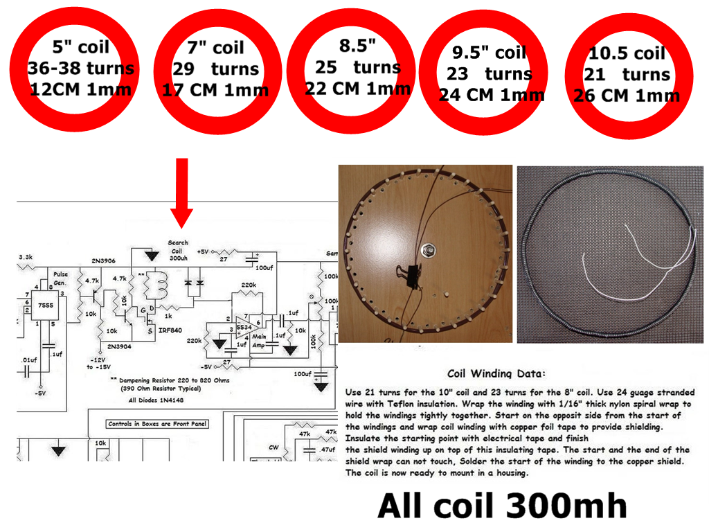

                        When properly calibrated distance is much greater. Plus the poster didn't have an audible threshold tic. Without a threshold tic there is less depth
                        A 5" coil I made originally would get about 1 to 1.5" less than the 7" coil below.
                        Last noticeable, faint signal change
                        Using the 10.5" search coil
                        Fish scale(1/2 dime)----------9"
                        Sterling ring---------------------10"
                        10k ladies ring------------------11"
                        14kt man's wedding band---14"
                        Using the 7" search coil
                        Fish scale(1/2 dime)----------7-8"
                        Sterling ring----------------------7-8"
                        10k ladies ring-------------------7-8"
                        14kt man's wedding band---10-11"

                          Seven hello What is your comment on the picture
                          • #43
                            The image states "All Coil 300mH". That should be "300uH".
                            • #44
                              Your correct 300uh, I do not know where or who made up that picture.
