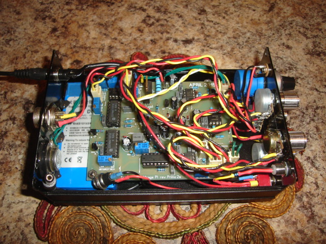

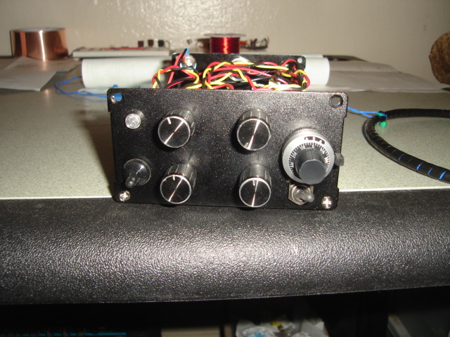

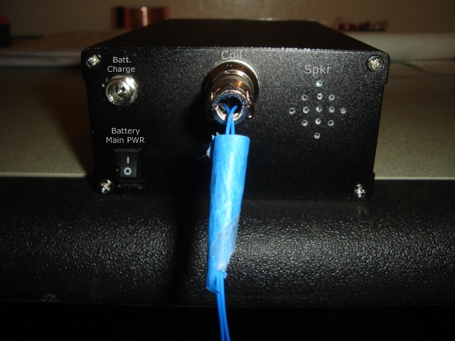

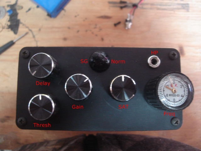

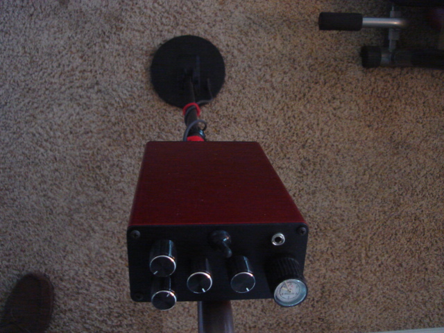

                  [QUOTE=geoscash1;224396]I have used a couple different cases for the mirage ( see pics below).. the best fit so far has been the one below in the ebay link or "mirage 1" build and it is relatively cheap compared to other cases. its a nice case for the price too. Just spend some time on your layout before drilling and you'll be fine.
                  mirage 1 - inside
                  mirage 1 - front panel
                  mirage 1 - rear panel
Name:	My Mirage Build completed back panel.jpg
                  Mirage 2 - front panel
Name:	Main panel layout.jpg
                  Mirage 2 - completed (difficult case, solid one piece, only removable ends)
Name:	CBSII with 7.25 inch coil.JPG
                  Nice build! What parameter do you use the 10-turn pot for? (Rdamp, Delay etc.)
                  Thanks ... Polymer

                            Hi Sven,
                            I have completed building the circuit board, and all is working well.
                            A couple of questions:
                            - Does the pcb need to enclosed in a metal (i.e. shielded) box, or can I install it in a plastic box with no worries?
                            - I have found a very low capacitance cable to go between the search head and the control box (7pf per foot between adjacent wire conductors - excluding the shield). It also has a woven shield that I can use. Do I need to use the shield, or can I simply use the twin core wires (twisted)?
                            - If I need to use the shield, should it be connected within the search coil to the coil shield/virtual earth star point, or could/should it be connected to the virtual earth (+ve in this case) at the pcb?
                            - The speaker volume is very low with an 8 ohm speaker - even if the 10 ohm series resistor is bypassed. What workaround do you recommend for this?
                            - I have built what I think may be a very fast coil using a planar spiral design (2.2 layers), with foam padded filler used before adding copper foil shielding (measuring the self resonating frequency seems to be a vague and fraught process). I have researched everywhere about how to optimise the damping resistor. Some articles say that a lower resistance can overdamp the return signal, while others say reduce it as far as you reasonably can, I assume that a lower resistance will deliver a faster voltage drop, but how do I optimise? Do I simply keep reducing it until I start seeing some ringing on the cro, and then back off of a bit?
                            - I also want to add the auto-track freeze feature as per the Hammerhead design. Do I simply cut the track and put a switch between pin 5 of TL072 and the 220k Sat Adj resistor?
                            Thanks in advance!
                            Elliot
                                Look at Pre-amp output on scope. Without damping R you will see ringing. Decrease value of damping R until ringing is gone and a smooth exponential decay curve is seen.
                                I prefer a shielded (metal) enclosure but seem many PI detectors are built into plastic boxes and work fine.
                                If you have shielded the coil then this shield needs to be connected to the circuit "ground" (virtual earth). Several ways to do this- either on the cable shield or on the "Ground" coil connection.
                                On my modified HH I do not shield the coil or run a shielded cable. Works fine with CAT-5 cable but YMMV.
                                Which cable and shield connection scheme works best may need to be determined experimentally.
