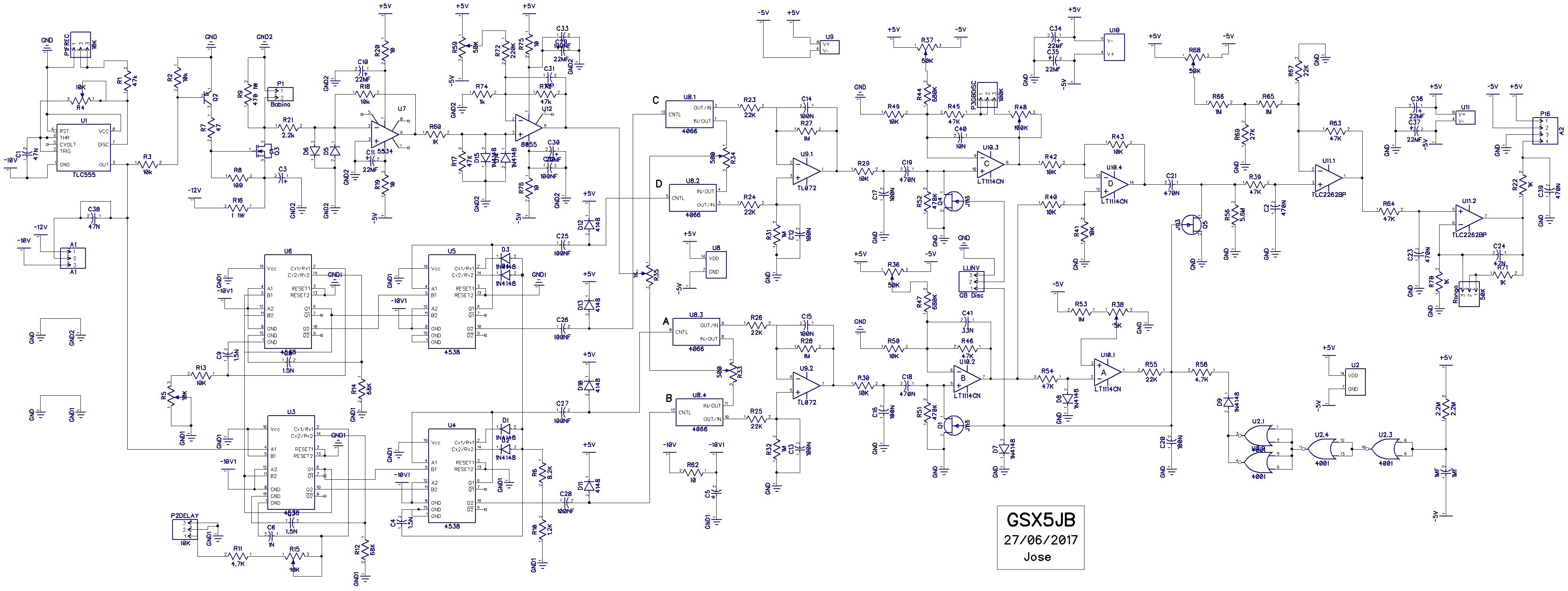

                            The first part of the GS5, you have some errors, I will publish my version that is tested and works in a next post.
                            Jose
                            • The first part of the GS5 scheme has errors.
                              What I am publishing, is my version based on the Turkish scheme but with the corrected errors.
                              It may be something different, but it is working.
                              To differentiate the Turkish scheme, call it GSX5JB.
                              JoseClick image for larger version
                              • Hi Jose !
                                Is this version tested ?
