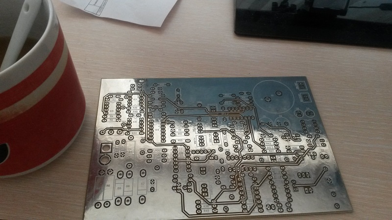

My ugly *** board for GS4 just arrived

Orbit that's needed only if mineralisation is too high and you can't get it to work properly.
Normally you wouldn't want to use channel 2 (GB) cos it will result in less depth for sure.
It's better to have it and not need than to not have it and need it
The board is 2Layer + TH plating, silk screen,without solder mask cos it's too damn expensive (I will make it my self - I have UV paint),
150x100 - and it came to my door at the 4th day for 20$ total. It's a local company that doesn't work on the foreign market.
I just didn't want to make 2 layer board that needed to have TH plating, and don't have time to wait from China.
5 boards like these with good quality with DHL will come to 100$ for 10 days.. but this is just a proto board, I already found a mistake in my drawings
