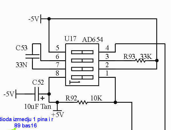

          Dave, do you work with micros? The GS5 used a 555 + discrete logic clocking whereas the TDI used a micro which makes all the clocking and frequency control easier. The code I wrote for the PI3 in ITMD is probably not far from what is needed to replicate this function.
          The GS5 and original TDI used an AD654 V-to-F chip to create the hi-lo tones through separate amp paths. In the TDI-SL I replaced the pricey '654 with a simple 555 that exactly replicated the tones. It would take me a lot of thinking to re-figure out how I did that, my suggestion instead is to slap on a simple 555 VCO just to get the thing to run. You can make something better later.
              Hi Carl...Unfortunately i cannot do programming....many years ago i did try and learn pic programming but it got too heavy for my mind and i gave up...as you say a simple 555 vco will do the trick for now...i like a challenge and the gs 5 will be a good project.

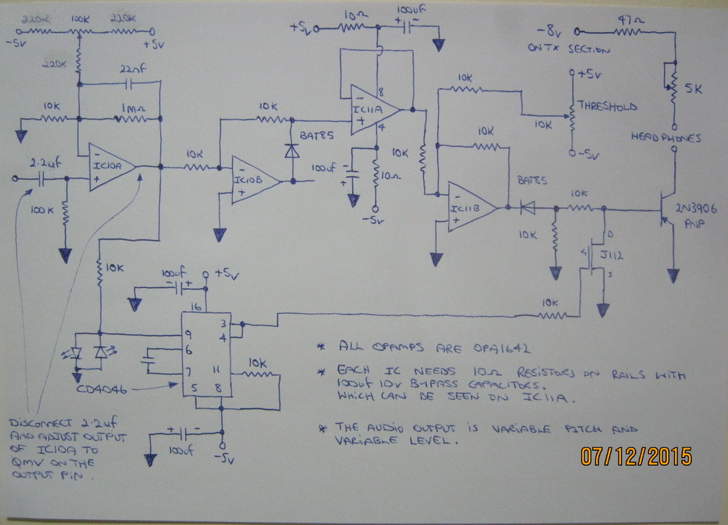

                            The discrimination on the GS5 is definitely not ferrous/non-ferrous. It's the same as the TDI, which purloins the ground balance function to give a different audio tone for targets either above or below a particular setting.
                            • #44
                              Re the audio section, i've posted my method a few time on the forum. Here it is again.....
                              Hi/Lo tone and audio level rise from threshold.
                              • #45
                                Yes that is the schematic I was referring to, thanks mickstv
