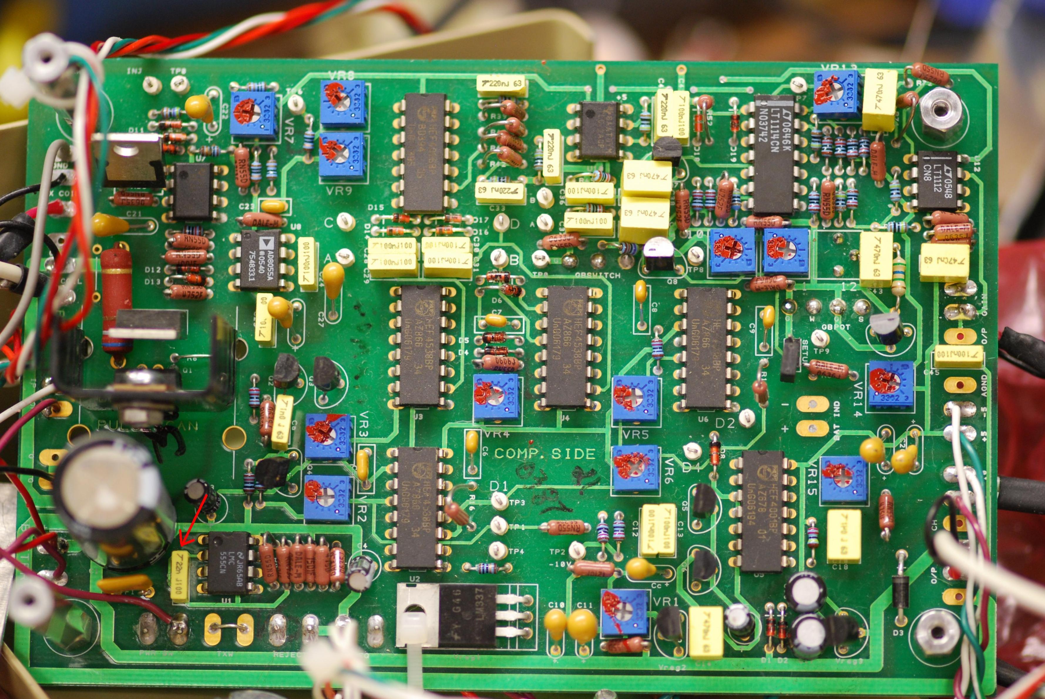

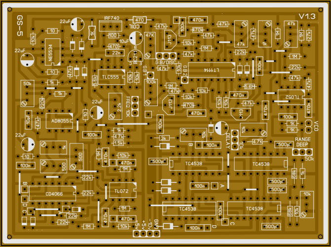

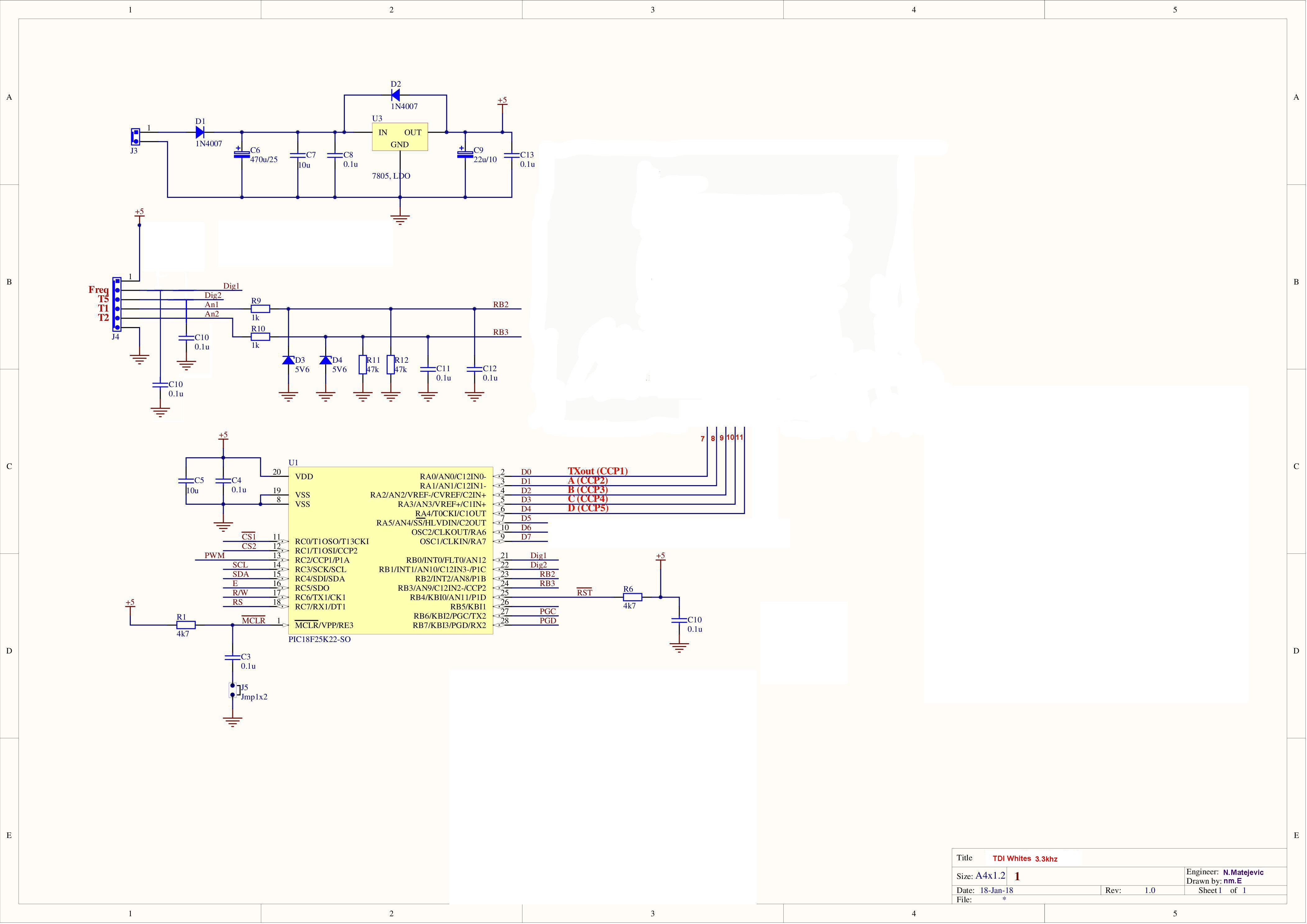

GOLDSCAN 5 SCHEMATIC QUESTION
GS5 with a processor Time like TDI ..SLAttached Files
Possibly you read the O'scope time/division wrong- re-check as this is easy to do wrong.Originally posted by saba View PostHi dbanner, on breadboard, freq. and pulse i see on osciloscope, i want test every section separately and finaly draw pcb
Other possibility is wrong value components like the Caps that set 555 Freq. Easy to mix 0.047uf for 0.47uF - re-check.
The O'scope should have a Calibration output. Use that to check frequency you measure.
