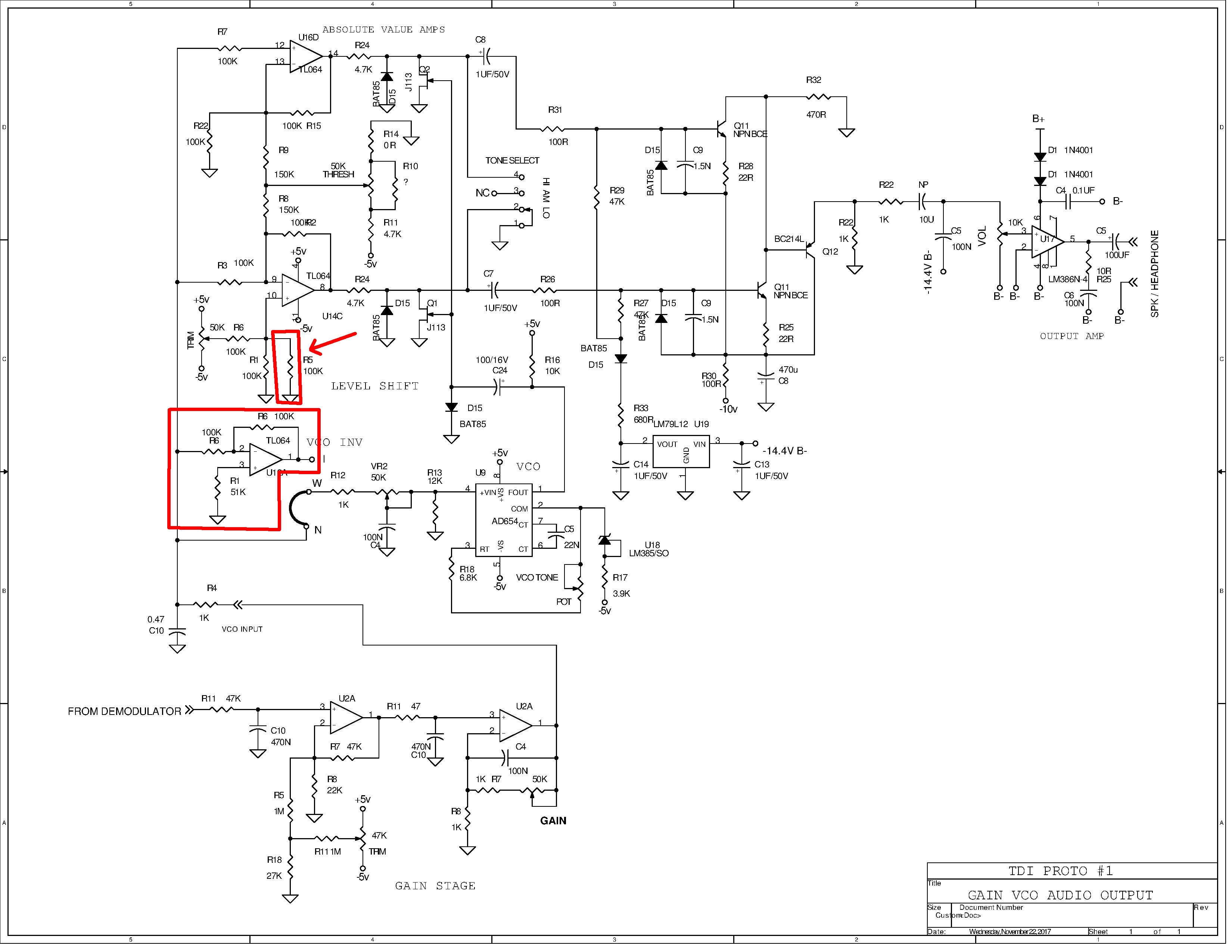

    I own a TDI and i need schematics only for repairing( if will needing) or for modification.
    • At TDI the second preamplifier is a NE5532, not a AD8055 as at GS5.
      • Here is a layout for GS5 audio based on schem that was posted of TDI Audio.
          We must assume then, that TDI has three stages in the preamplifier...
          Jose
          • Hi dbanner ! Can you in SprintLayut 5 ?
            • Corrected. AD654, B-.
              • Now i try to make pcb and test.
                  • dbanner AD8055 is AD654
                    • Post#261
                        Post#261
                        The same marked ! AD8055
                        • O.K. Changed label to AD654 and corrected B-
                          • I left out this section, and what about this resistor? Is this right on schematic?
                            • I tried to rename extension to *.lay for sprintlayout 5, but it still doesn't work. Sprintlayout 5 does not recocognise sprintlayout 6 files.
                                It's okay never mind !
