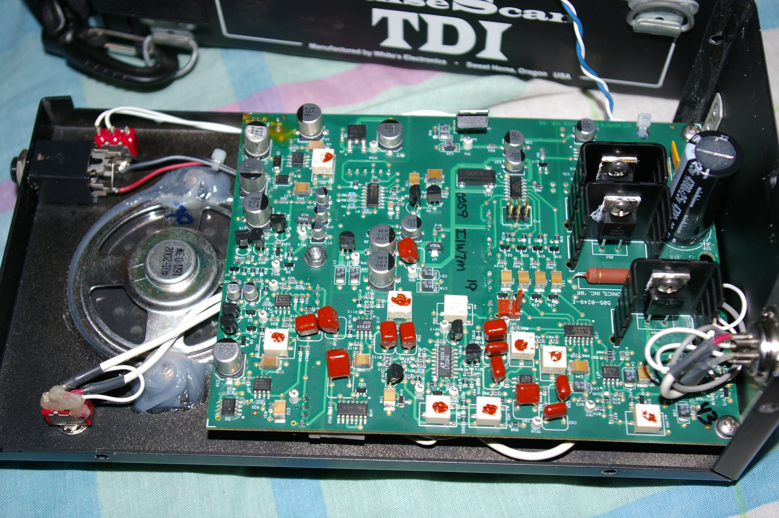

            At TDI the second preamplifier is a NE5532, not a AD8055 as at GS5.
            Would you post a picture of these part of the board ?
            With a 5532 , there will only have 2 resistors by OPamp, and there will be close to circuit.

                I left out this section, and what about this resistor? Is this right on schematic?
                Remember this was a proto type test unit. Two 100k's in parallel to make 50k later they have used a 47k ? The amp you left out was not used on the production model.
                • Thanks. I try with 47K, this is logical.
                    Here is a TDI picture with a NE5532. Maybe a cheap replacement for the NE5534 and AD8055?
                    • I see a multiplexer chip(HEF4053BT). This is more advanced circuitry. since the TDI is now out of production, its resale value is bound to go up? As for front end, cant make out some numbers, picture resolution not so good. i also see a 16 lead LT1114S(pin 8 and 9 N.C.)
                          From what I understand they only discontinued the "Pro" they still produce the "SL". The pro runs on 14.4v and the sl 12v. In the photo all the timing is done with a micro. They also added a noise blanking circuit on the gb channel which may be some of the differences seen in the parts. Too bad Carl and Eric can't chime in on the details. Looking at Jose's schematic, it would make a great project. I would just add the Hi/lo tone switch to the audio and it's complete.
                          For more details google "TDI Reg Sniff" he posted a lot of information.
