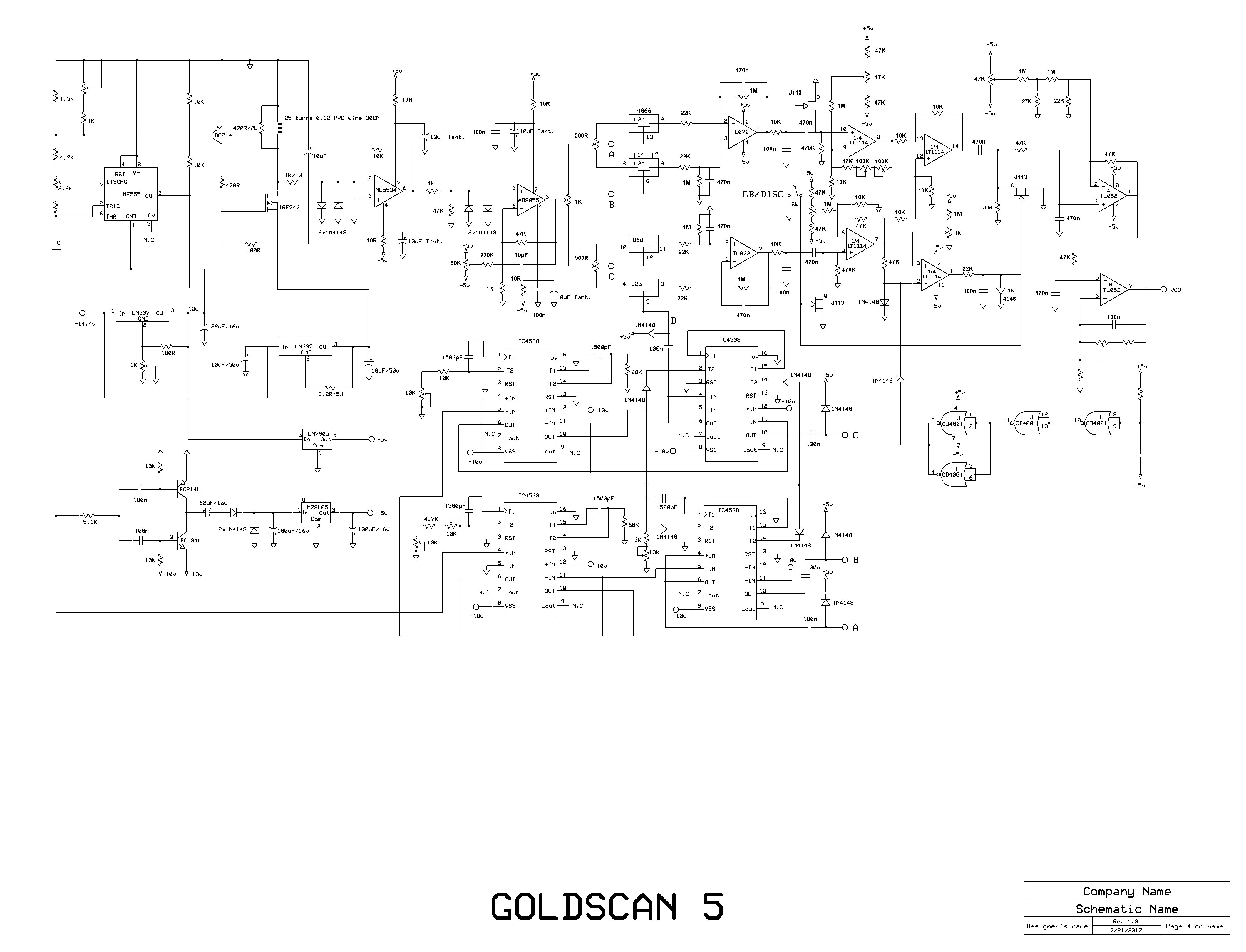

GOLDSCAN 5 SCHEMATIC QUESTION
  • this is my proposed layout for main board. VCO audio and power supply will be on seperate boards. All components have been labelled. Some mistakes have been corrected.
    • With what TL052 is better than TL062 ?

                • Seems no interest anymore. anyway, here is good layout i did some time back.
                    Thanks Dbanner, did you build it to prove it works ?, and do you have the timings ?
                    • yes i have the timing data somewhere, and no i haven't had the time to build and verify. It's something i would like to do but most people seem to be stuck on surf and baracuda in perpetuity.

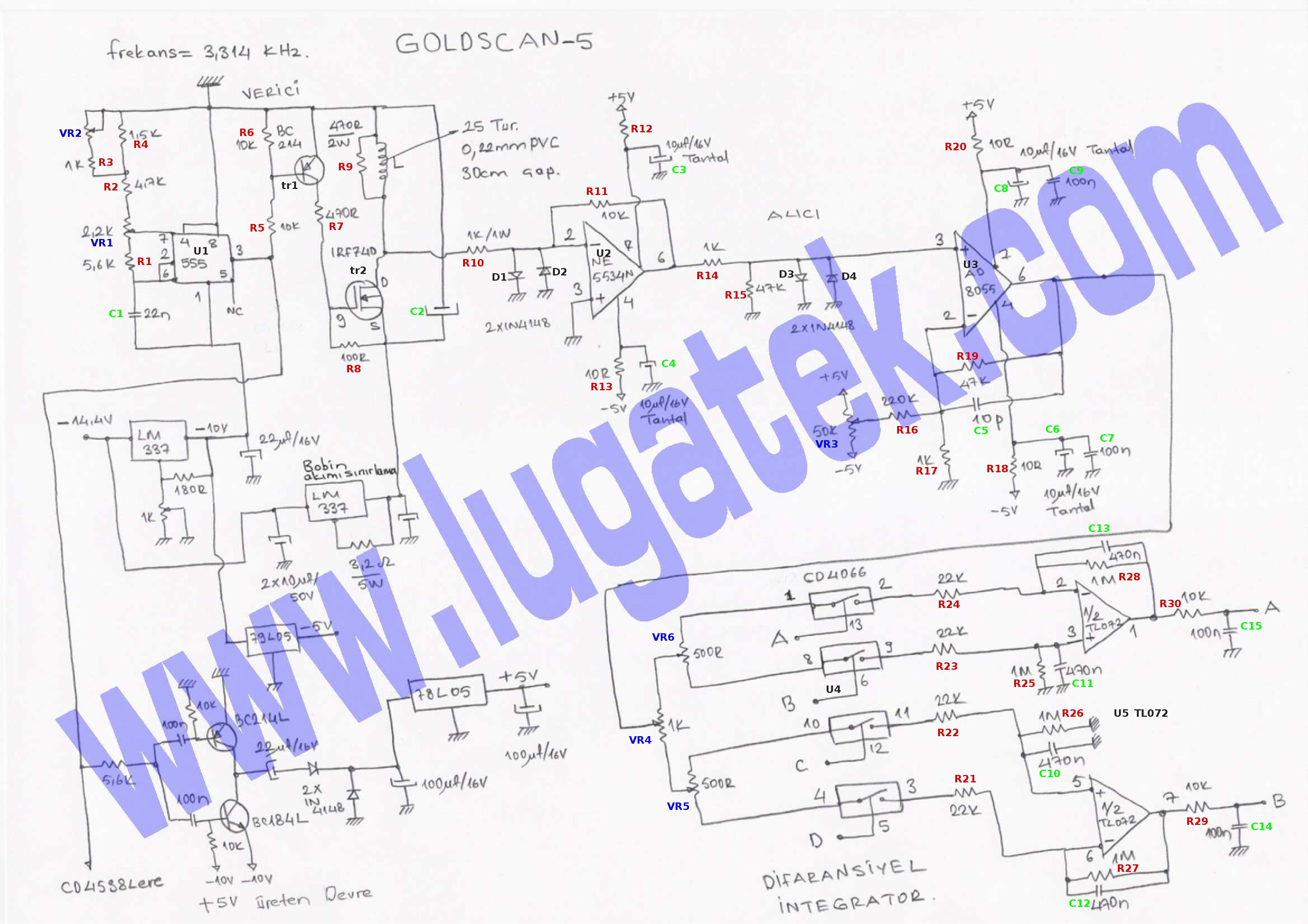

                      • parts labelled to correspond with my layout

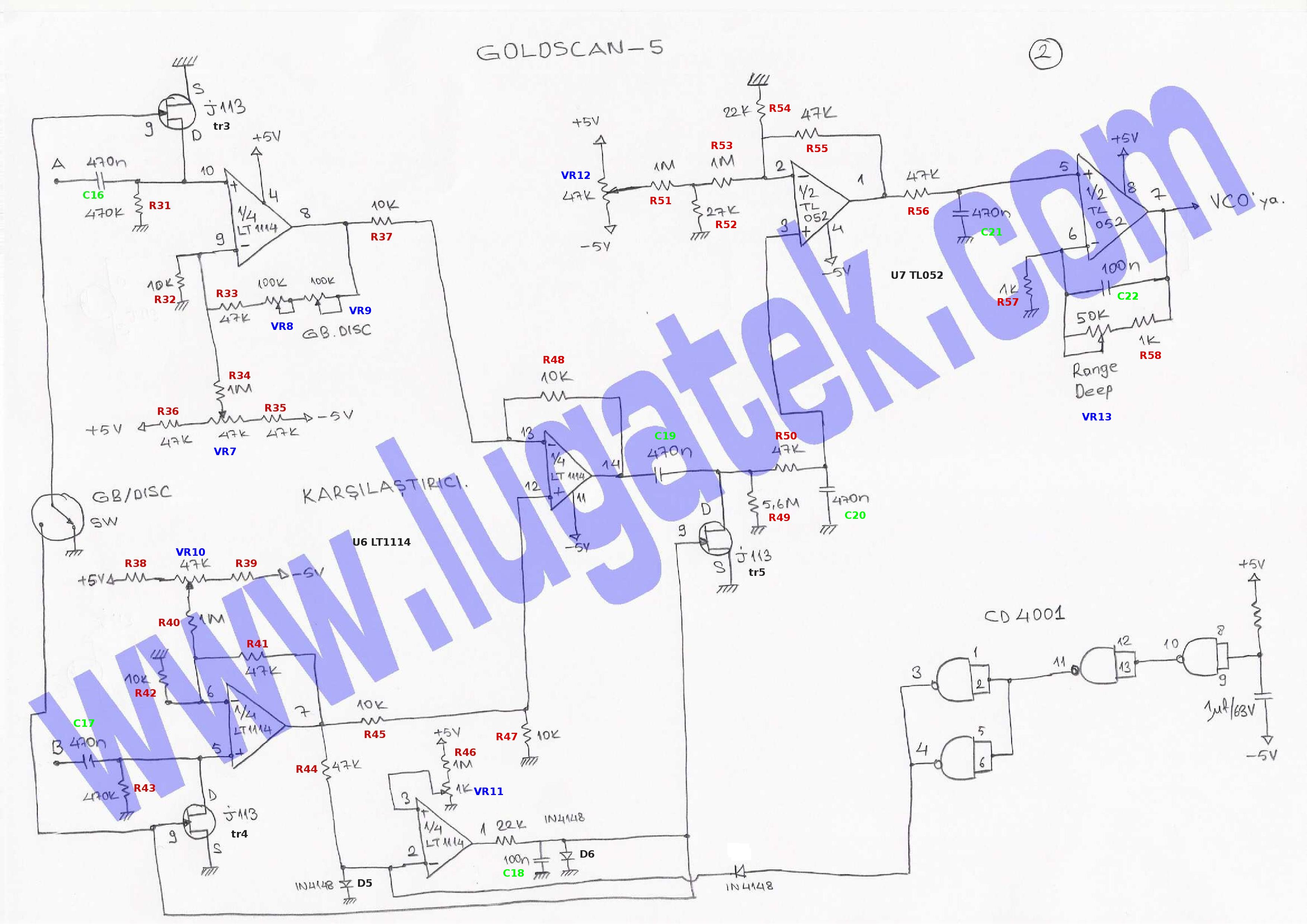

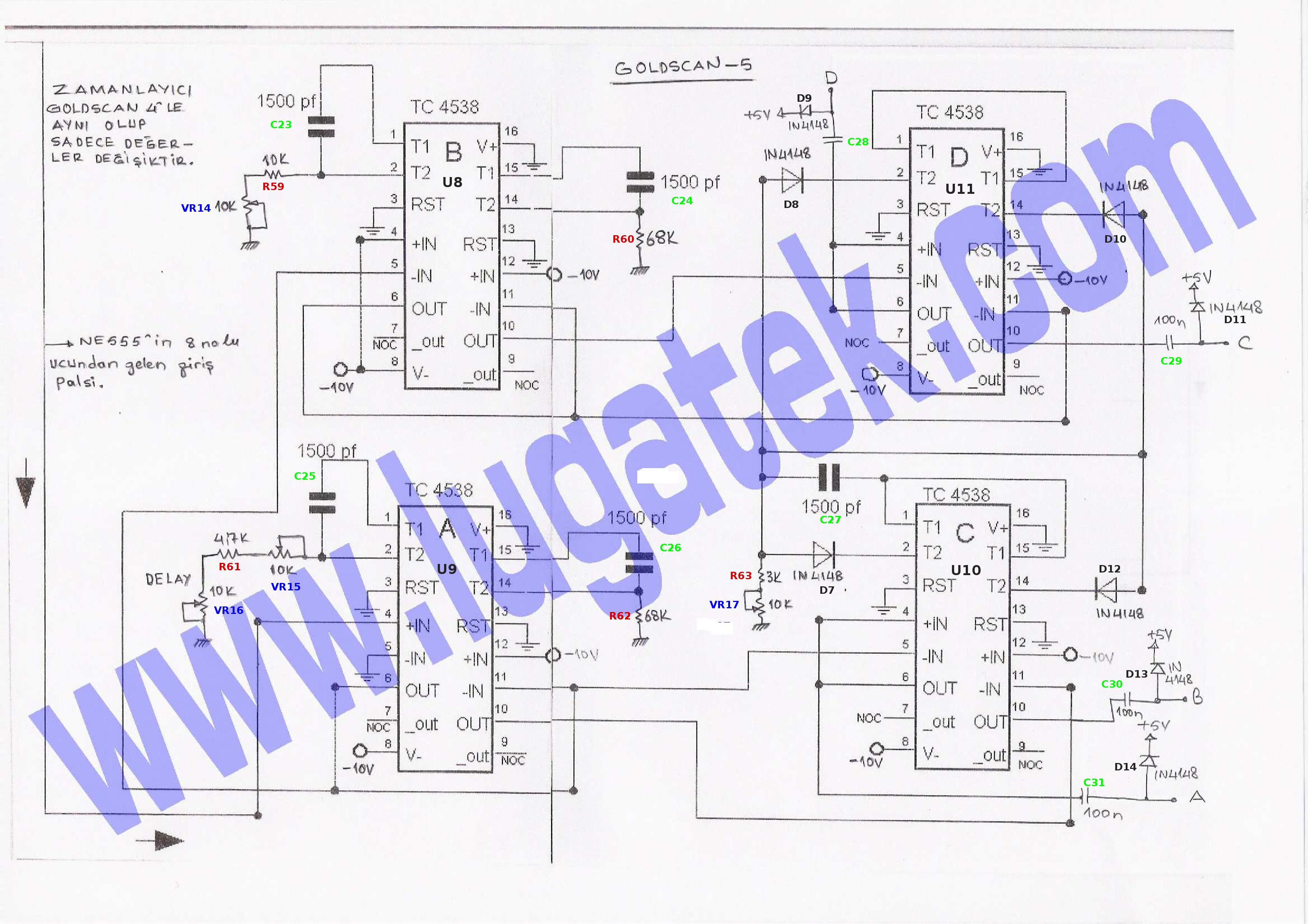

                        • i started working on the audio section from original, but this is as far as i got. without better photos its impossible to complete. actually the audio section can be adapted as there are many solutions out there. The power supply is straightforward and easy.
                          • You have spent a lot of time on this thanks.
                            • Audio section very critical .
