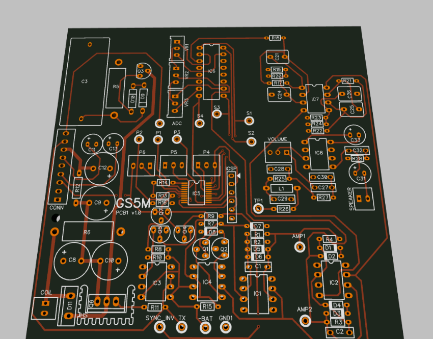

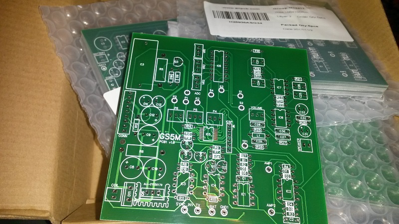

            I've got few GS project boards on order, done with DipTrace, order 1/2 arriving today:
            Those are different MCU based (32bit/8Bit CPUs), also analog (default GS4/5) frontend, one of them has mickstv 4046 audio, the other has GS4 audio, the other has PWM based audio section and so on. Basicly a SOUP for Goldscans.
            None of them are following the original drawings.

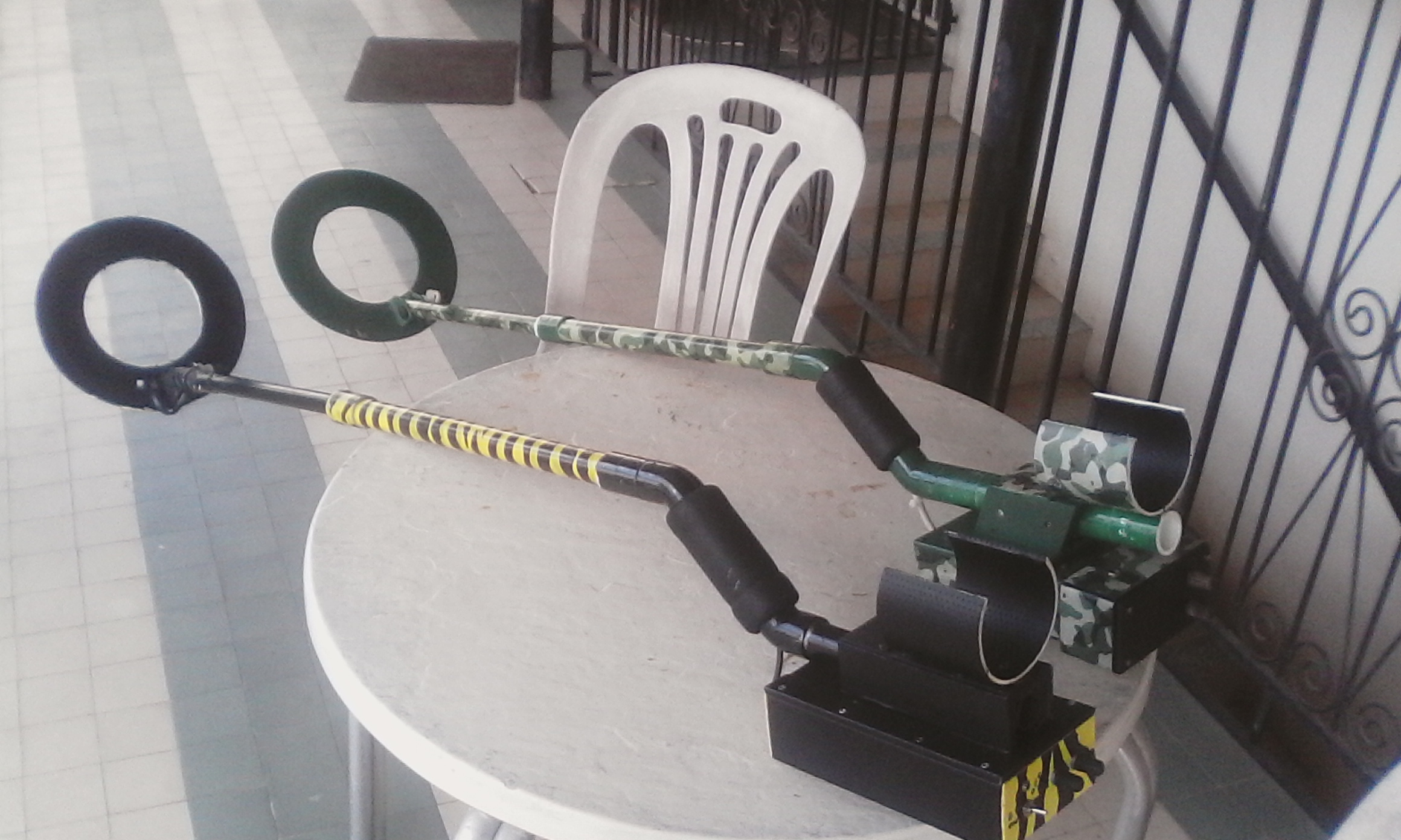

            • Wow! Very nice indeed. I have full version of proteus, diptrace and many others i downloaded from uloz.to but never had the time to tinker. I am electronics repair technician and this takes up most of my time. But I see you have been very busy developing your project. The thread maybe quiet but people are working. Here are my two home built detectors, a surf pi, and baracuda.

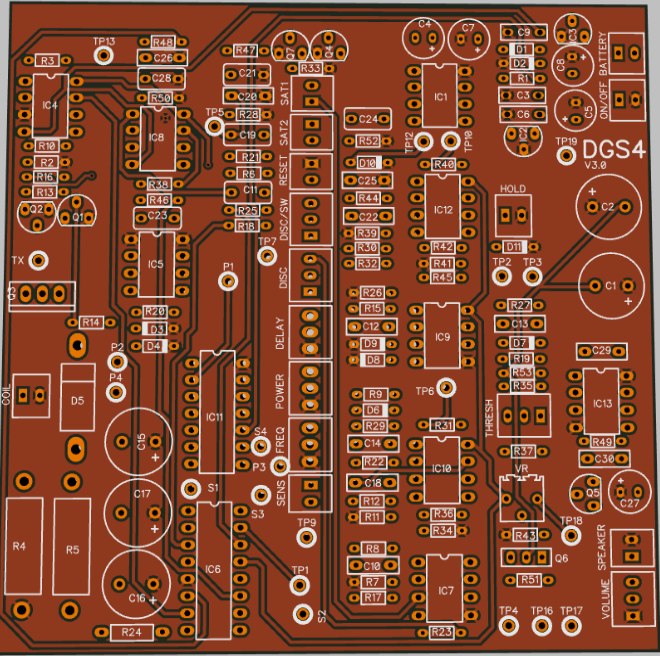

                I already had drawn GS4 when this topic was started, did the GS5 part after that.
                On a separate board I was working on SD2000 with MCU which I decided to move the design to GS5 as separate project so now I ended up with whole mix of board projects (8Bit cpu, 32 bit cpu, all analog design and that goes for GS4 and GS5) and it's hard to keep track which one is which - in total I've ordered 6 separate boards for the goldscan JUST because now there's huge discount from China PCB company with free DHL shipping

                    DHL just delivered first 3 batch, total turnaround 5 Days!

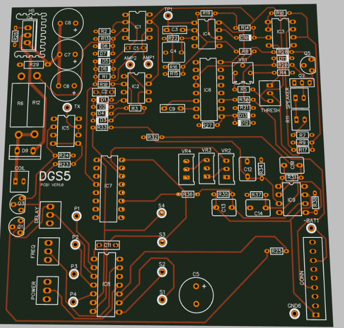

                          i started working on the audio section from original, but this is as far as i got. without better photos its impossible to complete. actually the audio section can be adapted as there are many solutions out there. The power supply is straightforward and easy.
                          Sorry for my English...
                          Everyone knows how to give suggestions, but specifically only for money.
                          We amateurs without schools or university professors are more of good will with the needy, so here is our homework.

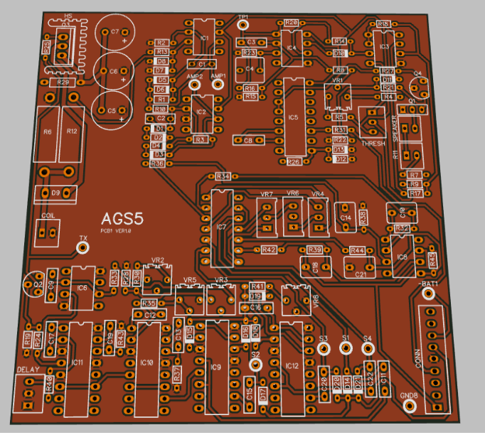

                          dbanner
                          I use sprint layout and plates overlap for lack of space
                          Here is what you started,
                          I continued,
                          I combined what I found and I hope to be ok..
