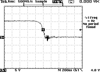

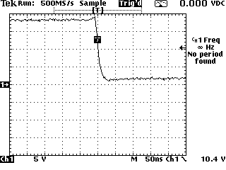

      Here are my camparisions
      minipulse (MPP) original driver
      MPP totem pole mod
      and last the driver from Lorenz Pulse 5 (very good driver)

        Yes, the Lorenz looks best but does it use a SAME MOSFET as the MMP?
        If not then more likely the faster Turn-off is a function of the MOSFET and not the gate driver.
        Please list Which MOSFET in Lorenz verse MMP.

                These are real bench tests, mosfet for Lorenz i have use are IRFP450(in the shematic IRFP460) , for MPP IRF740.
                turn-off is in this situation is a function of the driver , because IRFP450 has 2600p gate capacity, IFR740 has 1400p,
                lower capacity - faster (easier)turn-off

                    Ok,
                    IRF740- total Gate charge = 63nC
                    IRFP450- total gate charge = 150nC
                    So the Gate drive circuit makes a big difference.

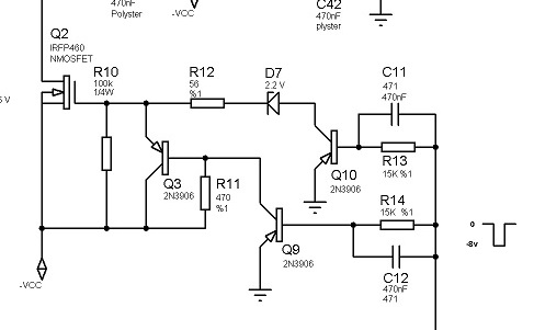

                      Here is a very good document for mosfet driver circuits explaining a lot of the technical stuff. The lorenz circuit appears to be just a pnp turnoff circuit with anti parallel diode on the gate drive.
                      there is a good discussion on bipolar totem driver circuits in the document.

                              I reed the document but still have question about three components
                              here is a pic of the drive
                              1_ the 470nF caps parallel with the 15k resistors
                              does it help with the ton/toff time of the BJTs and if, how?
                              and it's 1nF in TDI schematic what's the difference ?
                              2_ the anti-parallel diode
                              which apparently protects the base-emitter junction of Q3 against reverse breakdown at the beginning of the turnonprocedure but why a 2.2V Zener ?
                              3_ R10 the 100k parallel with Gate and source
                              is it for some sort of protection or stops turn off ringing without compromising the actual turn off time ?
