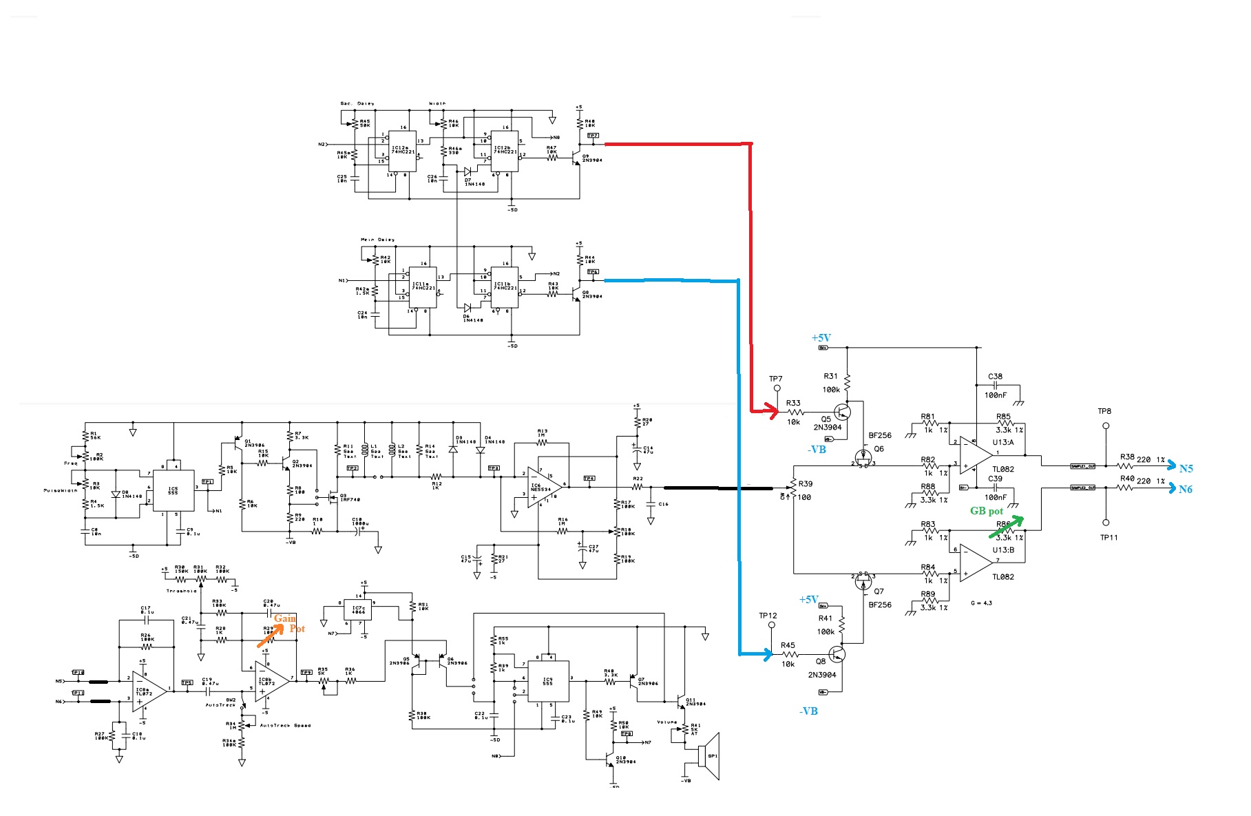

                        Please see attached, i added GB and Gain control (from Mr. Walter schematic) to HH1 Rev. D. Can you tell me your opinion?

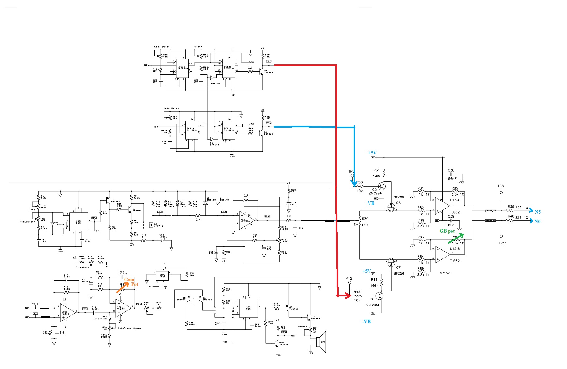

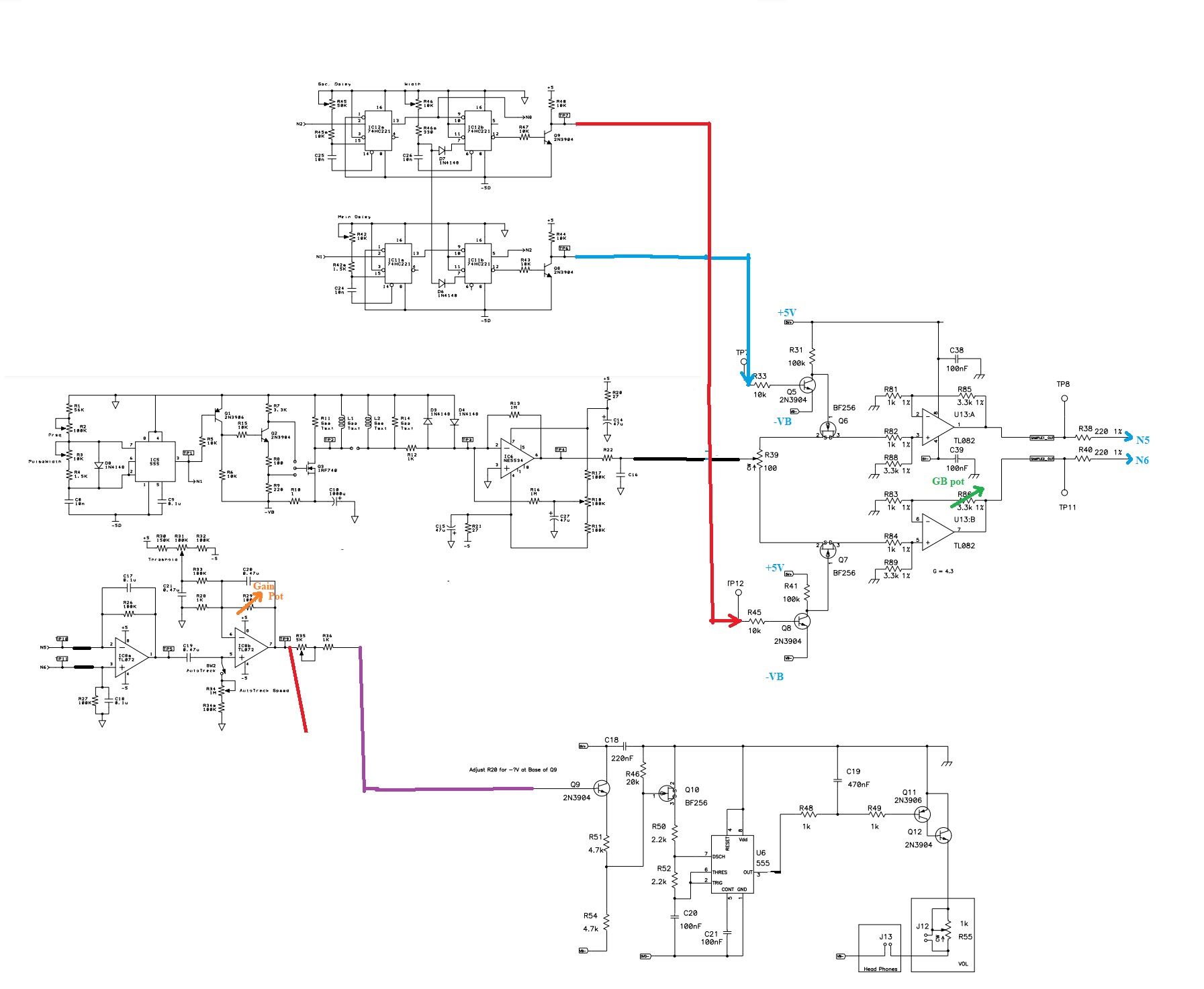

                          • Sorry, I edited schematic, Audio part.

                              Not sure if that will work. One sampling switch is for target sampling the other is for EFE.
                              That is not what I did to add GEB.

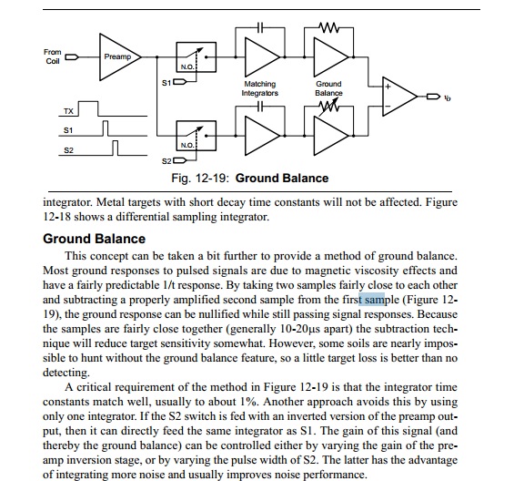

                              • Thanks dear Walter.
                                I tried to follow Carl's book method (attached). I think its method only uses two samples, target and EFE
